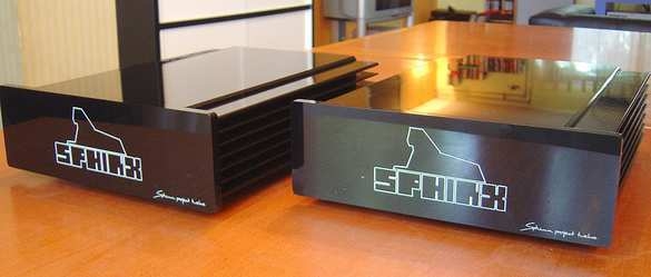

I take it the signal to the differential was from the output of the OPA627, not from the supply lines of the chip as Sphinx amplifiers did overhere ?
(AD opamp-6 Hitachi Mosfets)
(striking that the Siltech boys did acrylic fronts on their amps too in those same years)

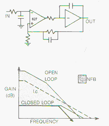

The design format is shown attached and has since been patented by someone else (US patent 6201442) six years after it was published in my product design paper in Australian Hi Fi and presumably copyright.
Regarding appearance, the original product (GB1b) was in 1989 and used an LF357 and it's appearance was, at best functional, having the same mesh front as the top. I added the acrylic faceplate at the same time the OPA627 was released, my wife and I auditioned it and had to include it! I don't know of Siltech - what is that? I had reworked a few Meridian DACs that had shiny fronts though. I tried the supply line chip feed but I could never get it to sound any good.

Hi Amp guru,
looking at your last post & gain plot.
Can you explain how you determine suitable values for the local feedback cap around the power amp and then the parallel cap in the global feedback path.
Can you also explain the gain plot at the hi freq end where the slope changes from 12db back to 6db/oct. Is this the global cap working for you? Is this necessary to ensure overall stability where slope <9db/oct as it crosses the 0 db gain?
Hi Andrew,
excellent questions!
Here goes.
The discrete section was seperately stabilised so it was UGS - using equal input and feedback R's and sq wave test trimmed with diffl emitter resistors so no Vas comp was needed. Once this was done a feedback C was selected such that the discrete FB loop gain permitted full output -3dB at 100KHz from maximum chip drive i.e. +/- 13V at the discrete input resistor. Values were, I think, 4K7 and 150pF.
Then the main loop was closed around the chip and output stage using a FB rolloff at 160KHz (27K//33pF) and the same as the input filter (1K//1000pF). Thus there was a 12dB /octave filtering at HF. The input/output transfer function rolled off at 6dB/octave faster than the internal loop.
As you see with the FB loop rolloff (6dB /octave) and open loop rolloff (12dB/octave) they cross at approx 6 dB above the feedback zero caused by the input leg R and the feedback C (1K, 33pF). The whole arrangement is a 2pole nested loop satisfying nyquist requirement of closing (relative) at 6dB/octave with an extra 22degrees margin from the FB zero. A 15 turn on 1ohm 1W zobel was used and stability was exemplary. I may have included an inner loop FB zero stopper R of about 150R.
Follow that?
It doesn't cross 0dB gain - the two intersect before that.
Greg
