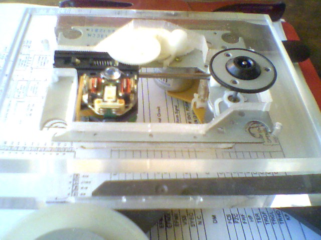

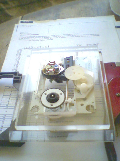

I became to transform the KSM of a rotel in top-loader with acrylic base ,it sounds good with a 1543 .
Here is the first step :
now i will machine a larger base (about 420x230mm) , and i'll hook the motherboard on .

Filled the hollow spaces of disc clamp from CDM-2 with a mixture of polyvinylcellulose (woodglue) and sharp bird-cage sand, just like Focal: they fill their woofercones with tiny glass balls to reduce resonances. You have to fill the spaces a few times and let it dry, the woodglue crimpes every time when drying, and the sand sinks a little to the bottom of hollow spaces. After drying cut off too much glue/sand with sharp knive. Before procedure grind off the hollow spaces for good adhesion. After last gluelayer: a layer of matt black paint on it to adhese some loose sands. When ticking on the clamp it has now a really "dry" and a fast decay of sound, and therefore much better dampened!
Cheap diy and simple mod with good result.
