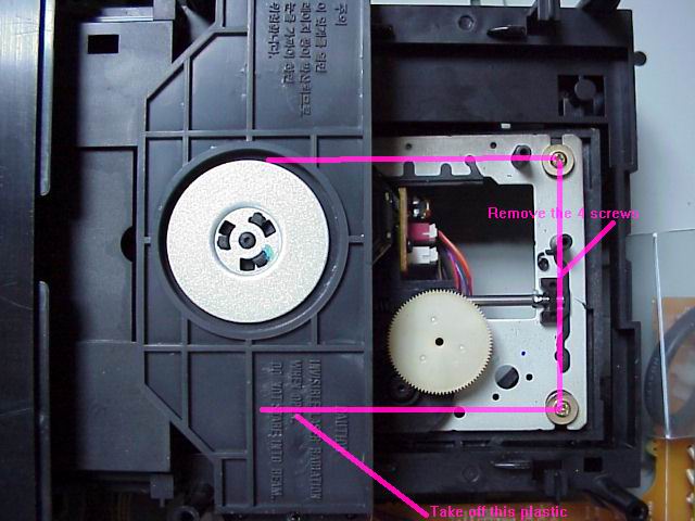

OK, I've got an example here of a KSS210. Not exactly the same but you'll get the picture.
Remove the plastic on top of the transport. It could be tightened with two or four screws or clipped in.
Remove the 4 screws that hold the laser unit plateau.
Take care of the springs underneath the platter, they are sometimes different in strength, make sure you put them back in their original location.
Now remove the white plastic wheel that is clipped into the plastic. Do this by pinching the clips underneath with tweezers and pull the wheel.
/Hugo :)

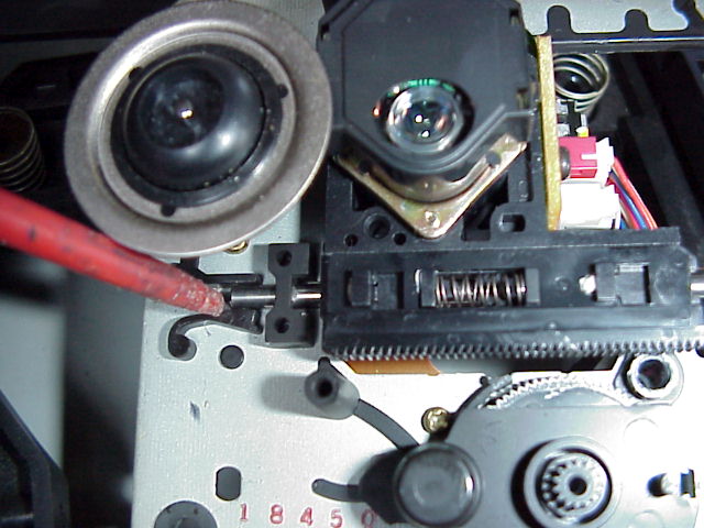

Take good care of the white flex cable, pull it gently out of the laser unit. (Not on my picture, the 210 has normal wires.)
With a small tool, clip the little plastic away so the axe can be pulled out a bit. The trick is to take out the axe completely and ones this is done the laser unit is disassembled.

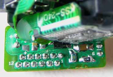

There's no solder bridge, and no metal strip on the ribbon cable, at least not on the basic laser unit I was trying to fit. The job is done, problems solved, once again thanks to your help here. Actually easier even than netlist suggested as the 4 screws and springs don't need to be removed, nor the wheel; just slide out the axle, disconnect the small ribbon cable and bung in the new one, takes about 5 mins.
