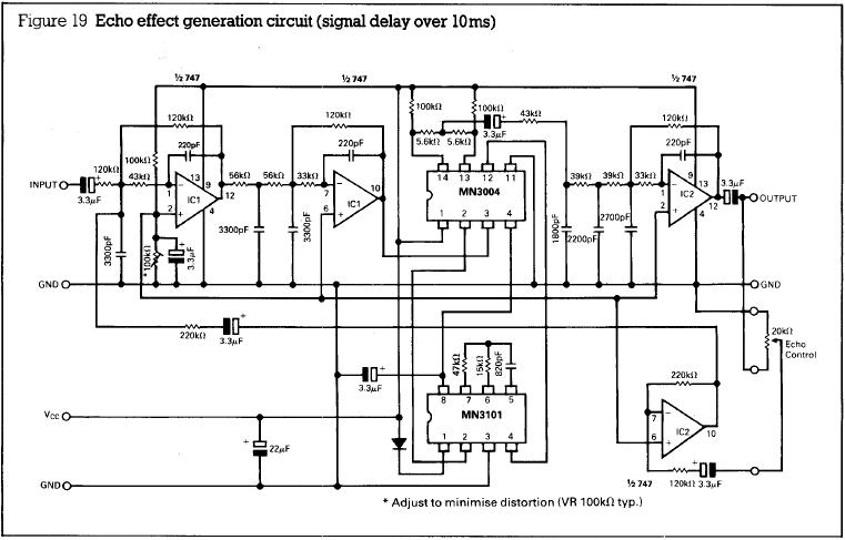

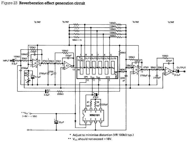

hey everyone,
Ever worked with or used panasonic's bucketbrigade delay lines IC's for producing the effects such as stereo imaging , reverb, echo, chorus etc.
Attached are some of the schematics of using these IC's.
please comment if any body knows about them.

If only you could find the chips. They've been discontinued long ago, and the guitar effects guys are desperately searching for last ones, paying even hunderd of bucks on ebay auctions.
If you could find some, you'll be rich...
Btw their sound is not good for hi-fi audio, they are somewhat slow, resulting in a noticeable high-frequency loss. Because of their warm sound, they're enjoyedc very much from guitar players... :D
Philips once had a chip called TDA1022 - a bucket brigade delay line. I considered using it for a hifi ambience setup, but I discovered, that there are limitations in the upper frequency. The upper limit is a function of the wanted delay, which is determined by the clock frequency. So I abandoned the idea.

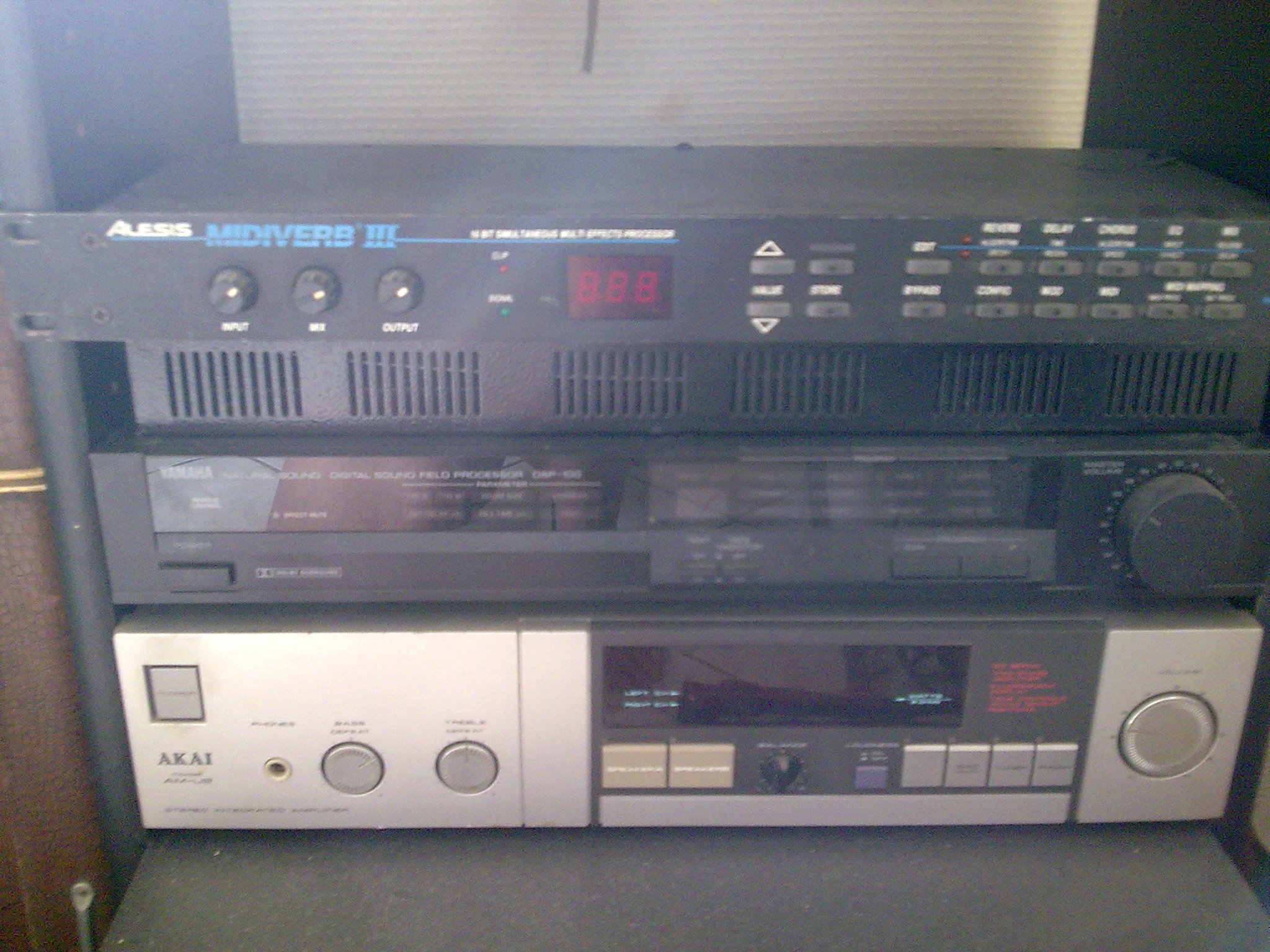

If my (BBD?) memory is good, there was also a cut down version SAD5XX.
Very good chip, but quite expensive at the time.
As for such a build, it s somewhat more expensive that buying and
old digital verb dating from the 80s/90s.
An Alesis Midiverb 1, 2 or 3 should cost less and provide hifi sound.
Heck, i even managed to find a Yamaha DSP100 for about 10 euros...
