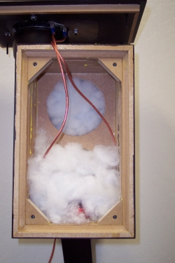

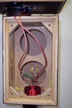

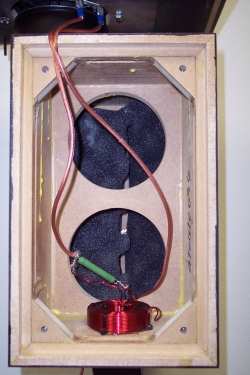

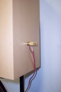

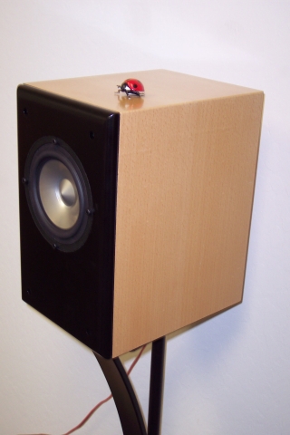

I bought a pair of boxes from Parts Express. http://www.partsexpress.com/pe/pshow...=302-704&DID=7 They are billed as .25ft^3, but the small prints says they are really .3ft^3. No matter. I used the recommended BSC circuit comprising a 3.9 Ohm resistor and a 1.5mH coil. At first I thought it was a bit much, but after moving the sub about a bit, it's fine. I glued the coil to the bottom of the cabinet in the front section using Goop (tm) goop. It's not going anywhere. I put open-cell acoustic foam on the back wall, and filled the boxes loosely with poly fiber from the crafts store.
I had to enlarge the holes in the back of the cabinet to accommodate the binding posts I used. Here's something I learned about drilling holes through veneer: Scribe a circle where the perimeter of the new hole will be with an exacto knife, then put tape around it. The idea is to try to prevent the veneer from chipping. I did okay.

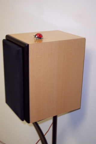

A friend who owns a high-tech machine shop cut the speaker openings for me. I forgot to tell him where to position the bolt holes, and he put them on the top, bottom, and sides. The bolts interfere with the decorative grills. The bolt holes should be rotated 45 degrees.
I don't think I'll use the grills anyway. In order to put the grills on so they'll hold, you have to push some press fit sleeves into the attachment holes on the front baffle. It doesn't look like they would be easy to remove if, for some reason, I wanted to remove the baffle.
For cosmetic reasons, or maybe because I couldn't think of anything else, the center of the driver is positioned at the golden ratio on the front.
The mains are crossed over to a sub at 80Hz. It's made with a Peerless 10" XLS driver and passive radiator in a box that's slightly under 1ft^3. I also have it running through a Richter Scale which provides some EQ for room modes and a steeper rolloff on the lowpass filter than the plate amp on the sub provides. It's the same sub that was described in the thread about the Locust I.

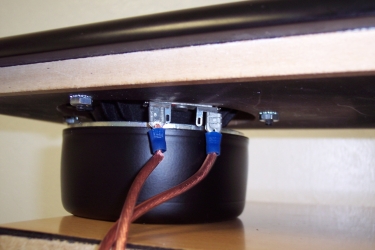

knorke 13th March 2005 08:29 AM
Hi Dave,
nice work...
I've seen on your last picture that you used those plugs
that are used in car electrics to connect the Jordans.
I recommend that you solder the wire to the jordans,
those plugs will get loose with time and sound quality
will decrease....
I often refurbish speakers, the first thing I look after
is if all connections are soldered. It makes a big
difference...

Dave Jones 14th March 2005 03:24 AM
Quote:
Originally posted by knorke
Hi Dave,
nice work...
will decrease....
difference...
I thought about that. I tried to solder the connectors, but the solder wouldn't flow. I need some flux, I guess. Maybe I'll buy some gold plated connectors.
