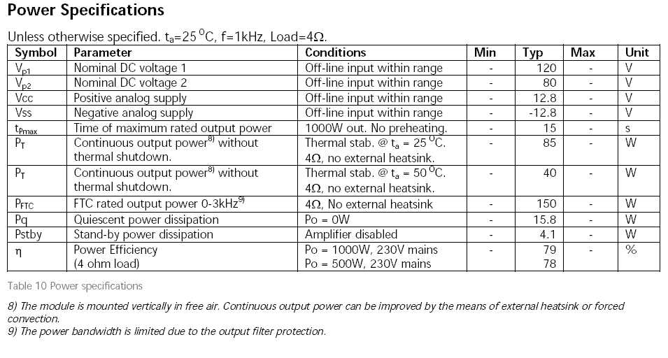

I am a bit curious about real power capability of those modules without additional heatsinking. In SMPS business I am accustomed that 1000W power supply gives 1000W continously up to the maximum rated ambient temperature. Now 1000W power supply that gives out 40W at maximum ambient temperature is in my book a 40W power supply and not a 1000W one. See attached part of 1000ASP module data sheet.
I know that FTC has now lowered preconditioning from 1/3 rated power to 1/8 rated power and I think that rated power is tested for 5minutes, but i would like to have your opinion what is a realistic continious power requirement for audio SMPS.
Best regards,
Jaka Racman
