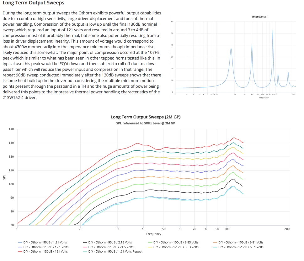

Ah - I’m confused in that case.
Because the shape of the response in the acoustic power window does change when you adjust the max wattage and displacement parameters. And you can work this feature with only those two options engaged.
What is actually happening then?
Ah yes that’s what I was thinking.
So I’m guessing hornresp assumes an infinitely hard and stiff pathway, with no crosstalk between the neighbouring folds?
And plywood will tend to absorb certain frequencies, as if said infinitely stiff pathway already had some absorbent material applied.
The "maximum SPL" feature simply is giving an idea of whether the response is reaching the power or displacement limit you have set by frequency.
In real life, the shape of the response won't respond like that.
Josh Ricci has been kind enough to provide insight as to how response changes when pushed with voltage levels that exceed "normal" operating levels for a wide variety of low frequency enclosures:
Data-Bass: Subwoofer Measurements
You could use the Hornresp inputs provided in his thread:
The Othorn tapped horn
and compare them to the actual measured response on his site to see the differences.
Attached is the Othorn response from 2 volts (4 "watts" @ 4 ohms) to 121 volts (3660 watts @ 4 Ohms) measured at 2 meters, ground plane.

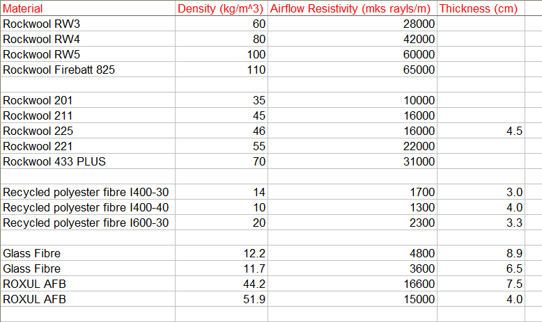

Can I ask-
I'm trying to figure out how much stuffing is being applied in the simulation?
At the moment I have it on '2200'. There are no units as far as I can see.
In particular, is this an acheivable level of stuffing in the real world?
Weight is shown for densities < 1000, the rest you will have to calculate. Here's a re-post of reference values David posted in his thread:
