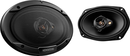

How would I go about finding replacement foam for the woofer? They are Jensen 6x9 triaxials from the early 80's. While yes, I could get a drop in replacement...they are period correct for my 1981 toyota, and the people who installed them even signed the back of the body card! (will have to get a pic of it~). I think the speaker and tweeter suspension is fine, though I'll have to take mine out and inspect further.
This is a generic pic of them. I need to get the grills off mine.

That mid-tweet bridge is neato. And very period-correct. Pop it off and onto one of JBL's(?) over-size 6x9 2-ways. Whatever I put in my 2001 Honda really does have more clean bass than most 6x9s and was not expensive. I considered a 10" sub in the ski-pass but never felt I needed one.

If these speakers actually cost more than the foam surrounds do, and if they were just raw 6x9 speakers, than go for it - what would you have to lose? But there are two things to carefully consider, and everyone was trying to warn you of. 1. The value of the speaker is likely less than the cost of the repair kit. You have to ask yourself if it’s worth the twenty bucks - if you sent it to a shop it would be 60. 2. Getting that tweeter bridge off so you can shim the VC is not going to be as easy as you think. Can you even get it off in one piece? I’ve never been able to - at least not without making the tweeter assembly worthless in the process. Try to get the tweeter bridge off first, before buying the repair kit. Don’t do this step backwards. If you bugger it up, it will save you the twenty bucks, and you can put it toward a new speaker.
