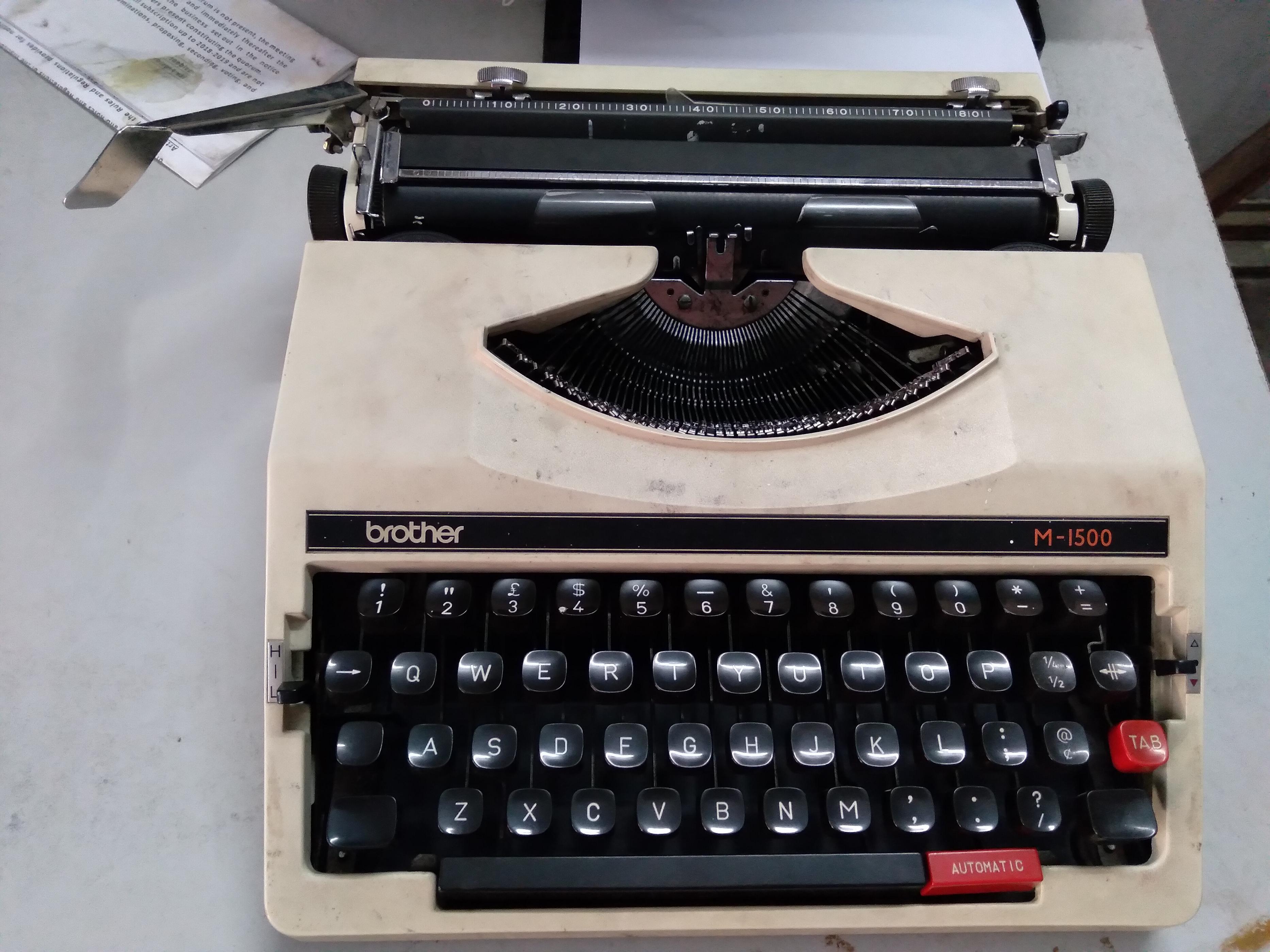

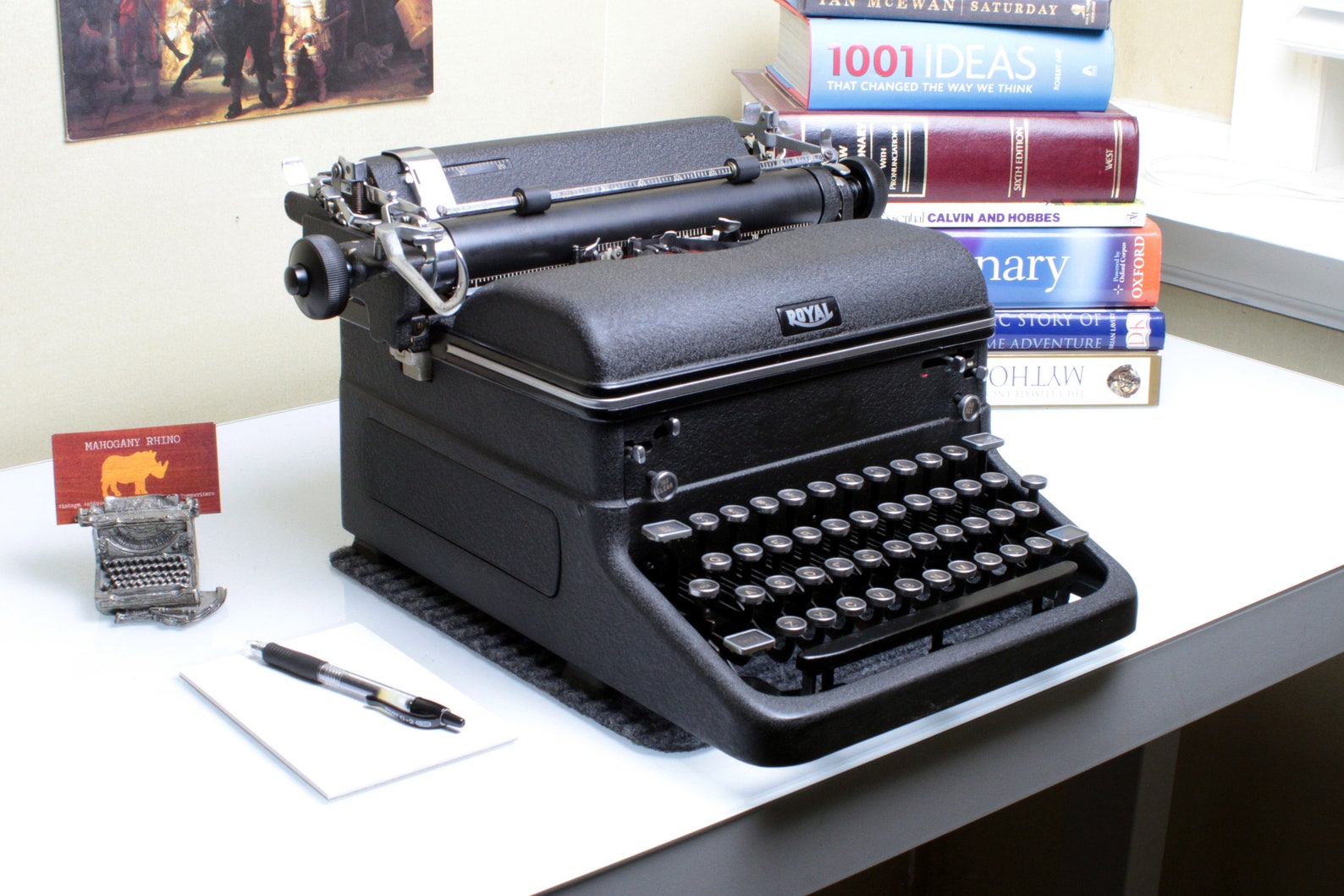

This...
I think his question was ironic...
I have 2 electronic daisy wheel units too, Brother also.
All work.
That appears to be a really old Royal, some of them had the ribbon spools at the sides, later they went next to the type basket. The tab bar appeared later. Well preserved.
I have seen those thick pads, a substitute later was coir mattress foam.
Most typewriters have gone for scrap, I got mine for $4 at the flea market here.
