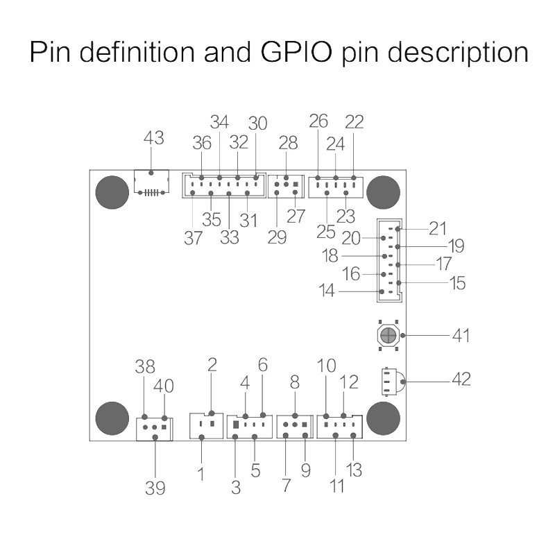

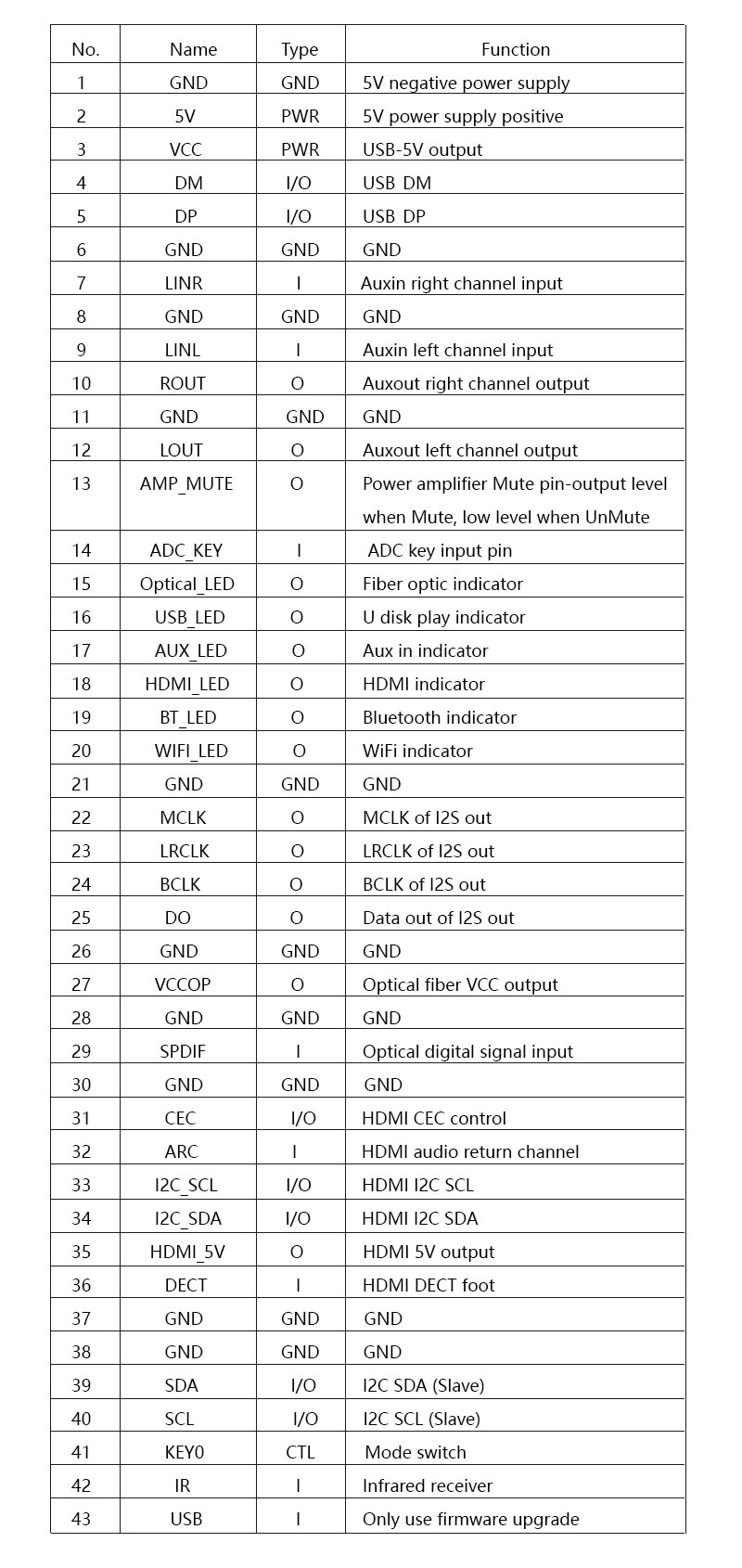

I need your help if you can , i am doing a whole house audio in the cheapest way possible about 16 zones , i want to buy this Diy board
WIFI Bluetooth 5.0 Audio Receiver DIY Smart Adapter Board Module with AirPlay DLNA Multiroom HDMI ARC Optical AUX USB I2S|Wireless Adapter| - AliExpress
And i need to Conection to it as follows:
1 - optical input ( from tv )
2 - aux in ( from any device )
3 - aux out ( to amp )
4 - usb input ( audio source )
5 - volume , source select , source playing indication, mute , in shot term control of the board from nextion touch screen 7” to be mounted on the wall connected to the whole house through ESP32 with home assistance.
I really appreciate if you can help me , i have zero experience in all of this .
