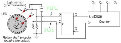

LBHajdu 6th July 2004 02:45 AM
2 Attachment(s)
For some reason I just donít like programming microcontrollers and I happen to be a professional java programmer working in a government nuclear high energy physics laboratory. I for one donít have the equipment, and have never done it before.
I think an optical encoder hooked up to a flip-flop and an 8 bit up down counter like the 74f269 would work just as well. I canít find an example of a full circuit online. However it would be something what you see below (just two chips).
By the way, do you get a good range out of that volume control? That is to say, does it go from dead silent to loud in nice uniform steps? How much noise do you get out of that thing when you change the volume (mechanical / electrical)?
By the way maybe Nelson can tell us how to make a better volume control, using transistors instead of relays. I know he knows how .

Nelson Pass 6th July 2004 07:46 PM
Quote:
I think the encoder and flip flop is an excellent way to go.

xcel 9th July 2004 10:36 AM
I have used the encoder and the 8 bit counter and it works like a charm !! Simple and reliable, no software hassle.
I designed the relayboards and a separate board for the control circuitry. It uses 6 relays which activate banks of resistors (1 % MF). The impedance is a constant 10k, regardless of the volumesetting.
Sound; rocksolid imaging regardless of volume setting (try that with a regular pot), channeltracking is as perfect as it gets (my Audio Precision measured a maximum tracking error of 0.01 dB), and this thing has a purity of sound that's addictive.
I built this thing about 6 years ago and I've never looked at conventional pots again. Tried to make it more luxurious with a microcontroller, but that's a projetc that's still waiting to be finished. I did design the boards and wrote the software though.
Xcel
