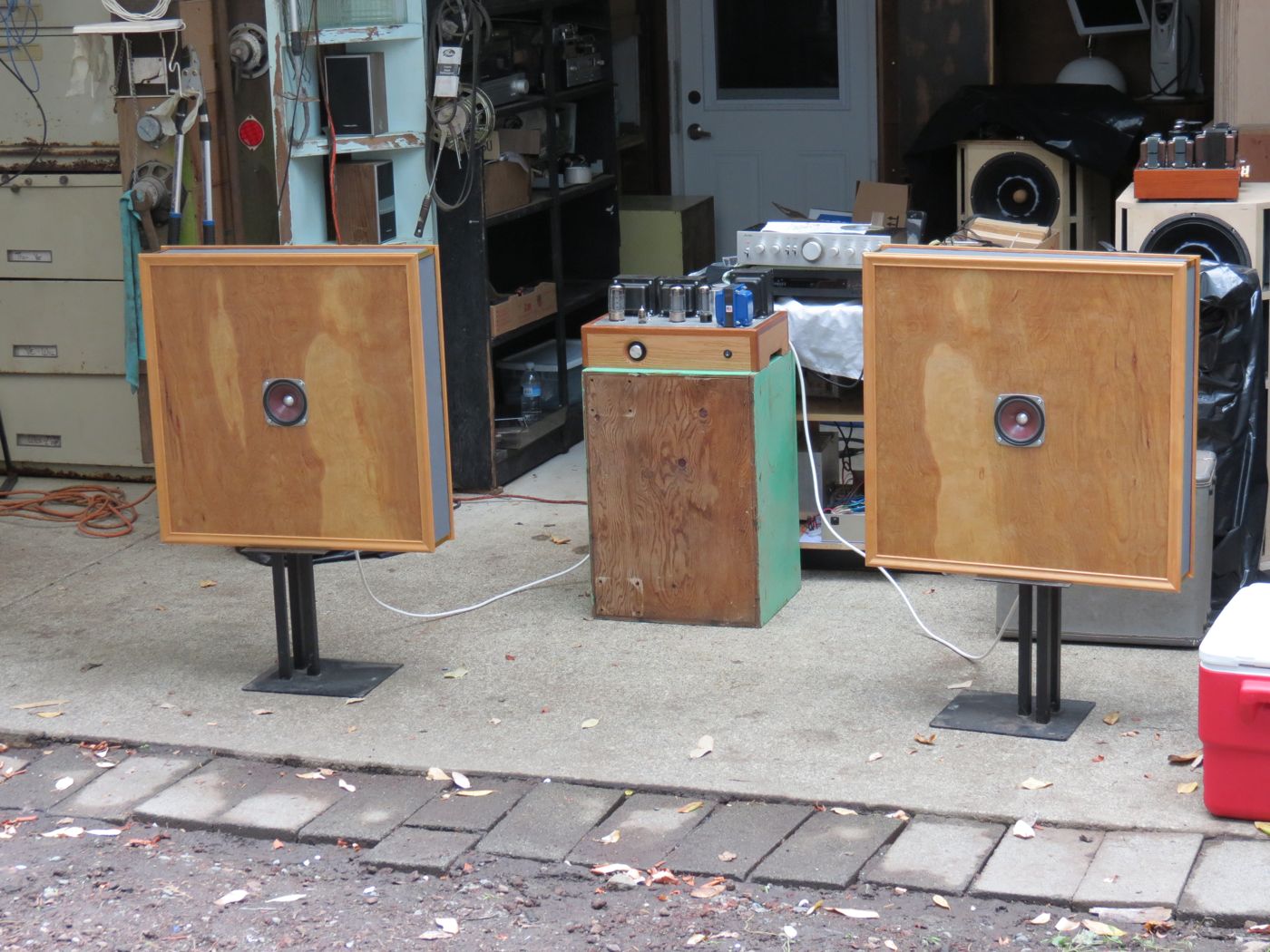

xrk971 13th April 2021 10:12 PM
Cornu spiral horn has the largest expansion ratio for a BLH. Hence most bass-bang for the buck. Most of the time people have to attenuate the bass with stuffing in order to balance with the mids and highs.
Cornu with 4in driver is basically a 28in x 28in x 5.5in deep “pizza box”. As PJN said, they can be covered with printed cloth and hung in a wall like artwork. Very easy to get past the significant other without dominating floor space.
The bass is wide deep and surprisingly powerful.
Each driver is connected to 4 radially expanding spiral horns:
https://www.diyaudio.com/forums/atta...n-img_0721-jpg
