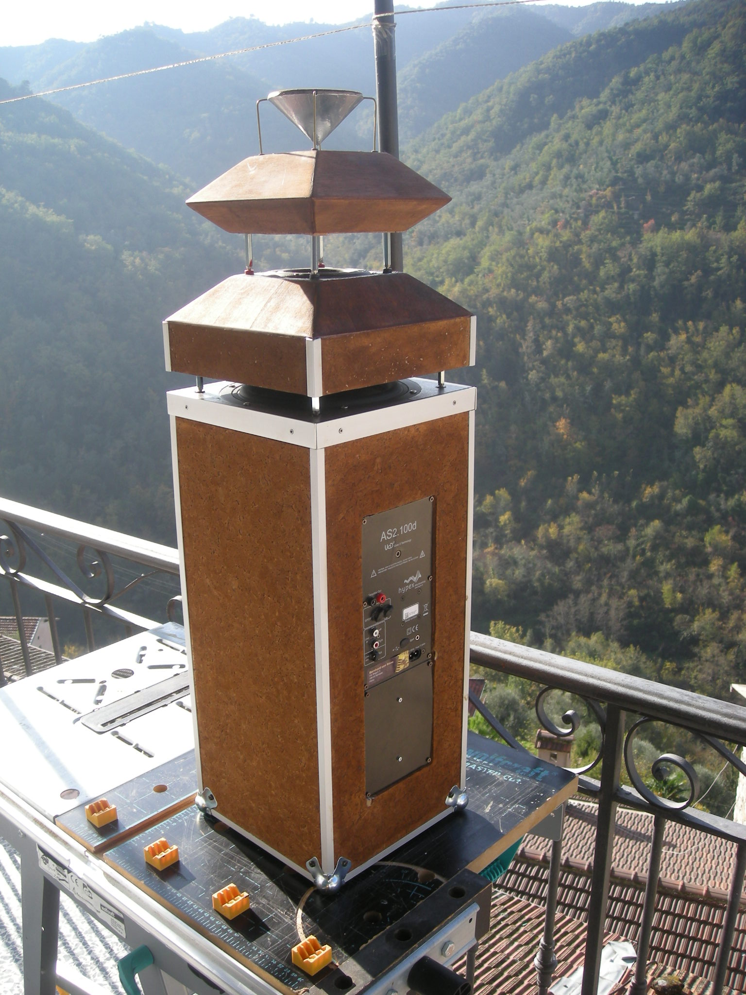

Hi. I CAN HAZ CRITIQ PLZ?
I have a large vaulted room. 19x40 with a vaulted ceiling reaching 15' at the peak. Due to WAF, I'm working with specific locations in the room where speakers can go. I have some Klipsch Cornwall I's in my room corners. My personal listening habits have me all over the room and I really don't spend much time in my Cornwalls' sweet spot. Omnidirectional speakers (or more accurately, radial speakers) are said to have a very large sweet spot. There are not very many available and they tend to be very expensive, especially for the larger models that would go well in my large space. So, DIY it is. I decided to build a very basic/inexpensive pair of omnis to get a little bit of an idea of how omnis could work in the room. I mounted Visaton BG20 full range drivers on top of a 30 liter sealed baltic birch box with 45 deg dispersion cones above. The driver spec sheet said fc 82 Hz QTC 0,96 so I figured I'd fill in below 80 Hz with My Hsu Subwoofer. I chose a sealed design because the ported spec is 50 liters.
Well, they sound a bit like toy speakers. Really very small. There seems to be a distinct lack of low-mid frequencies before the sub fills in. At the same time, I can tell that they have promise. If I can find the right driver(s) and the right cabinet construction, omnis really could work in the space. See pics. They're far away from the walls and have two large sweet areas on either side of the pair, which is perfect for the room.
I'm not sure how well executed these speakers are. They're my first. I'm wondering if the lack of low-mid frequencies comes from over-bracing them? Maybe the holes I put in the braces weren't large enough? Maybe I over-stuffed with sound attenuation material? See pics.
I think some marginal improvements might be had by rounding off the edges and sinking the speaker flange to make the top of the cone flush with the top of the cabinet. I could also do the same with the support rails along the edges of the cabinet top -- sink them down to make them flush as well.
Anyhoo, I need to decide whether to proceed with this experiment by getting some better drivers, and building a speaker that is more suited to the room. I'm assuming that would be a larger one. I like the idea of a full range speaker with a horn coming out the bottom. It seems very elegant, but I'm not opposed to a 2-way design with, say a tweeter on top of the cone with another mini cone on top of that like Morrison Audio or Duevel speakers and I could do an active crossover on my MiniDSP 2x4HD. I could even bi amp them to add to the fun.
So, what do you think? Some Lii Audio Drivers? Fostex? Lowther? A Voigt pipe of some kind? A folded horn? A straight one? Forget the whole thing and just use my Cornwalls?
Thanks for your critique!
In case you are wondering, the pig is a javelina.
Most of the things you describe as possible changes to the current enclosure would make minor differences at best. Over bracing isn't really possible, as long as you leave enough net volume in the enclosure. The holes in your braces look like their total area is similar to the driver, so that shouldn't be a problem. Stuffing doesn't look excessive. Flush mounting and rounding are going to affect higher frequencies, so not relevant to your biggest complaint.
In my experience, without some kind of EQ/crossover it's tough to get adequate bass from sealed enclosures with many 8-inch drivers on their own (unless you're dealing with something designed as a subwoofer). Two 8's are better, but still not great. The one you're dealing with looks like it has some inherent roll-off at lower frequencies and a pretty significant boost at higher frequencies.
Depending on where you want your sub to come in, a single 8 may be OK as a basic design goal though.
One thing you didn't suggest is equalizing the current setup with the miniDSP. Your driver doesn't have much Xmax available, so it'll run out of gas at higher levels, but equalizing them should make them tolerable so you can get a better feel for the dispersion and general performance of the idea.
1. You might be right with creating Helmholtz resonators with your bracing. cut out the middle part and just leave the frame.
2. Without a proper x-over there will be strong interferences with the sub. with the high Q-factor a 2nd order high-pass of 80Hz with Q=0.5 will create a Linkwitz Riley 4th order, you will need the same for the sub as lowpass.
3. You also need a L|C|R (all parallel) to suppress frequencies between 1000Hz and maybe 5000Hz depending on the quality of your reflector.
Since you are not yet familiar designing Xovers, try first to measure impedances and when you have a mike also SPL. Maybe someone can help from the group

Another parameter that can be changed is the shape of the dispersion cone. I chose a 45 Degree cone for ease of fabrication and I thought that the reflections would be more versatile -- to work when people are standing or sitting. The other designs I have seen are parabolic and hemispheric. They're a bit difficult to fabricate, but I could do them and swap them out. I also matched the diameter of the driver, which I'm not sure about either. There are so many parameters!!

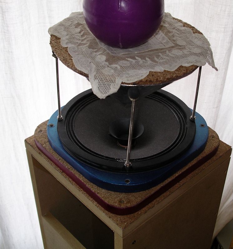

Cool project! Removing the foam ring and make a flush top will make the sound much smoother in the important 2-5kHz range. It will be easy to see the improvements in REW etc. I think your going to see 2-4db ripples with your current design so a flush driver would really be worth it!
This is probably why it sounds thin. Dispersion is still straight up. You need a wave guide. Basically a circular exponential horn. If you made it out of heavy cardboard you could compress it incrementally til you find best response. Then use that as a template.Another parameter that can be changed is the shape of the dispersion cone.
You mention that a single 8 may be OK. Would a larger full range be better or are you suggesting that it'd be better not to use a full range speaker?.
My comment about the single 8" was primarily about the sealed enclosure, no equalization, no sub, and wanting higher frequency coverage. A ported enclosure, transmission line, etc. would help to boost the bottom end and should reduce excursion requirements, but adds design complexity and the potential for poor sound if not done well. Obviously a subwoofer changes the demands made on the primary speakers also.
Full-range drivers can be a little tricky. Most of the ones I've tried have needed some EQ help to sound right. I think sticking to the minimum size you can get away with is advisable. In an omnidirectional design, even more so. Larger full-range drivers of good quality tend to be pretty expensive also.
A lot of it comes down to exactly what you want your speaker to do and how particular you are about various performance aspects. If you only need to get down to 80-100 Hz with the primary speaker and you aren't looking for ear shattering output, that makes things a lot easier. Handing off to another speaker that is designed for bass obviously adds its own complications, but gives you a lot more flexibility on the "full range" driver.
All of which gets us back to EQing the current speakers. If you do that and they make you reasonably happy, it gives you a pretty good starting point for refinement. As you said earlier, there are a zillion decisions and changes that can be made, but without some measurements and basic frequency adjustments to what you have done already, it's difficult to decide what's useful.
What are the cones made of? They should be hard, smooth, and reflective.
Wouldn't a parabolic shaped cone basically create a circular exponential horn?

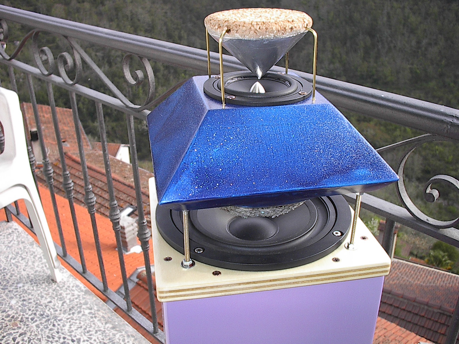

From looking at it, i would expect the issue could be th eshape of the deflector. The ones i have seen have tyically been curved, and often with a helper tweeter.
