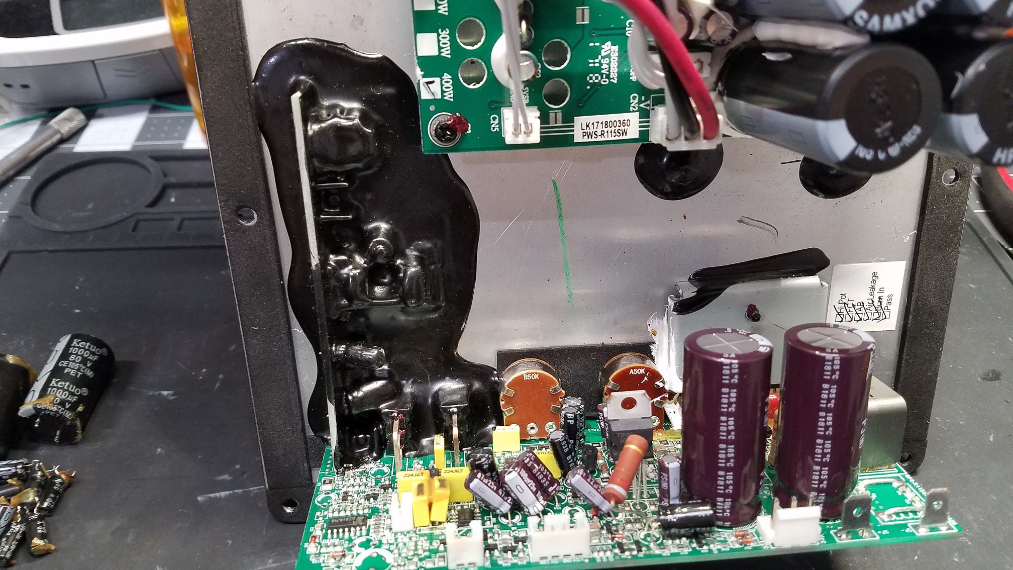

Oh , how the unclean public is now raked over the coals with utter solid state garbage.
My beloved POLK 10" sub failed after 2 years. (below 1) is the AMP. I laughed (and cursed)
when I saw IT (below 1). What a POS !!!~ 100W amp my ar$e !! No wonder it failed.
Design seems to be an op-amp driving a high beta to-220 EF2 , how nice of POLK to outsource
to cost cutting cheap manufacturers.

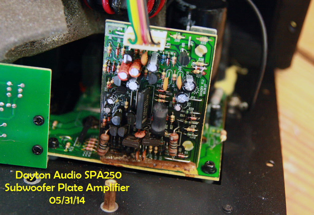

Rant # 2 - I bought a dayton sub 100 (10") for 20$ , which I knew was at least slightly defective.
It worked for 2 hours. (below 2) is it's amp. It is 2010 , at least they used TIP35/36 and REAL class
AB (simple complimentary IPS). This subs flaws were the "good cheers" 50VA trafo and leaky unknown
electolytics , "jacek"?? Why have a decent amp with a sub par power supply ??
Both subs have things in common.
- Bare minimum power supply with dubious capacitors.
- Using the amp plate as the heat sink and designing a integrated electronic
thermal shutdown into the control circuitry. I suppose it is easier to
use a few chips instead of a pound of aluminum for a proper heatsink.
- Ratings and use factoring are in the realm of "puffery". The units
can not handle normal use - let alone abuse !! They are definitly designed
to hit the local landfill in 2-3 years. AS IS most of what you buy these
days. I understand this , buy a sub every 3 years ... as you do your PC.

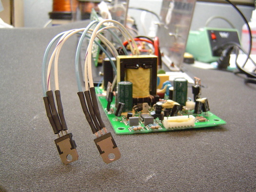

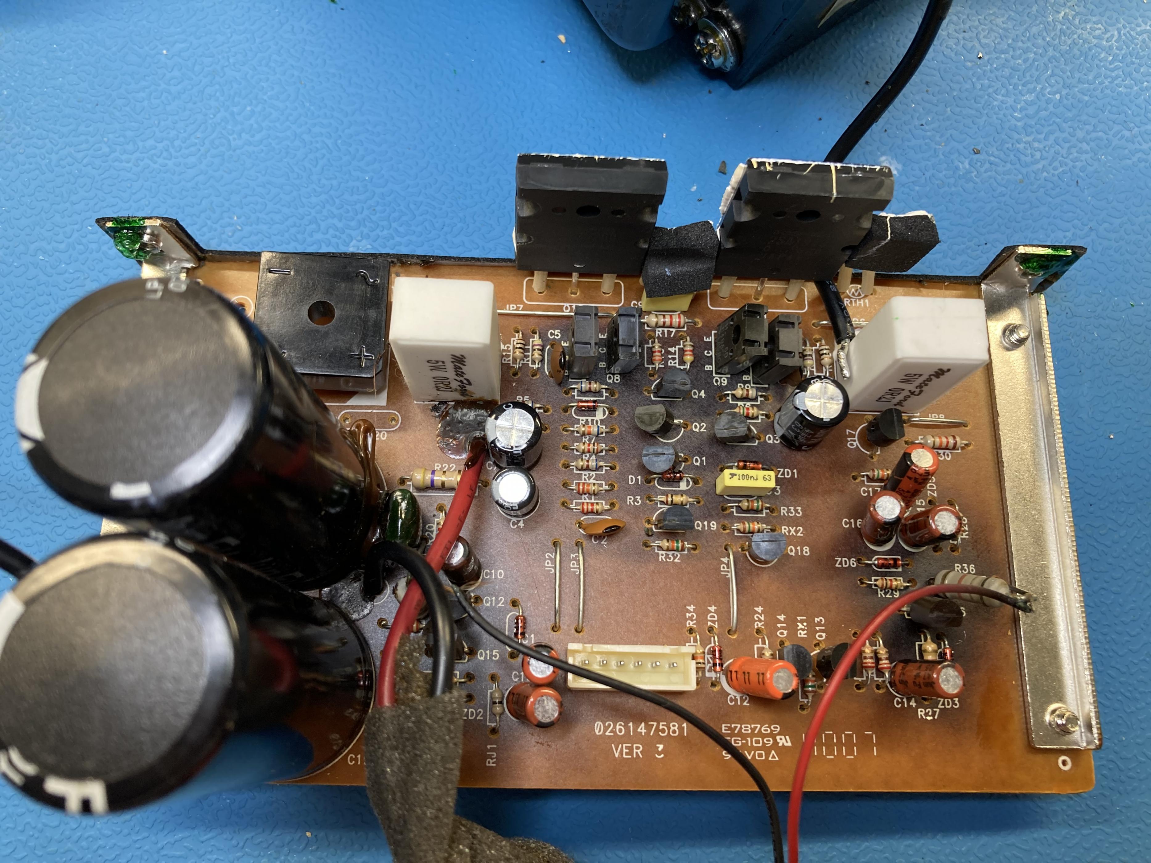

This is why I DIY. I found AMPS for 14$ on EBAY - Harbinger AP12's and 15's
have nice a "blameless" layout , simple/compact onboard amps.
(below 3) is what I got (link) Harbinger APS15 200W Power Amplifier PCB Board, NEW | eBay

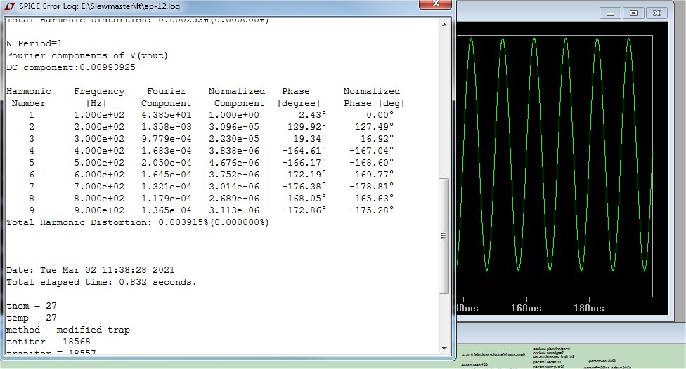

Not a bad deal. I reverse engineered the Harbinger circuit.
The last two attachments are the amp and it's 20- 150hz response.
There are so many blown 10 -12" OEM subs out there , why not design
a simple blameless type circuit to be a drop-in replacement. The Harbinger
circuit , by the reviews of the other buyers of this (replacement) amp .... seems to last
20-25 years with road musicians .

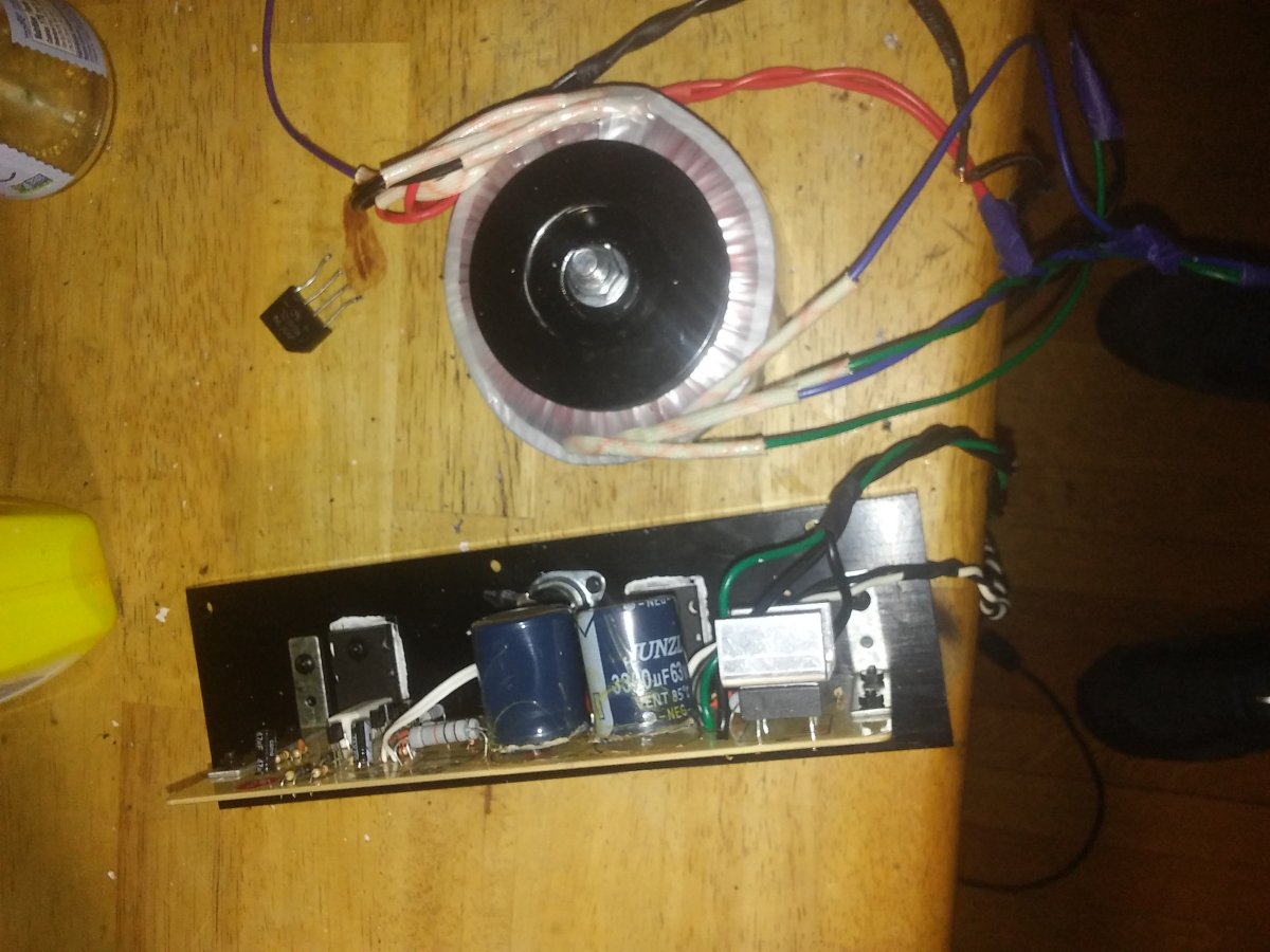

I had a "brainfart" and hooked the trafo (below) wrong on one of
the Harbinger amps. I was going to recap these 2 amps anyway.
What I did is hook the trafo center tap to one of the AC inputs on the
bridge rectifier. I was testing for the +/- 55V - nothing !! All of a sudden
Both rail caps let out room filling smoke.
Electolytic "goo" spewed out all over the board and the 200VA Antek
trafo became warm.
I swapped the caps out from the other amp and this unit still worked !!!
So , here I did a full screwup and the amp still worked.
I am running this "smoked amp" on my sub now.
With the 4 new 4700uF/80V Nichicon 105C caps , both amps should be golden.
I was worried this amp would not be "anal" enough for me , but here is
the 100hz full power simulation. Under .01% should be good enough for LF.
I might save my (spare) second amp
for a real 12" DIYA sub build. The POLK is going to get a real amp -
I just ordered everything to build it's plate amp.

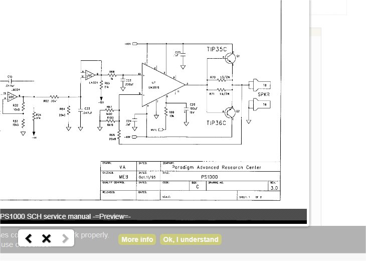

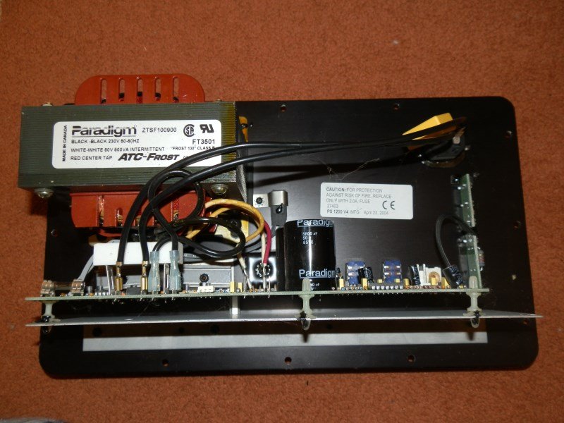

The (older) Paradigm's all use 4 device AB amps (below).
That looks like a real good EI trafo ... No "good cheers" alibaba POS.
But , look at the PS 1000 schema ( 2) - It is just tip35/36 driven by a CHIP.
Not what I would like for 500 - 1000$ subs.
Dayton audio makes what they call a SPA 250 (below 3). Ha ha , another chip driven Chinese wonder. all for 170USD ... damn.
I'm glad I DIYA ... I have a Fully discrete 2sc5200/sa1943 sub amp with
an Antek toroid.
Wow !! the BK BSBP 275 is a REAL - REAL amp !!! Toriod and a bloody EF3 class AB.
Like my Slewmasters !!! British still make real amps !! I'm impressed -
for about the same price as the Dayton.
OS

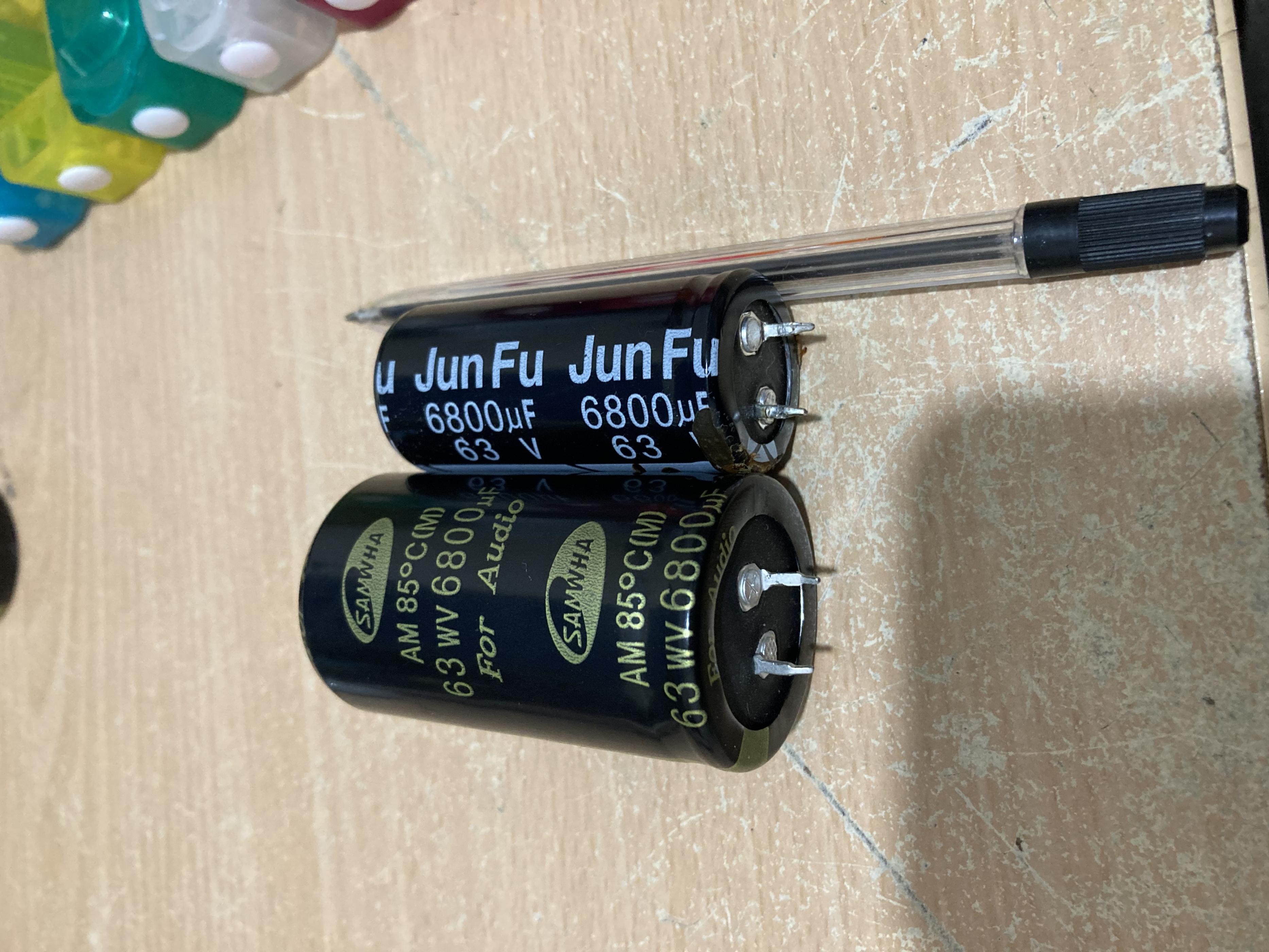

ostripper 2nd March 2021 05:37 PM
Klipsch is garbage as well.
1 Attachment(s)
Same "grifter" TO-220 darlington BS as the POLK's. (below)
Why not at least bridged LM3886's like logitech ?? I would even prefer that.
I suppose one would need to go to the level of the SVS -pro to
get any thing that is not a toy. But , for 800$$ ???
OS
