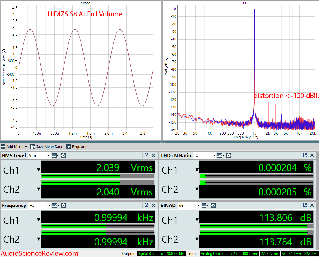

Thanks. Very informative. I just found out that my DAC has Vpp of 5.7v at full scale output, which appear to translate to 4Vrms. I think I may be in the real low end of the doable zone.
indra1 20th January 2021 07:21 PM
5.77Vpp is 2V RMS.

You are right. Used the wrong calculator and put 5.70v as Vmax instead of Vpp.
MarsBravo 20th January 2021 07:29 PM
5.7Vpp renders approx 2.0Vrms. You need a bridge to reach 3.8Vrms.
{ 5,7pp = 2.85p => * 0.707 = 2.0Vrms (sine wave) }

If Vmax is 5.7, then what is Vmin? 0.0V? Then it's still 2Vrms.
mudihan 20th January 2021 07:33 PM
Quote:
Originally Posted by MarsBravo (https://www.diyaudio.com/forums/solid-state/366490-unity-gain-amp-efficiency-speakers-post6497106.html#post6497106)
I believe the calculator assumes that Vmin would be negative 5.7v, i.e., Vmax is half of Vpp.
