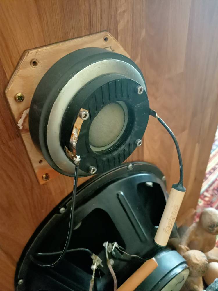

Bas Horneman 23rd January 2021 10:09 AM
2 Attachment(s)
Why do you think this is not possible with compression drivers to remove the back?
Attachment 914341Attachment 914342
