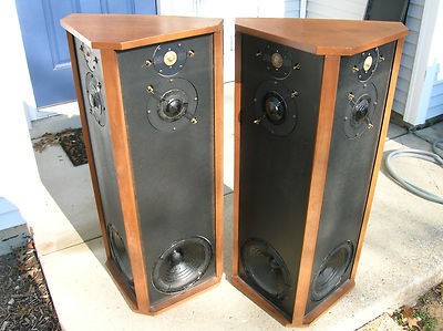

I would look at the old Allison 1 for ideas.
Allison One Series Brochure (1978) pg5 | The Classic Speaker Pages
