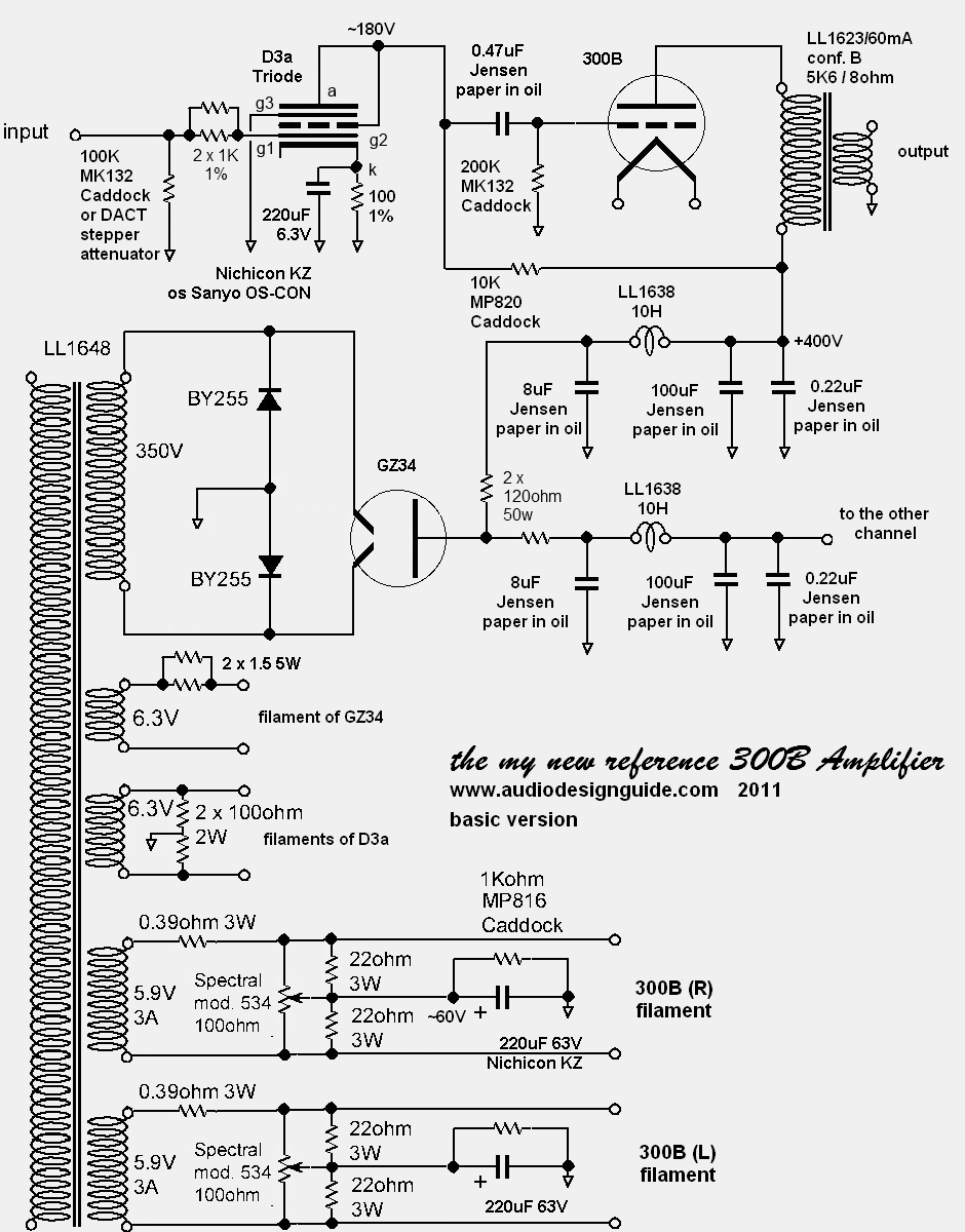

Ever since I had some new boards made for my amp I haven't been able to get it to work right. The signal is static on it but if I take my fingers and touch the driver tubes it gets loud and the static quits. I am touching the glass only. I was pushing on the tubes and noticed it change and I thought there was some internal issues with the circuit board but it affects it without putting any pressure on the tubes. Just touching the glass is enough.
I thought maybe a bad ground and its maybe working because its grounding thru me? The audio ground I mean. I have the rca jacks on the back connected to star ground but I am going to try running them straight to the pot and see if that matters. Any ideas are welcome.
D3a drivers with 300B SE output tubes.
I am going to try moving the ground directly to the pot like i always have in the past.
Why would an oscillation stop when you touch the tubes? That is something I know next to nothing about about.
schematic attached but its pretty simple.

If the board worked before being installed in the new chassis, it is probably ok.
Check the input and output wiring, and the common connections. Keep the input socket and input wiring
away from other parts of the circuit, especially away from the output transformer leads and the output
terminals. Bring the input common to the supply common separately from the output stage common
and the speaker common.

If both channels of the board are unstable (with different layouts), the D3A could as mentioned
need ferrite bead(s). This is a very wide bandwidth tube. You could cut the traces close to the
tube and add a jumper with the bead, for each tube terminal. I would start with the screen 2,
then the grid, cathode, plate. Do one bead at a time.
Also I would try local bypassing across each filament, 0.1uF.
Last thing to try is adding local decoupling on the board for the power supplies,
a larger electrolytic and a smaller ceramic, for each channel.
WOO HOO New boards fixed it bigtime...
I have my stereo back ....
