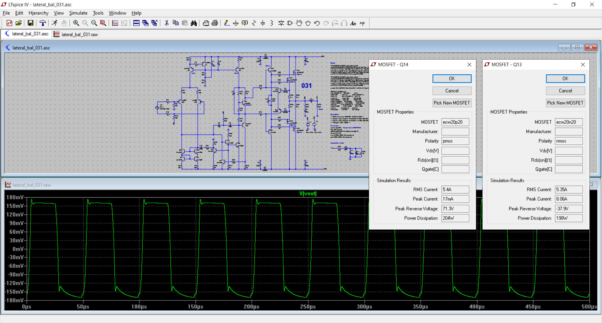

Closed loop gain shows ~88 degrees at the 0dB point, and the gain plot looks nice and smooth, as does the phase plot. That, in a nutshell, sums up the design. What I would love your input on is whether there's any elegant ways to further improve performance I might have missed?
Please find the relevant plots attached, as well as the LTspice .asc file for the amplifier design.

The drivers reduce the THD by about 10dB, so their addition was well worth it in my opinion. They’re biased at 16mA to better be able to suck the (significant) gate charge out of the MOSFEts.
The bias generator is there to better control the temperature drift if you bias the lateral MOSFETs below the point where their tempco switches from positive to negative. In that case there’s significant drift in the heatsink temperature, the simple Vbe bias generator keeps that in check. The prototype will need to show whether this is a real world requirement, if not I’ll revert back to a simple trimpot.

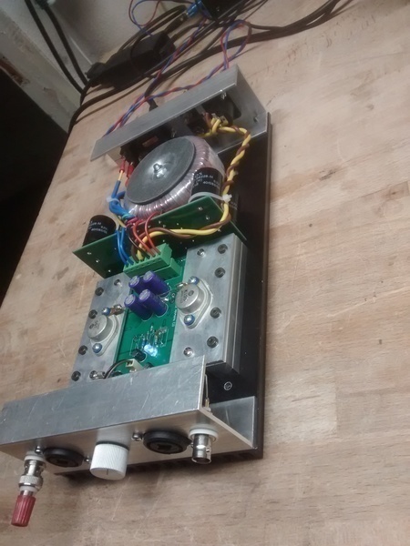

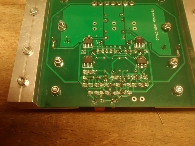

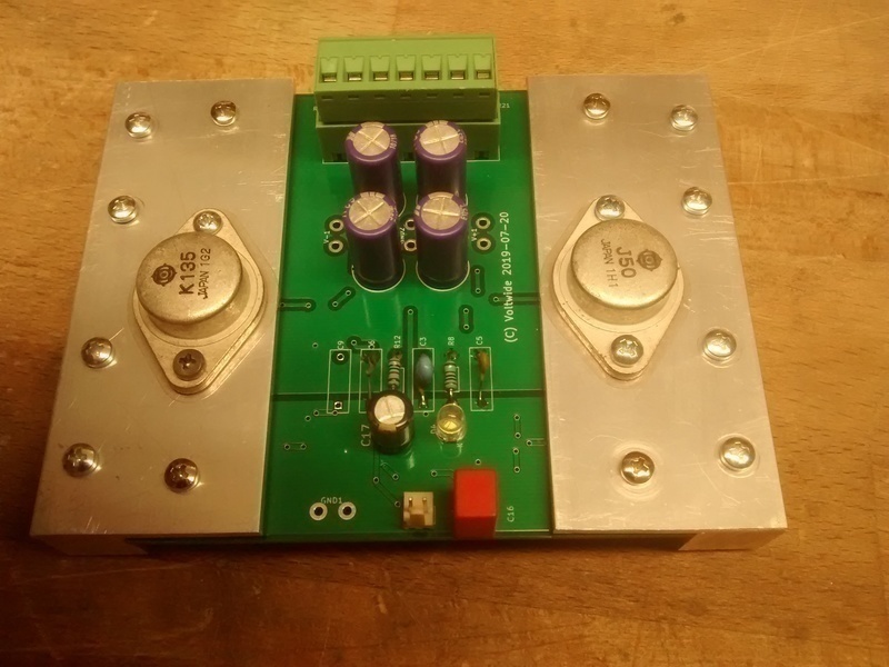

Some yrs ago I got my hands on some original NOS 2SK135/2SJ50. This inpired me, after decades, to design an latFET-amp using extensively LTSpice. Out came a Monoblock with one pair of LatFETs intended as ultra-rigid lab ref amp with a bandwidth of several 100kHz. The technical data measured at the prototype are excellent and should be quite encouraging to build your own latFET amp.
Of that 10dB reduction of THD was this 2-5 harmonics, or 5-20 harmonics? I ask because the Zout of the emitter followers is typically 26/12= 2R yet the stoppers are 47R and it seems to me that the impedance issue is secondary; it could be caused by the fast flow of charge into and out of the gate, and this could be achieved with highish current (18mA or so) between two collectors.
I see this reduction at 100W/8R/20kHz, I've not been looking at lower frequencies to be honest as my thinking was that those automatically will be significantly reduced as the loopgain is much higher at lower frequencies.
Very nice, thanks for sharing!

Quote "The ECW20x20 lateral MOSFETs have built in 14V gate zeners, so I don't need additional zeners, how would you connect the diodes exactly? The reason Q15+Q16 are there is to prevent excessive dissipation in the MOSFETs when the output is shorted."
I was convinced these laterals did not have gate zeners that is why I included them in my builds.
I contacted the manufacturer and they let me know the ECW20x20 lateral MOSFETs have 14V/1W zeners on die, it even states so in the datasheet, although somewhat cryptic, max. gate/source voltage +/-14V.
If I may make a suggestion? In your schematic I also see some MUR460 diodes, you don't need these either, as MOSFETs have an intrinsic body diode that's a result of the manufacturing process. These are well equipped to offer the overshoot protection you meant to implement with those diodes.
