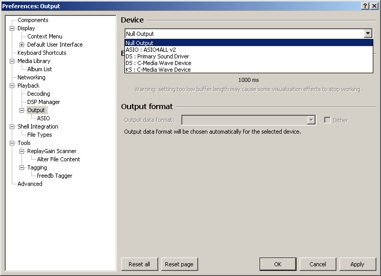

Now I don't know what your preferred audio playback program is, but for testing I suggest foobar2000. Get it here -
Download foobar2000
Also download the kernel-streaming and ASIO output components -
foobar2000: Components Repository - ASIO support
foobar2000: Components Repository - Kernel Streaming support - this is a .dll file which should be extracted to a temporary folder.
Launch foobar2000 and go to File > Preferences > Components
Use Windows Explorer to drag foo_out_ks.dll and foo_out_asio.fb2k-component into the right side window.
Click "Apply" and restart foobar2000.
Finally go to File > Preferences > Playback > Output
In the dropdown menu for "Device" hopefully you will now see a kernel-streaming or ASIO option for your M3.

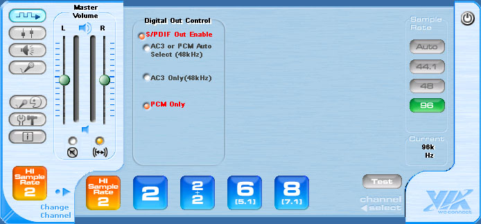

spaceman5 29th November 2020 12:43 PM
BTW
In addition to improving the USB path,
I would also like after that to enable the SPDIF Optical path,
to achieve the maximum that the DAC can work on.
Quote:
Originally Posted by linuxfan (https://www.diyaudio.com/forums/pc-based/363676-16bit-48khz-using-ti-tas1020b-windows-xp-post6429999.html#post6429999)
The CS4398 DAC chip in the SMSL M3 supports samplerates up to 192kHz, but 192kHz can only be realised using the s/pdif interface.
The M3's TAS1020B USB interface supports a maximum samplerate of 96kHz.
You're right..
https://i.postimg.cc/Rhx1Tz7Z/Sample...d-Bit-Rate.png
What should I use for SPDIF (Optical) out?
Maybe some USB->Optical adapter?
Any one that is recommended, and should work on Windows XP too?

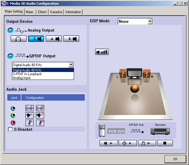

phofman 29th November 2020 06:56 PM
Many desktop motherboards have spdif header onboard from their internal Intel HDA. There are cheap header - TOSLINK/SPDIF adapters on ebay e.g. SPDIF optical and RCA out plate cable bracket for asus msi gigabyte motherboa ZT | eBay . Then it would be only about your Intel HDA drivers.
spaceman5 29th November 2020 07:12 PM
My motherboard actually got that - 2 pins for SPDIF..
https://i.postimg.cc/hjk5Pz7G/SPDIF.png
So I will order this SPDIF Panel, thank you.
BTW, until it arrives, how can I know what Sample Rate and Bits per Sample will the Optical SPDIF on the mtherboard support?
The manual of the motherboard does not seem to mention it..
The only thing I found is
"The front panel audio header supports Intel High Definition audio (HD) and AC'97 audio".
When searching Google for "Intel High Definition Audio", I got:
Quote:
Intel High Definition Audio (IHDA) (also called HD Audio or development codename Azalia)
is a specification for the audio sub-system of personal computers.
It was released by Intel in 2004 as successor to its AC'97 PC audio standard.
Intel High Definition Audio - Wikipedia
So IHDA is newer than AC'97..
They continue:
Quote:
The Intel High Definition Audio specification includes the following features:
Up to 15 input and 15 output streams
Up to 16 PCM audio channels per stream
Sample resolutions of 8–32 bits
Sample rates of 6–192 kHz
So should I assume that on the Optical SPDIF header on the motherboard it should also transmit in 32bit/192KHz?
If yes, then that's wonderful..
phofman 29th November 2020 07:20 PM
Intel HDA supports that easily. But what counts is your HDA codec and especially drivers. What is your MB model?
spaceman5 29th November 2020 07:25 PM
The motherboard is Gigabyte B75M-D3H (rev. 1.0).
GA-B75M-D3H (rev. 1.0) Overview | Motherboard - GIGABYTE Global
The Audio Driver installation file is named "mb_driver_audio_realtek_azalia_7series.exe".
"Azalia" is the development codename for Intel High Definition Audio, as written in Wikipedia..
So that's what I have installed on that Windows XP..
Is that enough?
What is my HDA codec?
phofman 29th November 2020 07:57 PM
As that link you posted says: Realtek ALC887 codec
https://www.hardwaresecrets.com/datasheets/ALC887.pdf
Quote:
The ALC887 supports 16/20/24-bit SPDIF input and output functions with sampling rate of up to 192kHz
It's only about your drivers, if they support the full features of your HW.
I would try Asio4All on top of your drivers and see if the SPDIF output is available. If so, you can try some 192/24 playback e.g. in foobar.
spaceman5 29th November 2020 08:16 PM
Thank you very much.
Will check experiment with it in the following days.
Hopefully the SPDIF Panel will arrive soon :)
