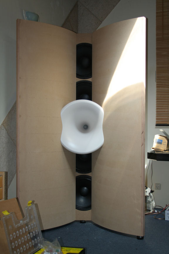

So I've been back to thinking about line arrays, and how to get better bass response with them without resorting to ridiculous amounts of boost. Wondering if there is anything like this idea here to have the opening of a horn go floor to ceiling? Not sure how it would work, perhaps a couple of large drivers inside the main part of the cabinet, with an array of tweeters at some point inside of the horn? I was thinking this might be able to help have better off axis response?
or perhaps a line of full range drivers inside the horn with some sort of exponential taper to it? if it were sized right, maybe could make up for the falling response of the array on the high end, and at least remove that EQ hurdle?
construction could be either stacked MDF/plywood, or better would be to cut slits and bend along its length, since stacked wood that high is asking for trouble. Not sure how to get the drivers inside, but an access panel on the front might allow for the to be put in on the inside of a baffle facing the horn.
This is probably a crazy idea, but maybe it's a stroke of genius? I was originally thinking that it would be a way to have a relatively large cabinet for a bass to mid speaker that would feed the sound out alongside a floor to ceiling array, or symmetricly along both sides of an array of tweeters placed in the middle of the horn opening.

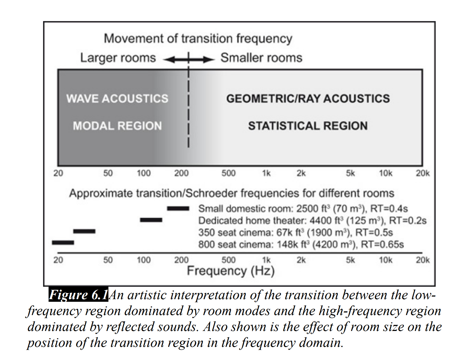

The modal region of your room will place a limit on how much benefit you'll gain by pushing your arrays into the bass frequency range.
Instead, design your arrays to work down to the modal region then cross over to a separate low frequency loudspeaker system.

Your chart has some odd numbers. 2500 sq ft is not a “small domestic room”, that is bigger than most people have for the whole house!
Twellmann 15th November 2020 09:54 PM
The numbers are for volumes, cubic feet.
2500ft^3/8ft (ceil height) = 312ft^2 floor area

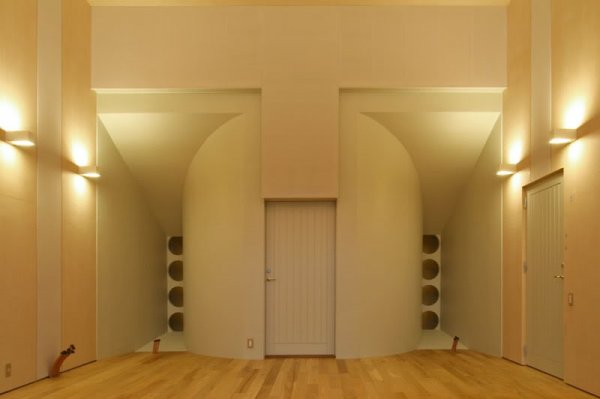

planet10 16th November 2020 02:49 AM
You can get 3-4 octaves out of a horn.
With an array you could like use those in the bottom octaves.
Divide the wall you are listening to into 2 and then design a back horn to a mouth that will probably need to slit load the array to get a mouth anywhere near small enuff for horn loading — just a wild *** guess, i’ve only done the math for midrange arrays.
What is on the other side of the wall? I knew someone on one of the local islands that had concrete horns extending out into his garden.
dave
