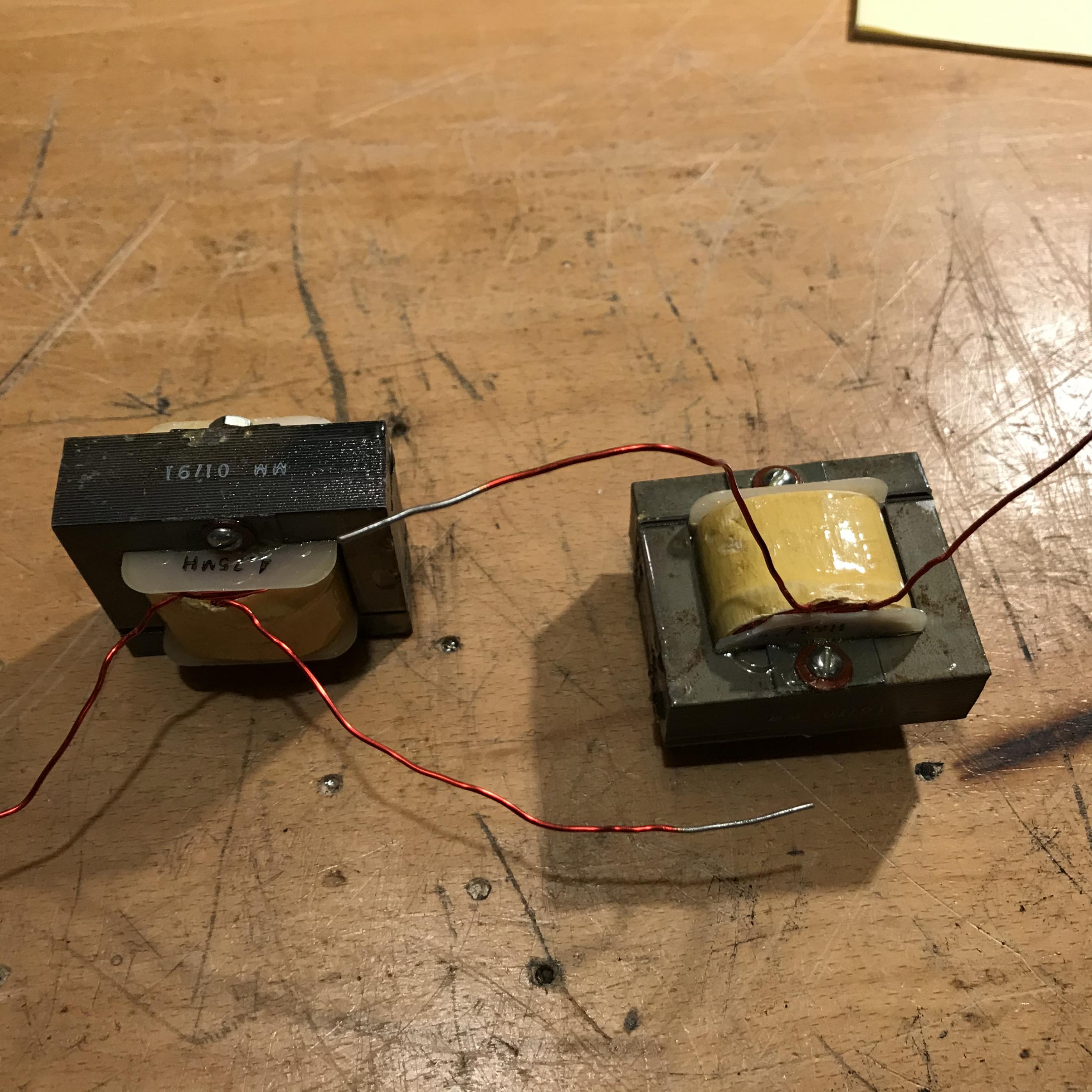

I have a Class A amp power supply on my Krell Clone - Pinkmouse boards)
Anyway, I want to change the CRC to CLC to see power supply ripple reduction.
I saw a few pics that the Pass amps have an iron core inductor (similar to Speaker crossover coils). I did find in my stash two chokes of 4.75mh and .2 ohms DCR (amp rating unknown). These look like vintage Altec Lansing Iron Core Crossover inductors - see pics... look to be 16awg wire...
I remember years ago trying this and the inductors got quite hot (I am pulling around 6A per rail) after a while, but so did the whole damn amp!.
The power supply is a 1KVA Toroid into a 25A Rectifier - 56,000uf - L - 56,000uf and rails are +/- 36VDC.
Anyway, if only .2ohms and 6 amp, 16awg, how to guess at power capabilities (weigh it?)
Whats too hot? Yes, I get that I dont wanna melt the coating...
I see crossover iron core inductors rated at 500W but only .2ohms DCR - how / why? I know there is more to this than Amp x Resistance going into the power rating...

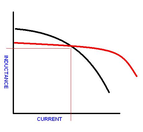

Gapped cores hold their inductance at value for a greater variation on DC current.
Ungapped cores have a decrease in inductance vs DC current that can start happening with very little current...they start to saturate quickly.
Some inductor manufacturers rate their cores at a 10% decrease in inductance at the quoted saturation current.
Inductance and resistance are only part of an inductors' ratings / characteristics.
If you are passing enough current to saturate the core of your inductor you may end up with an effective R...not the L you were looking for.

So it is just the resistance? In other words the resistance does not change with a saturated core?
All I was ever seeing was the 7 watts of heat? OK. maybe overly concerned over nothing.
