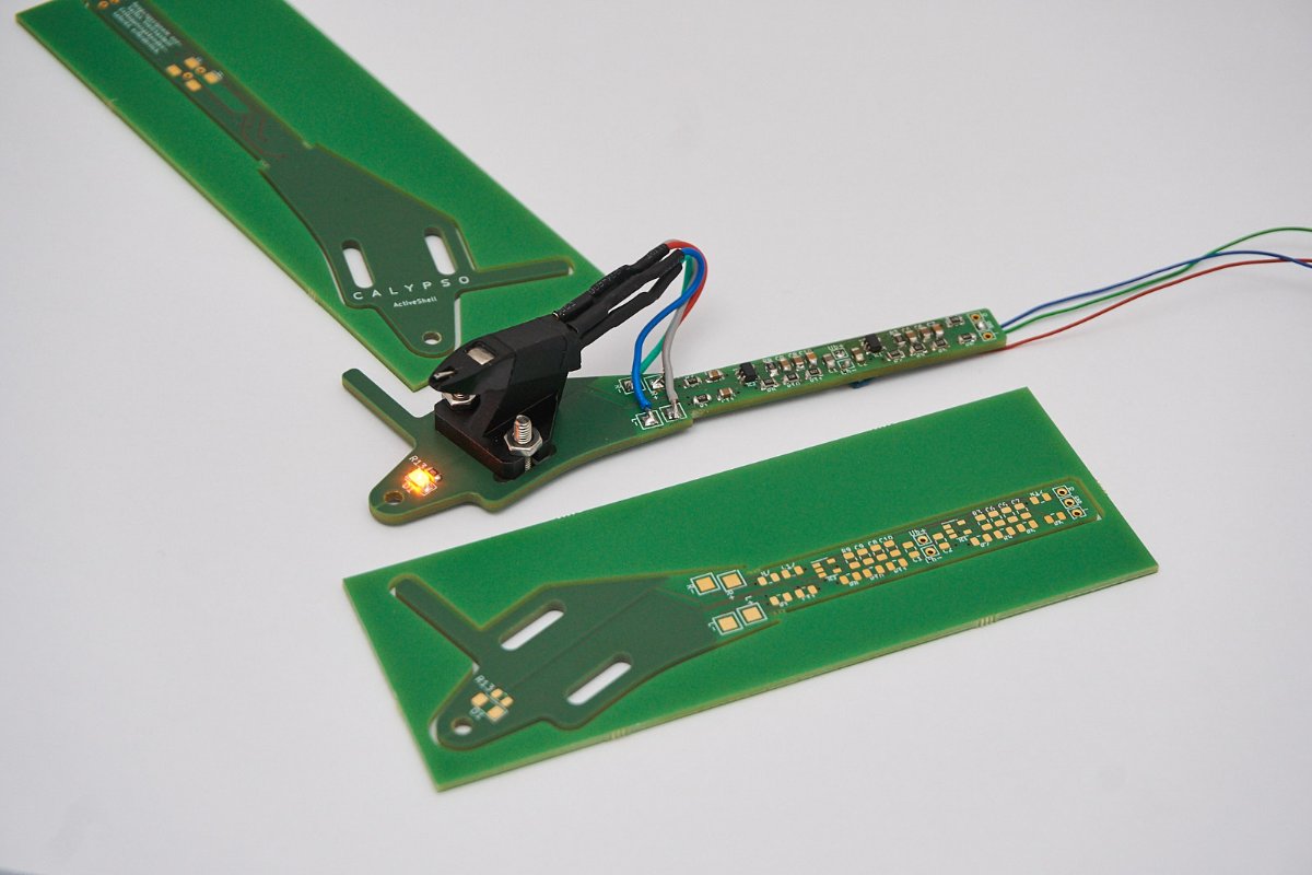

A recent DIY approach shown which I think was posted on here, but cannot find again now. Requires a DIY arm to go with it, but a lot of fun and hats off for the packaging.

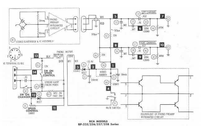

It's been done, decades ago.
RCA Victor came out with an integrated cartridge/preamp back around 1967.
The whole thing floated on a pivot in the headshell at about 4 grams, and made remarkable music in their higher-end stereo consoles.
The turntable motor supplied 13 volts DC to the IC, and even had a built-in muting circuit when the record changer cycled for another record.
PLUS, the changer even had adjustable speed, a synchronous motor, and a strobe light.
Talk about WAY ahead of their time!
