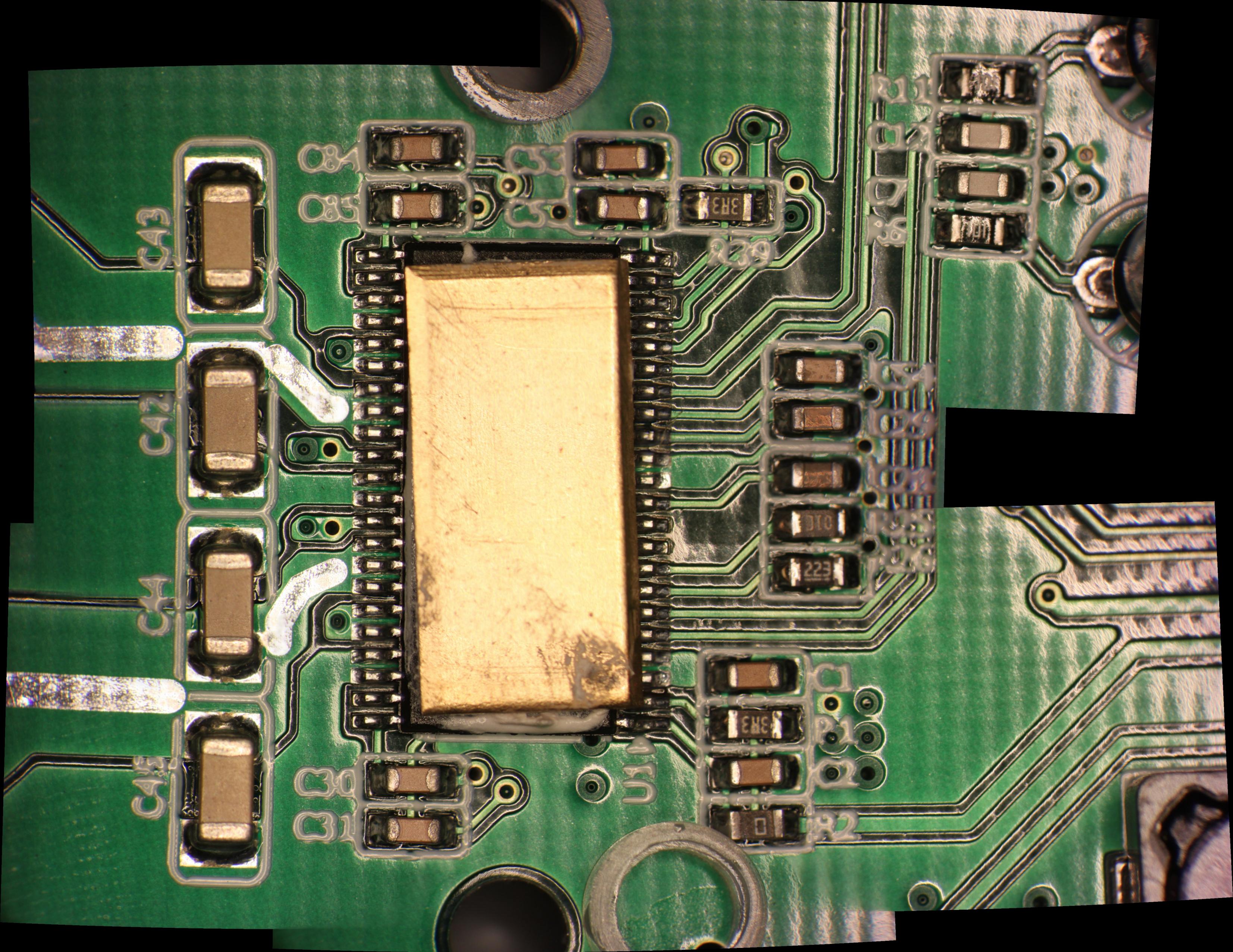

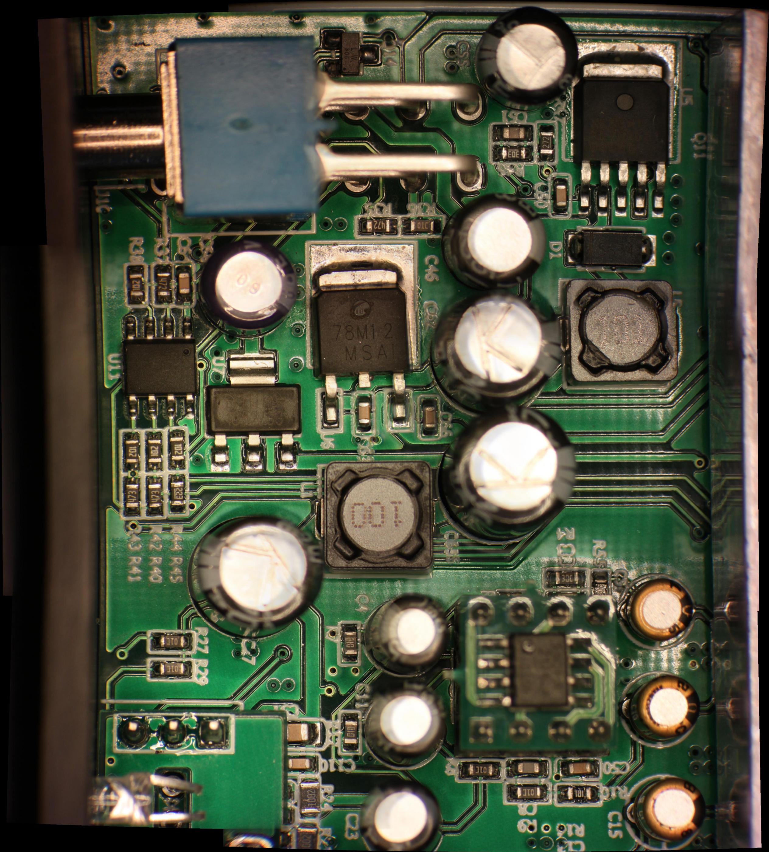

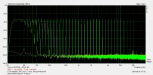

I decided to make a new thread on the measurements I did on this amp, since the 3255 thread is long and covers a lot of different amps: https://www.diyaudio.com/forums/class-d/287470-tpa3255-diy-discussion-design-etc.html
First some pics of the board, which is the later 'cost efficient' green board, not the earlier black PCB.

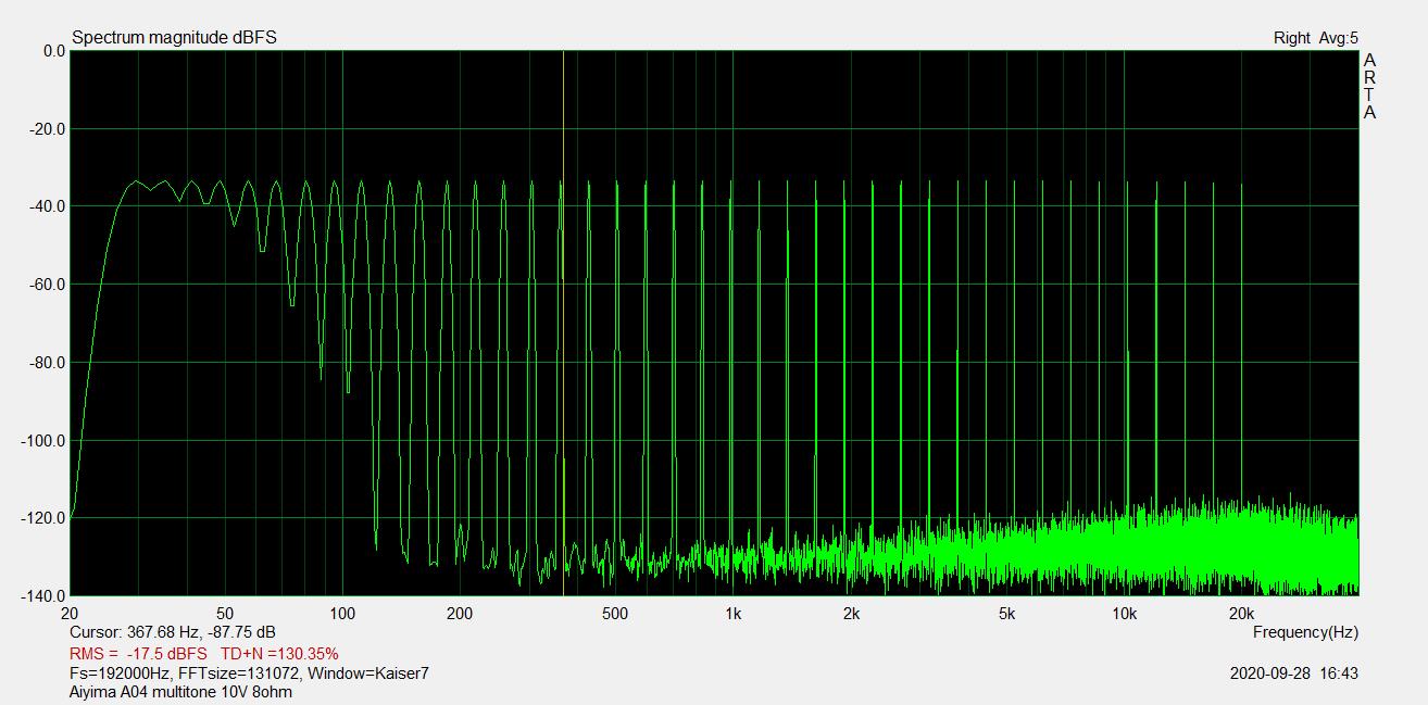

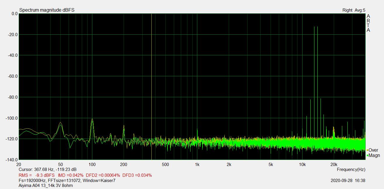

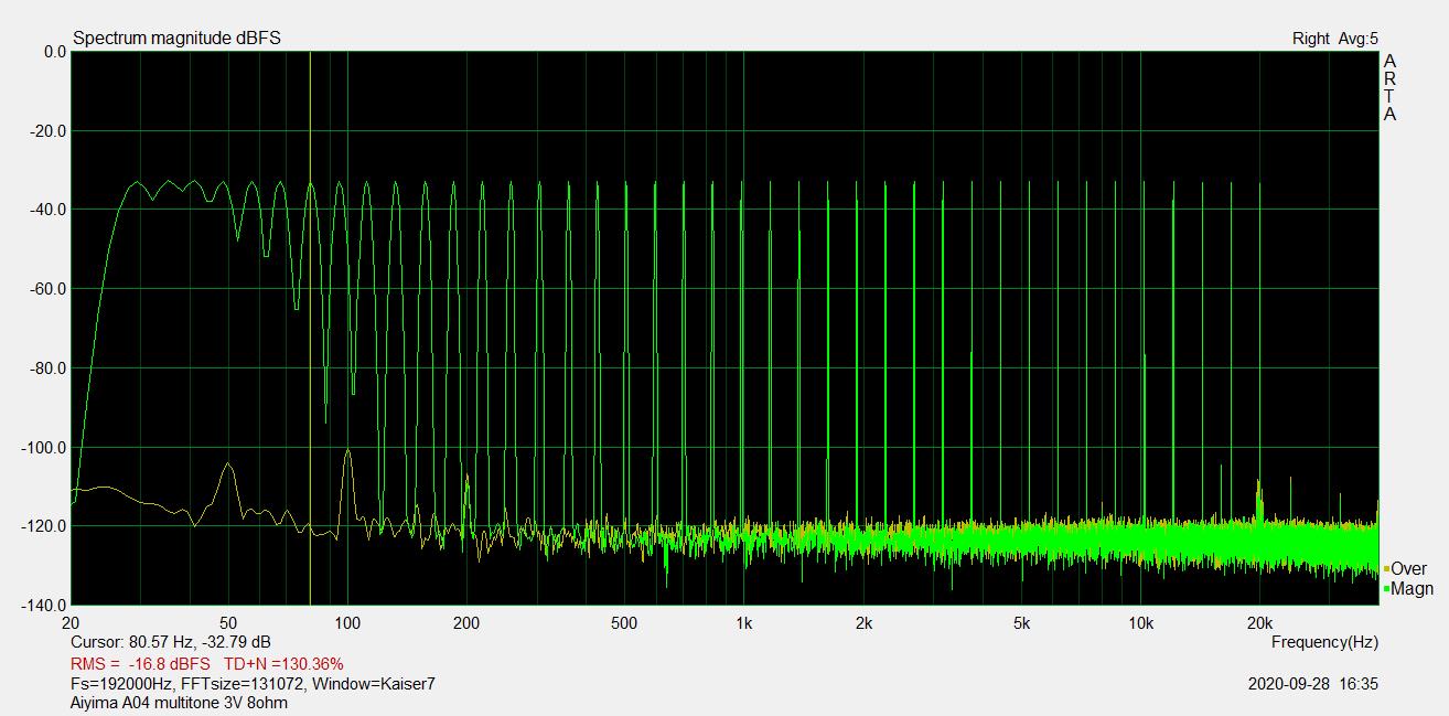

Measurements
All measurements using a 19,5V HP laptop brick rated 7,5A with pretty clean supply voltage. No extra cap on supply. Both channels loaded with 8ohm resistors, but only one channel measured. Measured using a Focusrite Scarlett solo using balanced input.
Output voltage was adjusted with single sine at 50Hz and DVM. No adjustment done when switching to other signals.

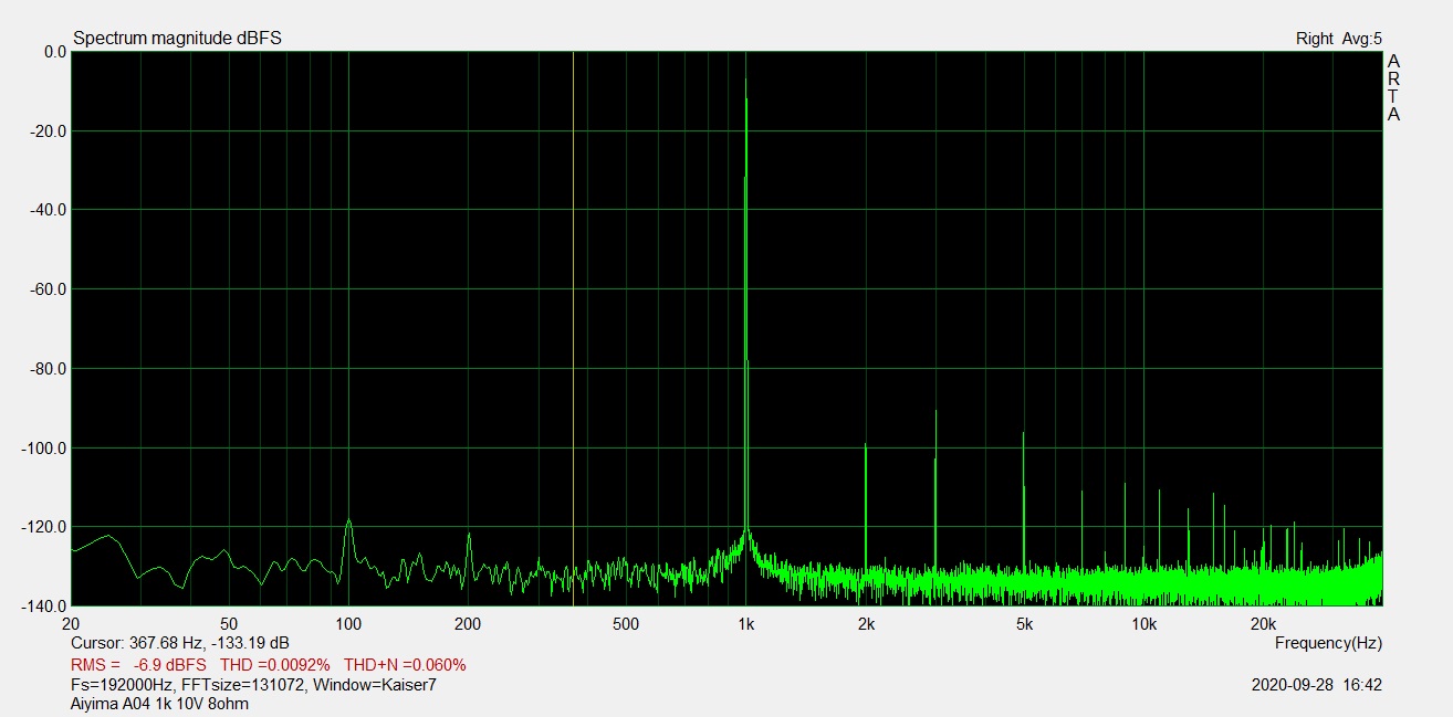

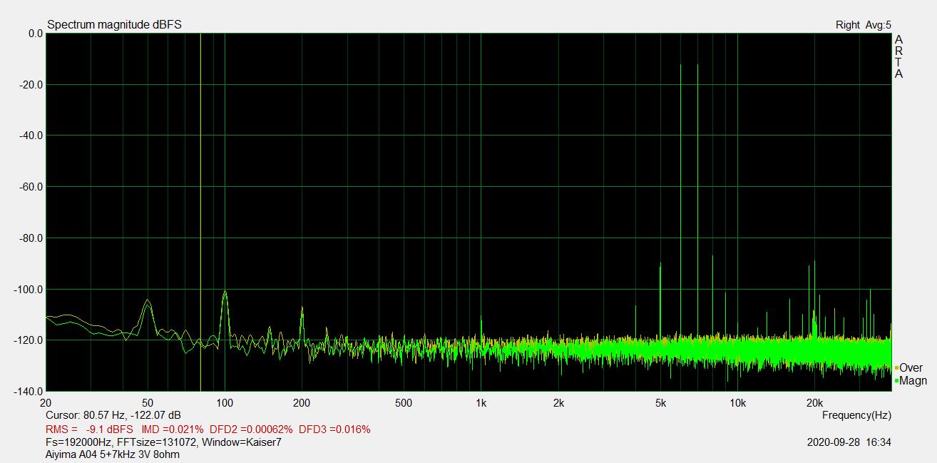

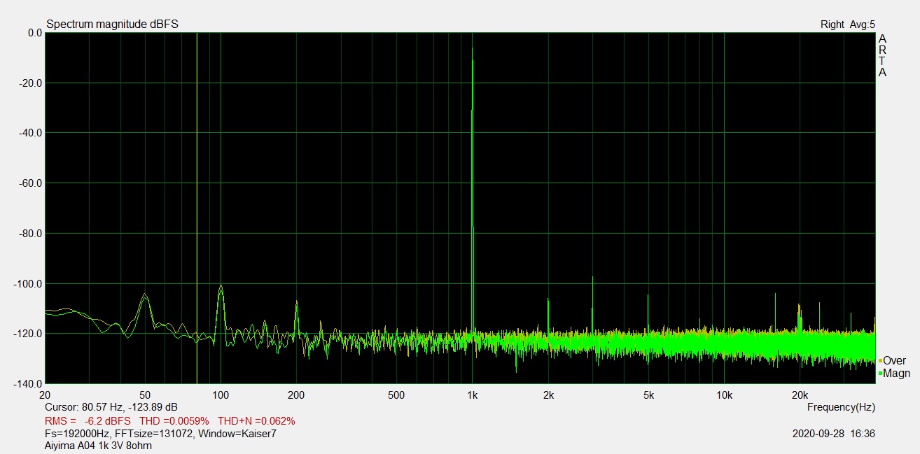

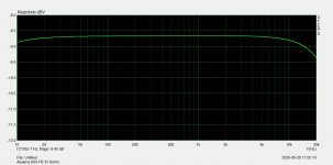

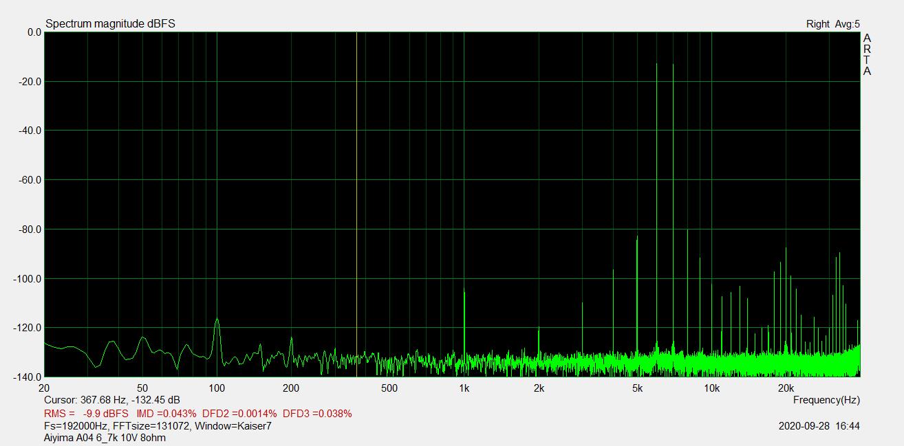

The 10V output gets a bit ugly, maybe because of mild saturation of the output inductors, or possibly it could need some extra cap on the supply?
The 6+7kHz test is something I started doing recently, and it seems pretty revealing of IMD. I have only measured one 'homebrew' AB amp in this way, and it gave similar results. Does not look too nice in my eyes, but as I said, I have very little reference.
I'm listening to the amp now, in the same configuration as measured. It is probably sounds better than any other class D I have heard, but none of them have been top end class D.
I'm a bit disappointed about the bass 'drive', I was expecting more control and extension somehow. Maybe an extra cap on the supply could do something to improve it.
It also seems to get a bit 'unclear' with 'busy' music. Mostly mid and treble. Treble seems a bit bright and like there is hiss added to it. And a hint of headache is beginning after some hours of listening now.

Nice measurements! Keep them coming!
