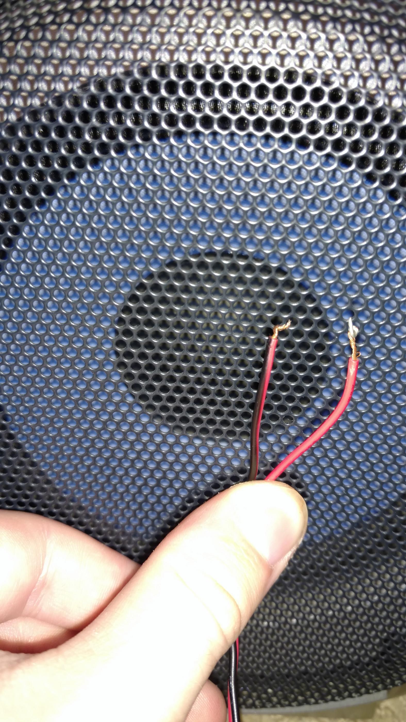

I'm making a DIY Bluetooth speaker from woofers, an amp, and a Bluetooth card. The audio goes from my phone to Bluetooth card, to amp then to speakers. However, the only way to connect the bluetooth card to the amp is over 3.5mm AUX, and I'm struggling to figure out how to do this.

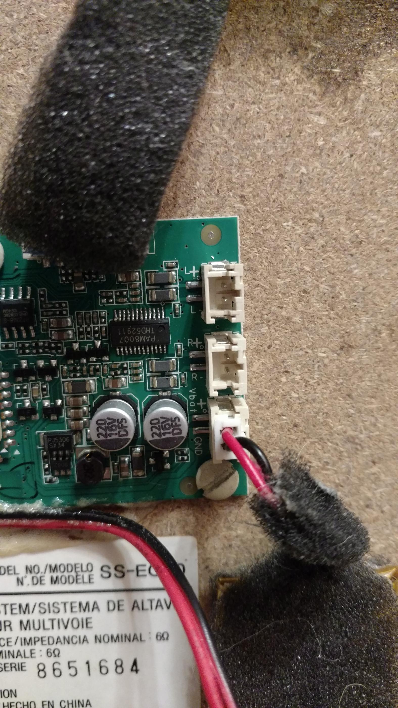

On the bletooth card there are 2 positive and negative ports (origionally sdesigned to go straight to speakers, but there going to an amp first now bevase the speakers are bigger.)
So does anyone have any suggestions on how to wire a set of stereo speakers to an AUX port? This AUX port was a solution to another problem someone here solved for me so I think it should be possible. Thank you in advance. (Also the amp will be here tomorrow so I'd like to get started)

Perhaps a photo of the "2 positive and negative ports" on the bluetooth device would help.

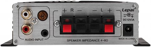

However, post a picture or details of the amp as well.

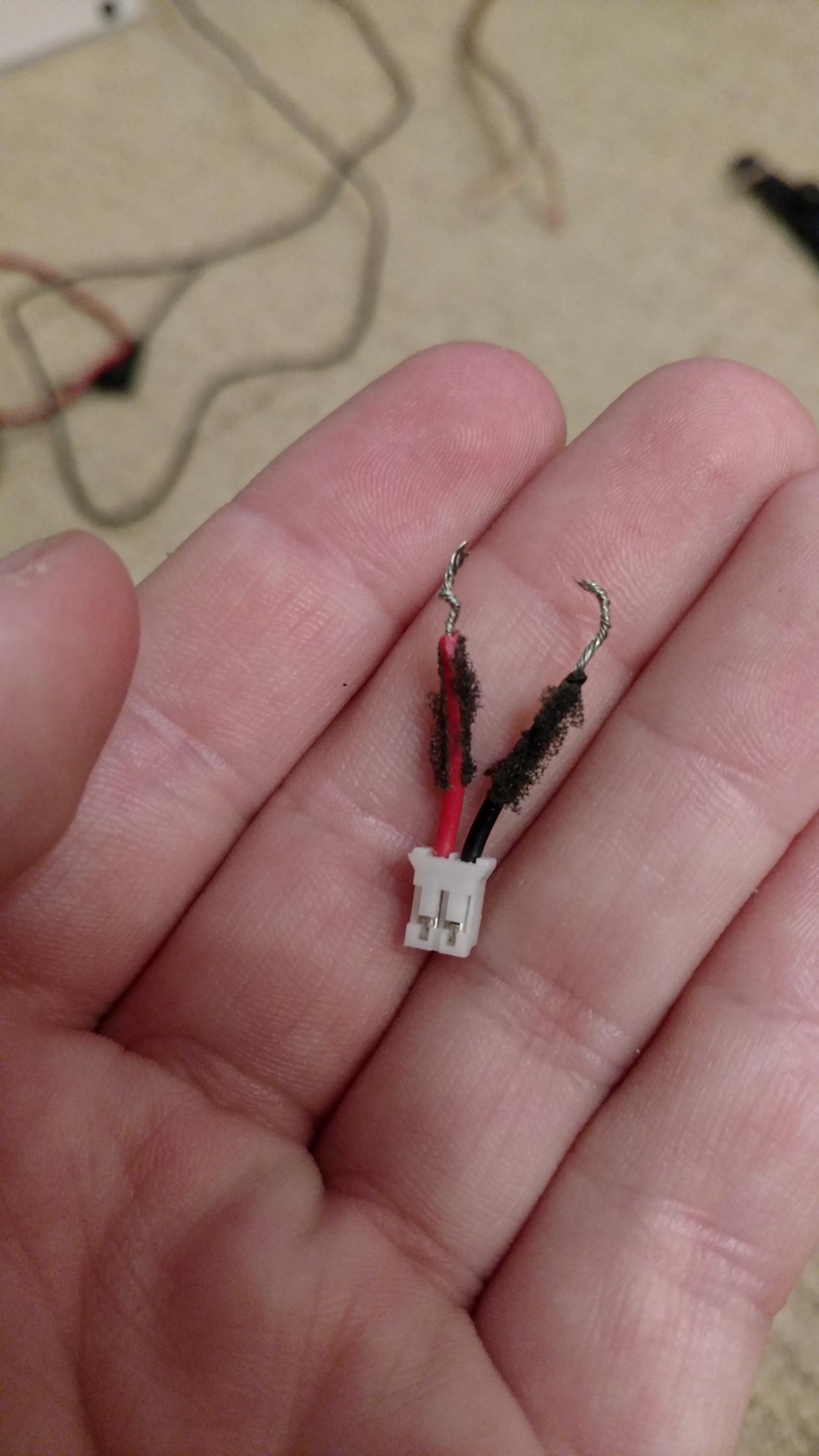

Yes sorry for the confusing thread. Yes, the output of a Bluetooth adaptor to go to a 3.5mm AUX port on an amplifier. I don't know how to upload an image on this site it's just 2 ports with red and black wires for left and right speakers that I need to plug into a 3.5mm socket. However, I'm not sure how to convert the output of the bluetooth board to 3.5mm. Hope this makes sense! And no, I don't mean RCA.

The Bluetooth board outputs 2 2.5 watts. The speakers are each 50 watts. I ordered a cheap x2 20-watt amp but the board outputs in 2 red and black speaker wire ports and the amp inputs in 3.5mm AUX so I need to find a way to convert the L/R red and black output to 3.5mm AUX, hopefully that makes more sense.
If your 20-watt amplifier comes with gain/volume control, you can simply connect the Bluetooth board L/R red and black output to 3.5mm AUX input via screw terminal 3.5mm plug.
