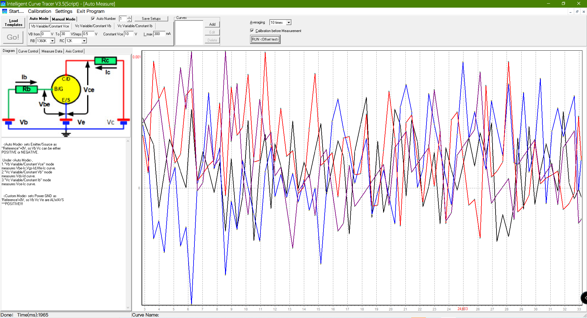

From early 2020, I got the new tracer and found out that the software have some bugs and poor English translation. Then, I started my work on optimizing the tracer software. Basically the terminology has been re-translated, so that it is much easier for international users. But translate the manual is huge task that I haven't done yet.
Right now, the software version is V3.5.30, in this version there are 2 important changes:
1. The color of curve tracing area has been change to white and blue, etc. This makes UI more friendly and readable.
2. The stamp of lockyZ's logo has been removed, and this helps when copying traces to clipboard and looks cleaner.

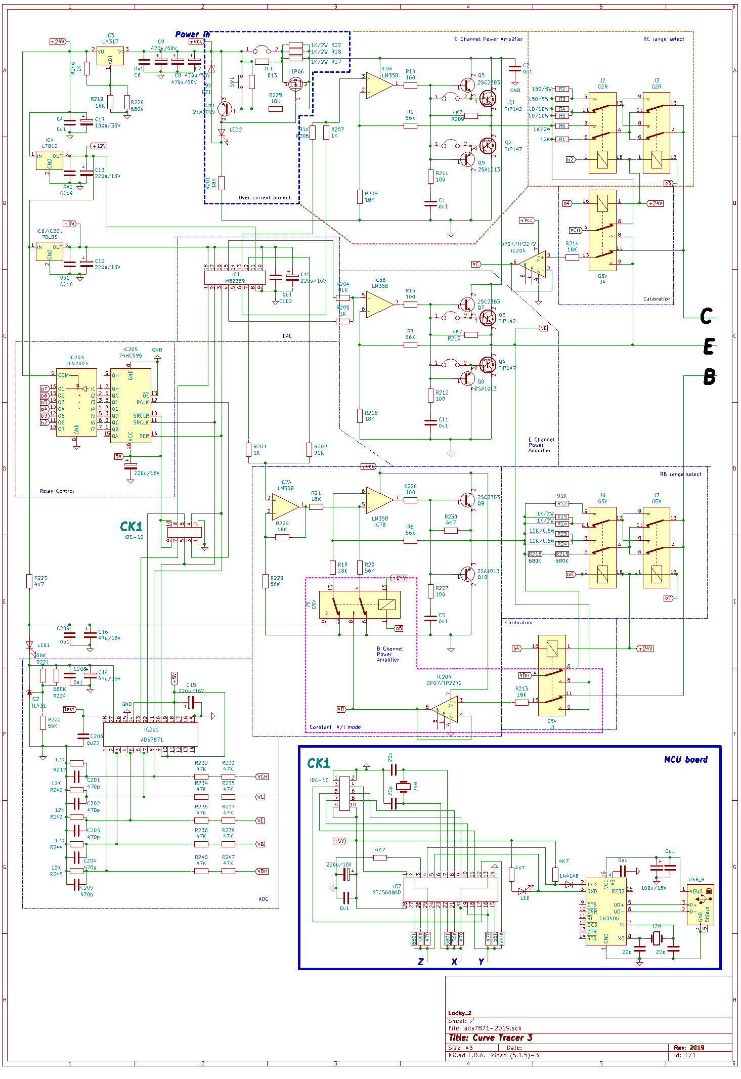

erikovsky 24th September 2020 11:24 PM
3 Attachment(s)

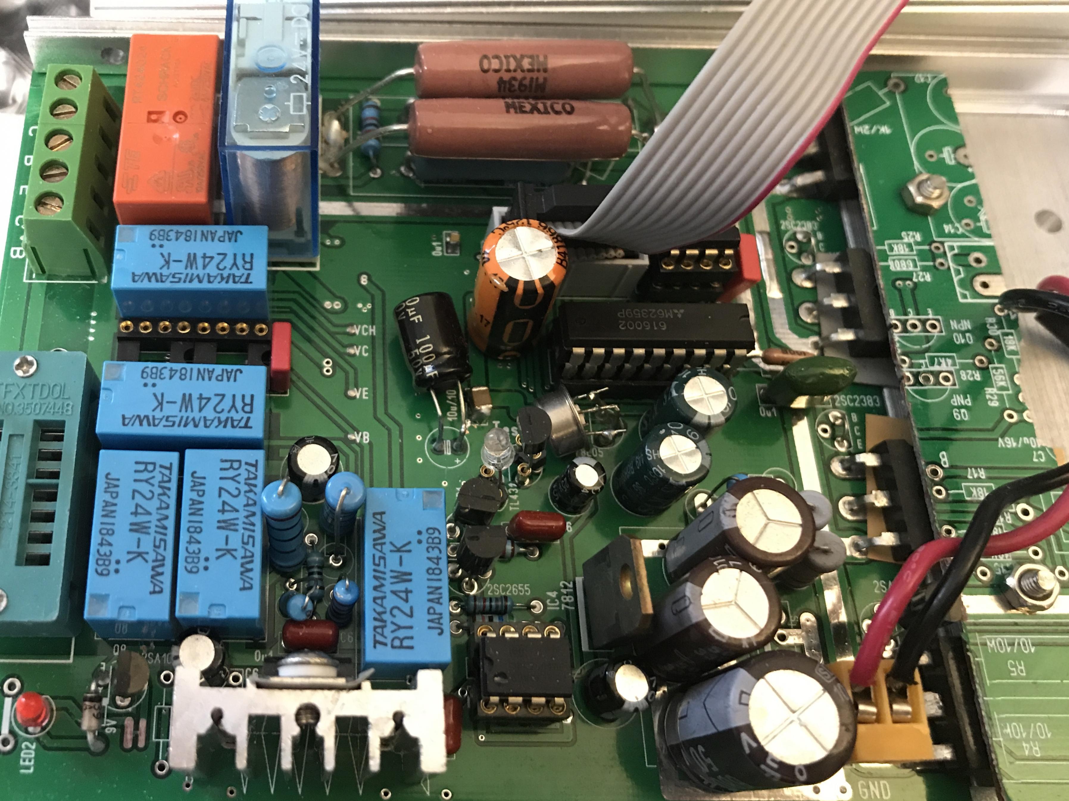

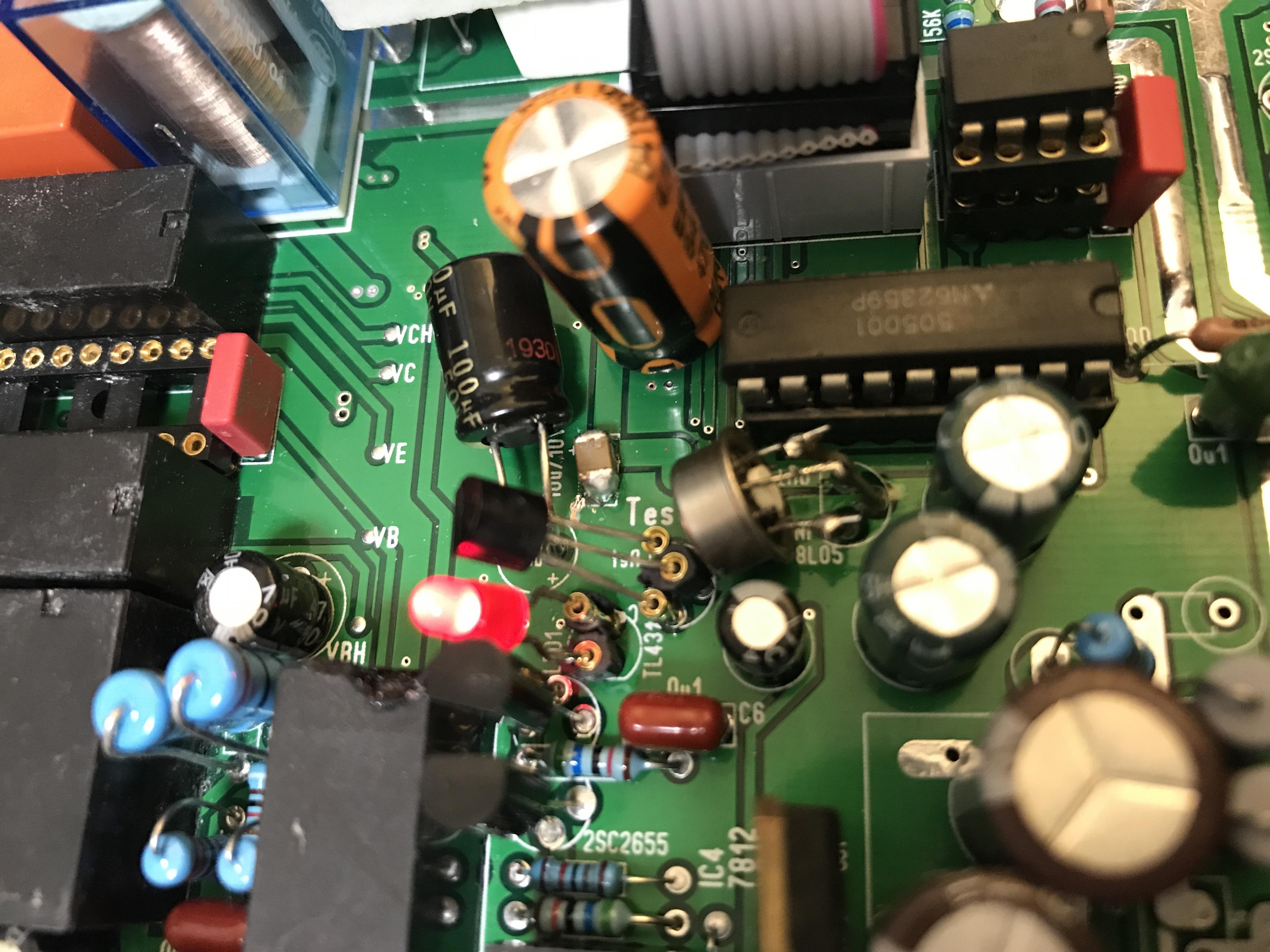

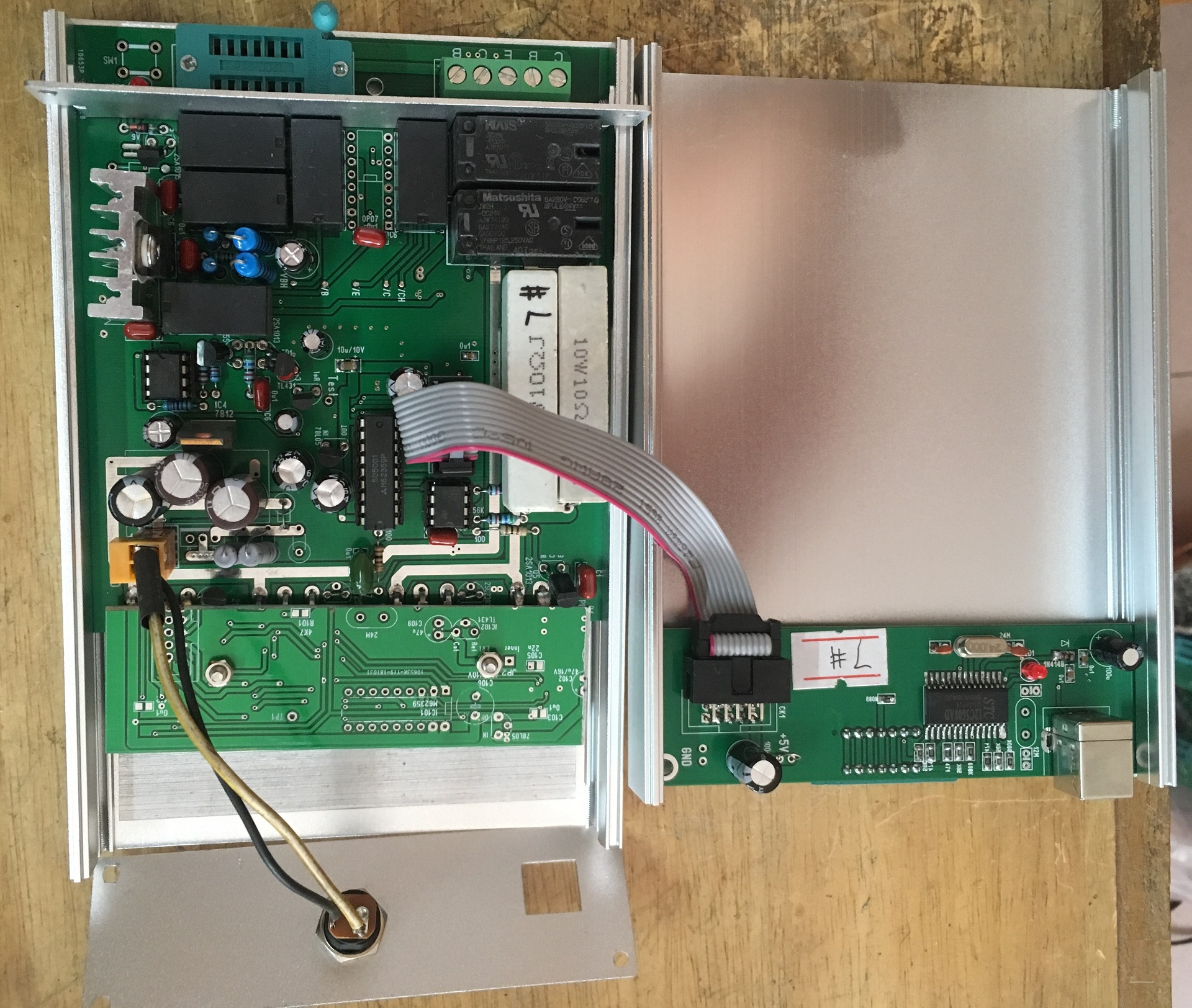

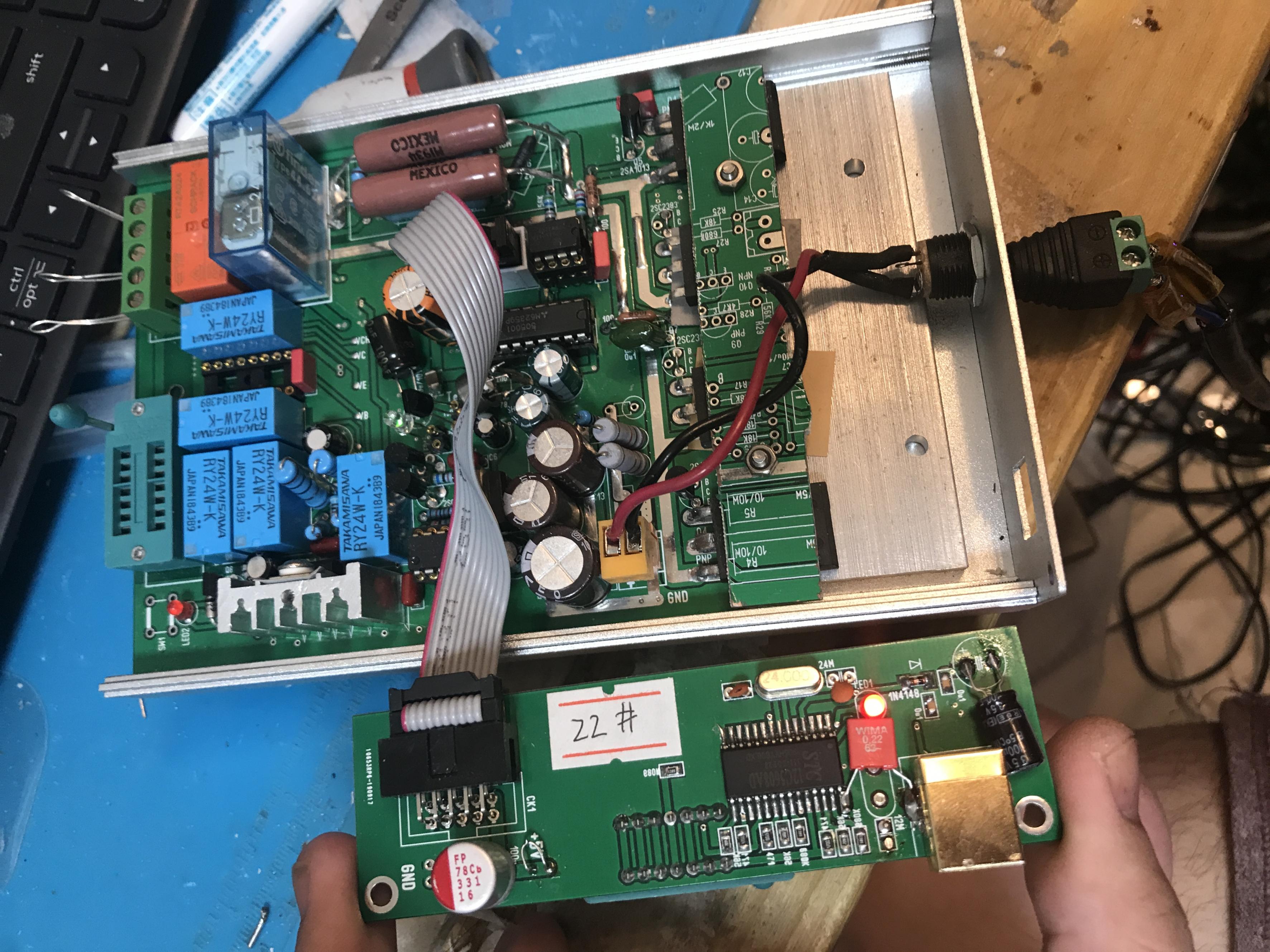

The 2020 new version of Intelligent tracer, and with full schematic attached.
I am modding the tracer,like upgrading Vref IC and place new low-ESR FP-CAP.
Since I got this tracer very early, it uses some second-handed parts, thus I also have to replace and desolder many relays, transistors and resistors that are crucial.
Some resistors have to be precise and low-temp-coefficient, so that the measurement will be accurate; using 0.1% 25ppm wirewound and even 0.01% 5ppm metal foil make sense.
Now Locky_Z is providing all-new-part version of the tracer, which is a good news to late birds. I would recommend this type, for those who haven't buy a tracer.:)

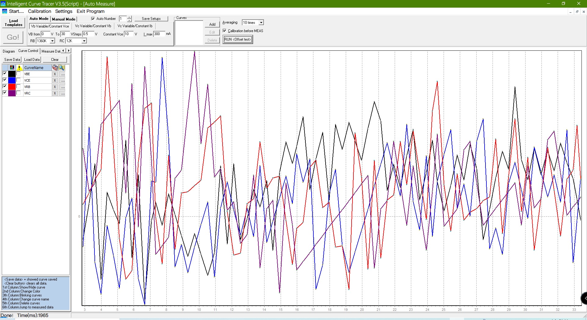

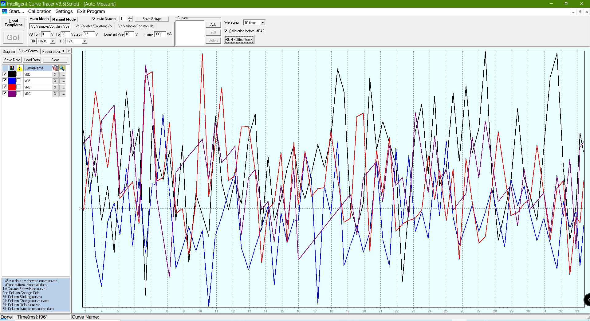

having waited for years I also bought the new version with used parts recently and are far from confident with it.
Probabely its still some unfamiliarity with the device, but more often than not it just puts out weird results and wild cards similar to what's shown in Your pics.
I put it aside because of great disapointment and low time.

For normal working of the tracer, I don't want to see unwanted, sudden failure of the tracer.
So replacing all the realys and OP-amps is a must. For precision measurement, the output resistors of BCE channel needs to be replaced with low-tempco, high precision wirewound resistors.
Personally, I also remove the 78L05, and use a precision 5V voltage source (REF02 or something) to supply the DAC.
These are my suggestions, and it can make your tracer far from sudden failure.
Oh, and try to control supply voltage about 36VDC, because that's the upper limit of signal OP-AMPs. You can supply it with 40VDC to get more wide measurement range, but I think that's not a good trade-off.
For +40VDC supply, the OP-Amp is working on the edge. It may or may not fail, but certainly increase the risk. For that 4 more volt range, I don't think it's worthy to take the risk.

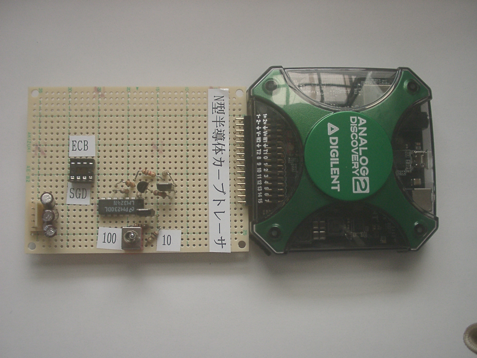

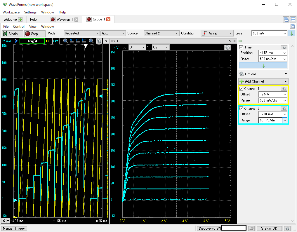

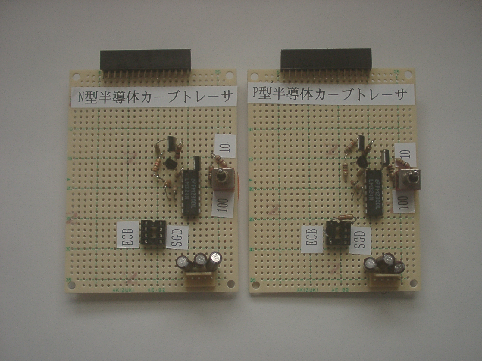

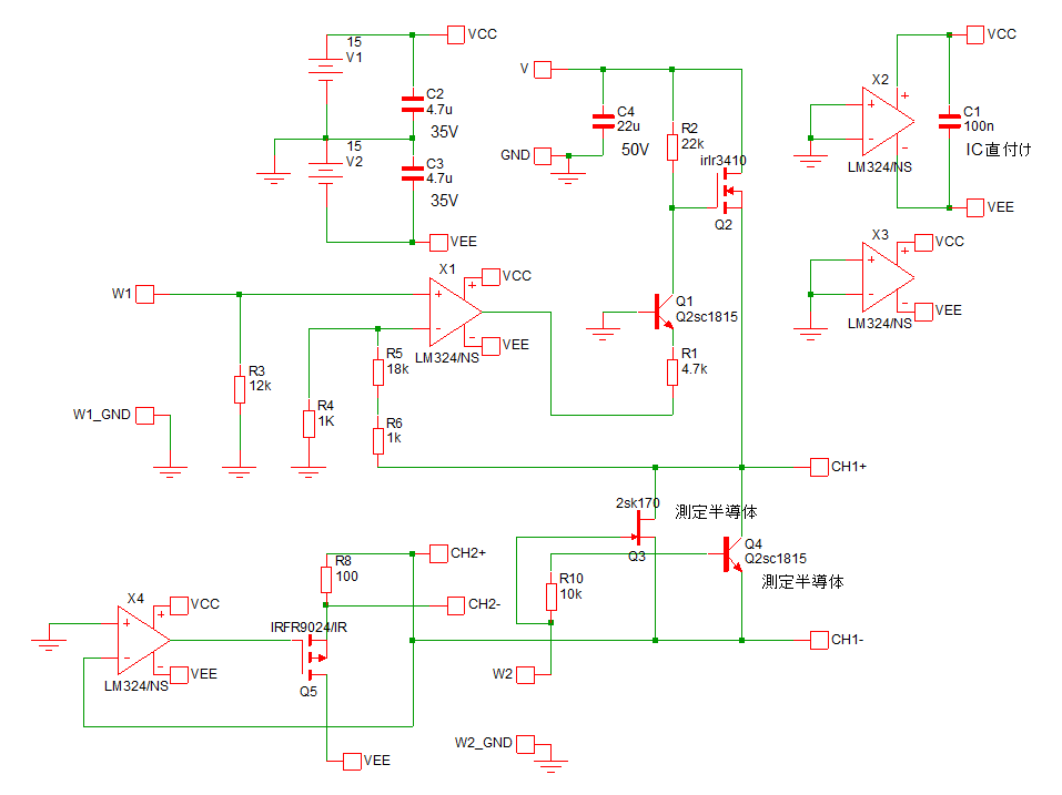

http://daisan-y.private.coocan.jp/
