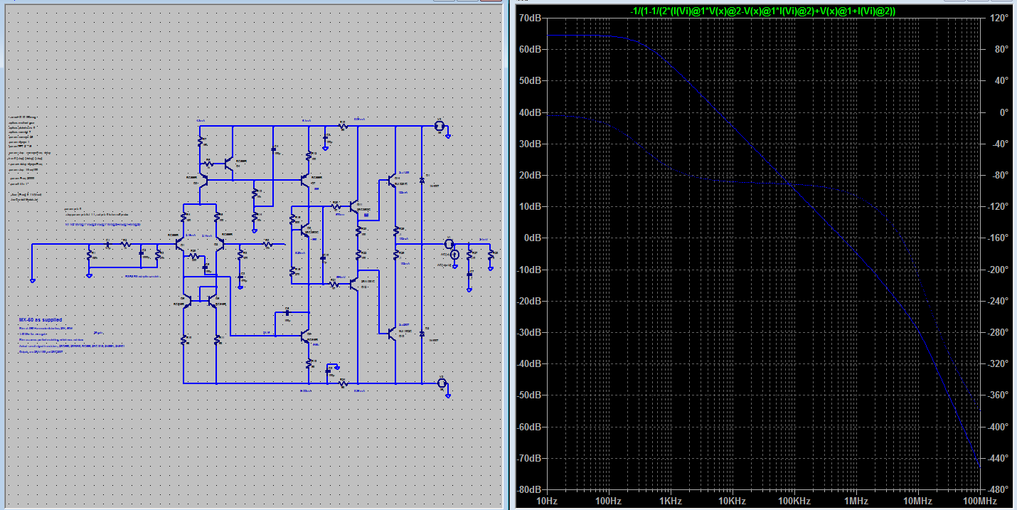

BesPav 17th September 2020 05:19 AM
3 Attachment(s)
Ok, let's check.
Change extension of *.zip file to *.plt (because *.plt can't be attached) and put *.plt file in same folder with *.asc.
Try model and compare with my printscreen *.png.
Rallyfinnen 17th September 2020 05:59 AM
Thank you! I ran the sim, and it seems to work (same result as you posted)
Forgive me for being a novice, but if I'm reading this correctly, phase is around 90deg where OL gain is 0? This should make a stable amp right?
BesPav 17th September 2020 07:27 AM
Quote:
Originally Posted by Rallyfinnen (https://www.diyaudio.com/forums/solid-state/360246-output-stage-cfp-ef-ljm-amp-post6344074.html#post6344074)
Pretty fine! Save this sheet with _OLG appendix.
Clearly!
Comment .step directive with ; in front, put voltage signal source at the now grounded input and use .tran instead of .ac.
Save modified sheet with _TRAN appendix.

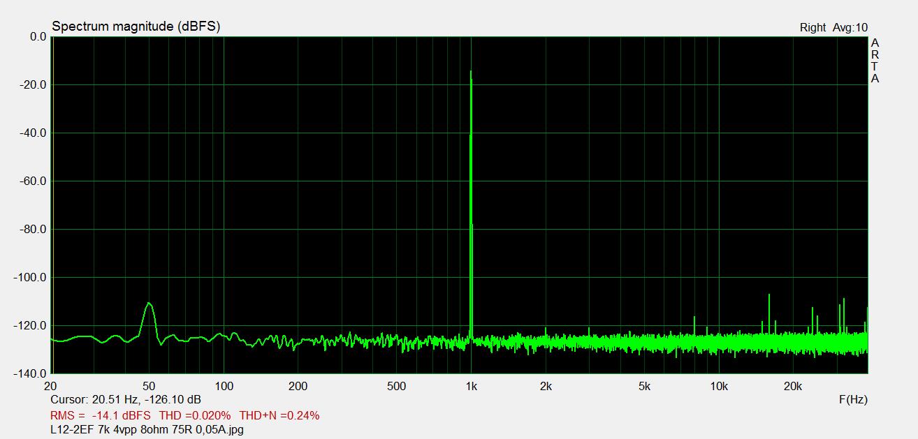

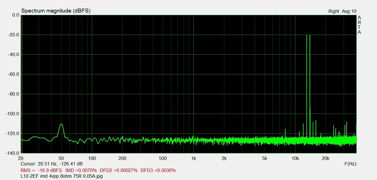

Rallyfinnen 20th September 2020 07:11 AM
I have some trouble with the bias adjustment, have to check that.. Current gets too high when I increase voltage, can't adjust it low enough even if trimpot is set to 0..
Rallyfinnen 23rd September 2020 07:34 AM
2 Attachment(s)
I got one modified board up and running. Only running one output pair at the moment and low output power (which I think is more significant). I tried 120 and 75 ohms as emitter resistor for the drivers, and there was a big difference in what Iq was needed to get good distortion. I did not see such a difference in the simulation. Now the Iq is around 50mA. Seems stable too. I get ringing with a cap across the output and square wave in, but it's damped. No LR on output.
Looks promising I think.
EDIT: broke a lead to the load resistor while replacing the emitter resistor to the drivers, so now I need to up the Iq again to get low distortion.
