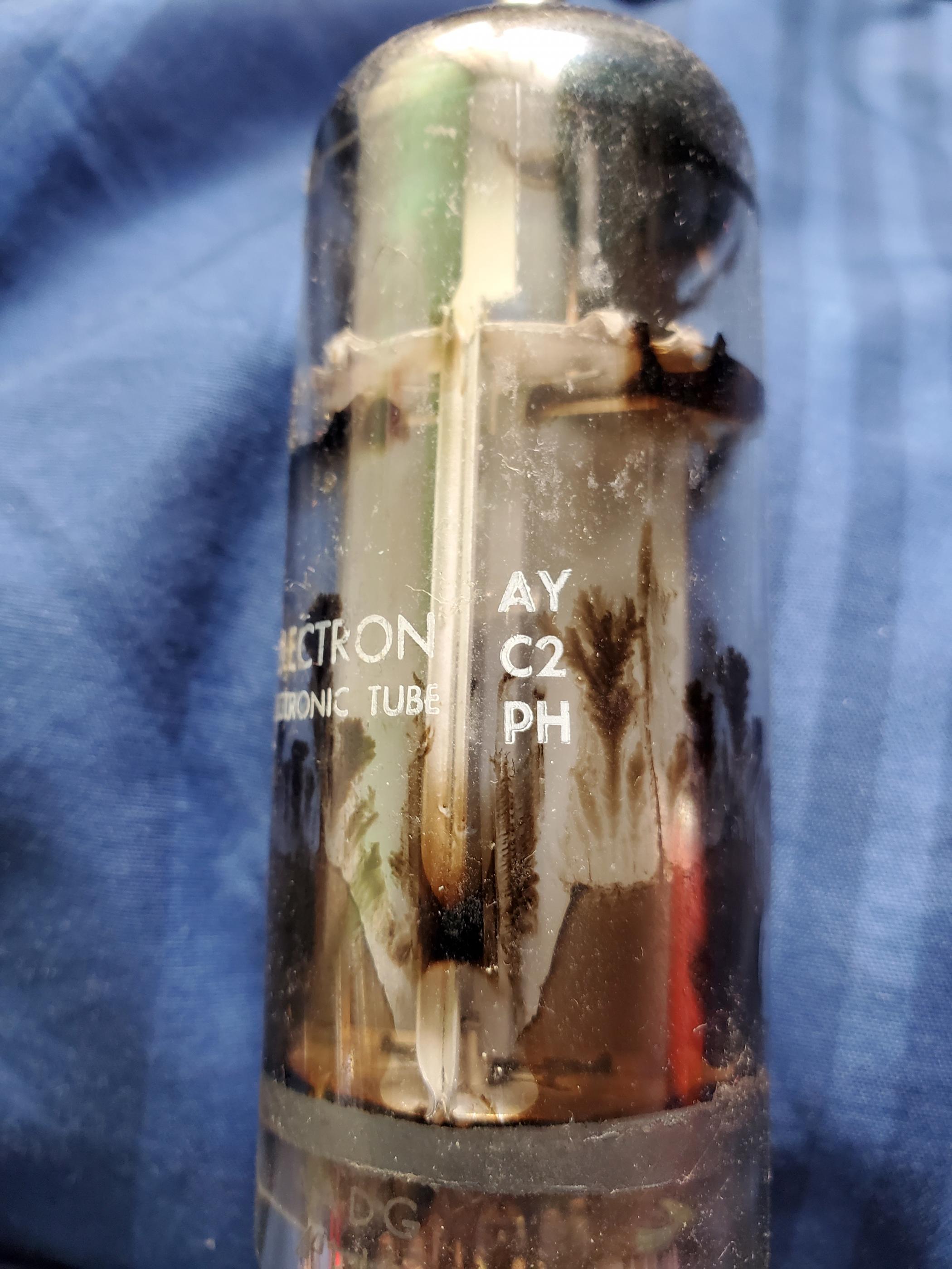

Hello
I have a question and maybe a favor to ask
Who here uses or had any tv tubes ?
Donít some tube amps use tv tubes ?
Reason why am asking for some free ( donated ) TV tubes, is I acquired a mint ,technicians vacuum tube rejuvenator , for TV tubes. And is like to give it a try to see how it works.
Itís made by B&K , model 465 CRT tester
So if anyone can help, I would really appreciate it. Please send me a message or post openly about your knowledge involving TV vacuum tubes in an audio circuit of amplifiers
Attachment 875765
Attachment 875766
Attachment 875767
Attachment 875768

Why Iím asking is in the manual it states that it can refresh tubes and bring them back up to specs
H713 14th September 2020 08:02 AM
Yes, it can do some amount of "rejuvenating" of CRTs. It won't work with sweep tubes or other tubes that would be useful in an audio amp.

Thats an early version of the BK tube tester for B/W TV,s I have the later multiplex automatic version with three dials for color TV.
It uses pulse techniques that overcome the manual overzealous stripping of the cathode of TV CRT therebye rendering the tube as useless .
I know what the big question here will be -can it renovate a big output pentode IF you modify the connections --answer ----yes with a big stipulation ---once you try it once and the cathode is so rotten to begin with and you don't see a rise in emission------DO NOT TRY IT AGAIN !!
You have been warned !
Do NOT leave it running for long its a amplifier tube you are renovating not a CRT cathode.
