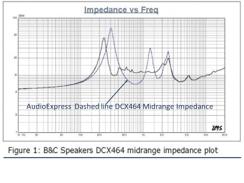

LineSource 19th September 2020 02:23 AM
1 Attachment(s)
"And why wouldn't B&C fix this before if its beneficial?"
Adding a copper ring in the motor typically smooths the impedance plus extends and smooths high frequency. Dimishing returns from this type of investment is more important to home perfection audio than higher sales volume ProAudio customers.
The AudioExpress magazine impedance measurements of the 16-ohm version(12-ohm nominal) midrange varies from 5-ohms to 50-ohms, with 3 large peaks and rising with high frequency. The frequency measurements show two humps in the crossover region from 3,000-6,000Hz. I was hoping to use passive 1st order C & L crossovers. Posted 2nd and 3rd order circuits are commonly used.
To Dream the Impossible Dream... an audio point source covering 400-20kHz with both smooth frequency response and smooth phase response. Medical research on human hearing warns about multi-driver speakers having the harmonics out of phase from the fundamental.
cowanaudio 19th September 2020 08:09 AM
You won't get anywhere close to smooth amplitude and phase response with a first order filter with these drivers. A well behaved passive crossover is pretty complex.
400Hz is the easy bit, they can go lower in a domestic environment.
Any references to read about "Medical research on human hearing warns about multi-driver speakers having the harmonics out of phase from the fundamental."? My experiments have shown the human ear is pretty insensitive to smooth phase rotation throughout the frequency spectrum.
