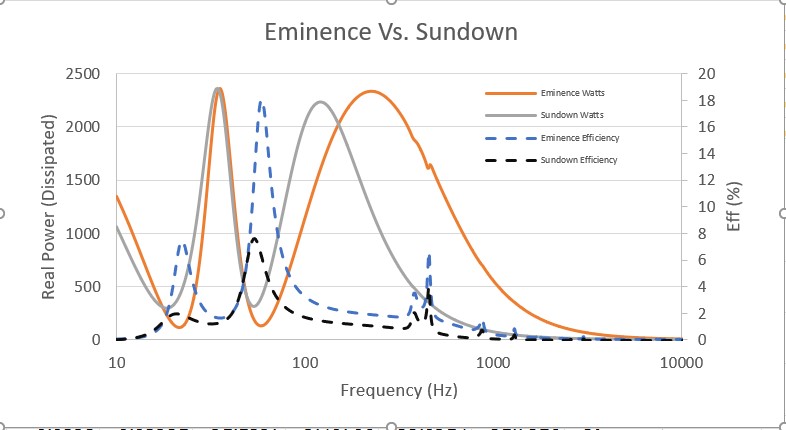

So, let's compare the output of two SA-18s vs ONE NSW4018 in the same box.
Note that a pair of SA-18s will set you back $700 while a single NSW4018 will cost you $580.
Here's the frequency response and displacement of ONE NSW4018 vs TWO SA-18s. The box is identical, the watts are identical.
Thought the Eminence is 9dB more efficient than the Sundown, the output at low frequency is basically identical, as one would expect. (Hoffmans Iron Law.)
There's a VERY noticeable efficiency advantage above 100Hz. The Eminence is much more efficient above 100Hz. But this is consistent with what I've proposed:
Subwoofer efficiency is mostly irrelevant.
If you want your woofer to play to 1khz or 2khz, you definitely want to examine the efficiency spec. But at 60hz? It doesn't really matter, for the most part.
One of the reasons that the Eminence is so much more efficient at 1khz his because the Sundown has a lot of inductance. Scott Hinson writes a lot of great stuff, and he observed that car audio subs often have higher distortion. I'd agree with him; the Sundown will likely have higher distortion than the Eminence. Non linear inductance leads to distortion, and considering the very high inductance of the Sundown, I'm willing to bet that it has higher non-linear inductance than the Eminence.
In Sundown's defense, keep in mind that distortion and excursion are generally correlated. IE, if your subwoofers are using up their xmax, you're likely to hear distortion.
Sundown has an advantage here: because it works in a box that's half as large, you can use two. And because you can use two, each woofer is only traveling half as far. This lowers distortion.
So there you have it:
The response shape of the two solutions is virtually identical below 80Hz. The Eminence is flatter, but only by about 1.5dB, which isn't going to be audible.

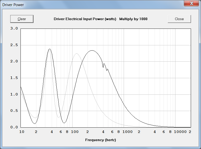

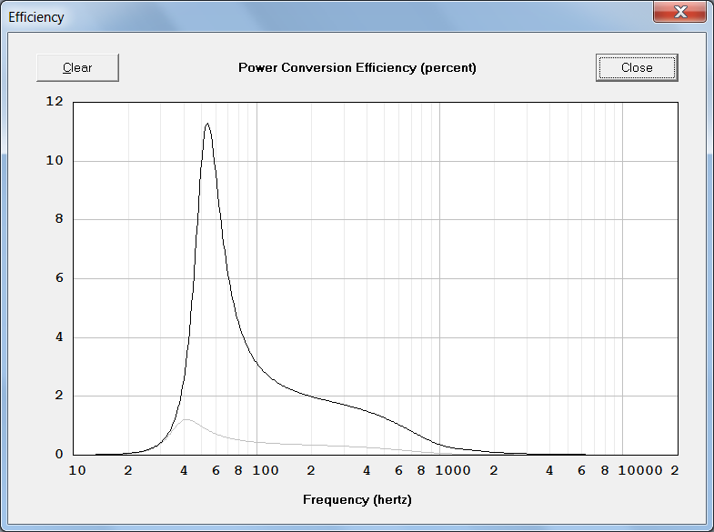

Here's the output of TWO Sundown SA-18s vs a single Eminence NSW4018 in the same box. So the box volume and the tuning is absolutely identical.
The output is basically identical because Hoffman's Iron Law.
IE, subwoofer sensitivity is basically irrelevant.
In this simulation, you'll notice the response curve for the Sundown is much better. This is because the specs on the Sundown have improved. If I'm not mistaken, Sundown bought a Klippel a few years ago and it looks like they're using it. The older SA18 had much higher QTS which led to a lumpy response. The older model was more suited to a sealed or bandpass box.
Here's the displacement. The Sundown has half the excursion because there's two drivers.

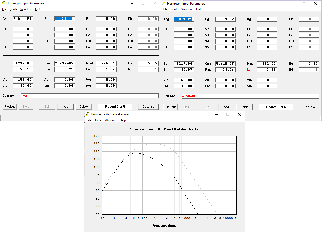

Here's the input to Hornresp. Note that the power is set to 2400 watts into their respective loads. The Sundown is 7.94 ohms. That's a DVC 2 ohm driver with the voice coils wired in series, and then the two drivers wired in series. The Eminence is a single voice coil and it's getting 2400 watts into a 5.85 ohm load.

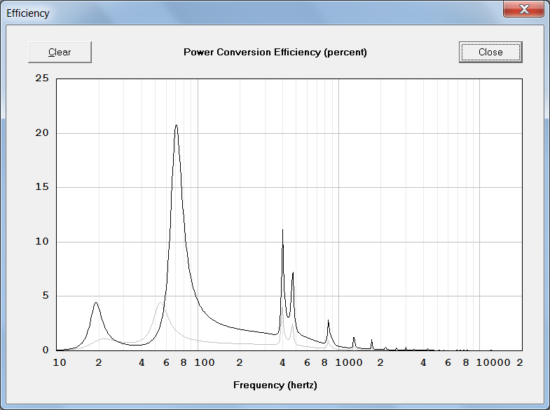

Here's wbat you get when you do a fair comparison. I used your t/s but turned on lossy inductance for the Sundown because I don't have semi inductance parameters and you really do need to account for it or your sim isn't close to reality with this type of driver. Both drivers are fed 100 watts calculated based on their Re. Both boxes are the same size.
Also I put them in a sealed box because the port just unnecessarily complicates things.
Like I said, when you compare apples to apples the result is pretty similar as expected. Through the entire subwoofer range the response is very similar up until the Sundown's inductance starts to pull the high frequencies down.
This illustrates your point exactly. The published sensitivity spec, which is usually measured up around 1khz has nothing whatsoever to do with how the sub will perform at subwoofer frequencies because the box dominates.
