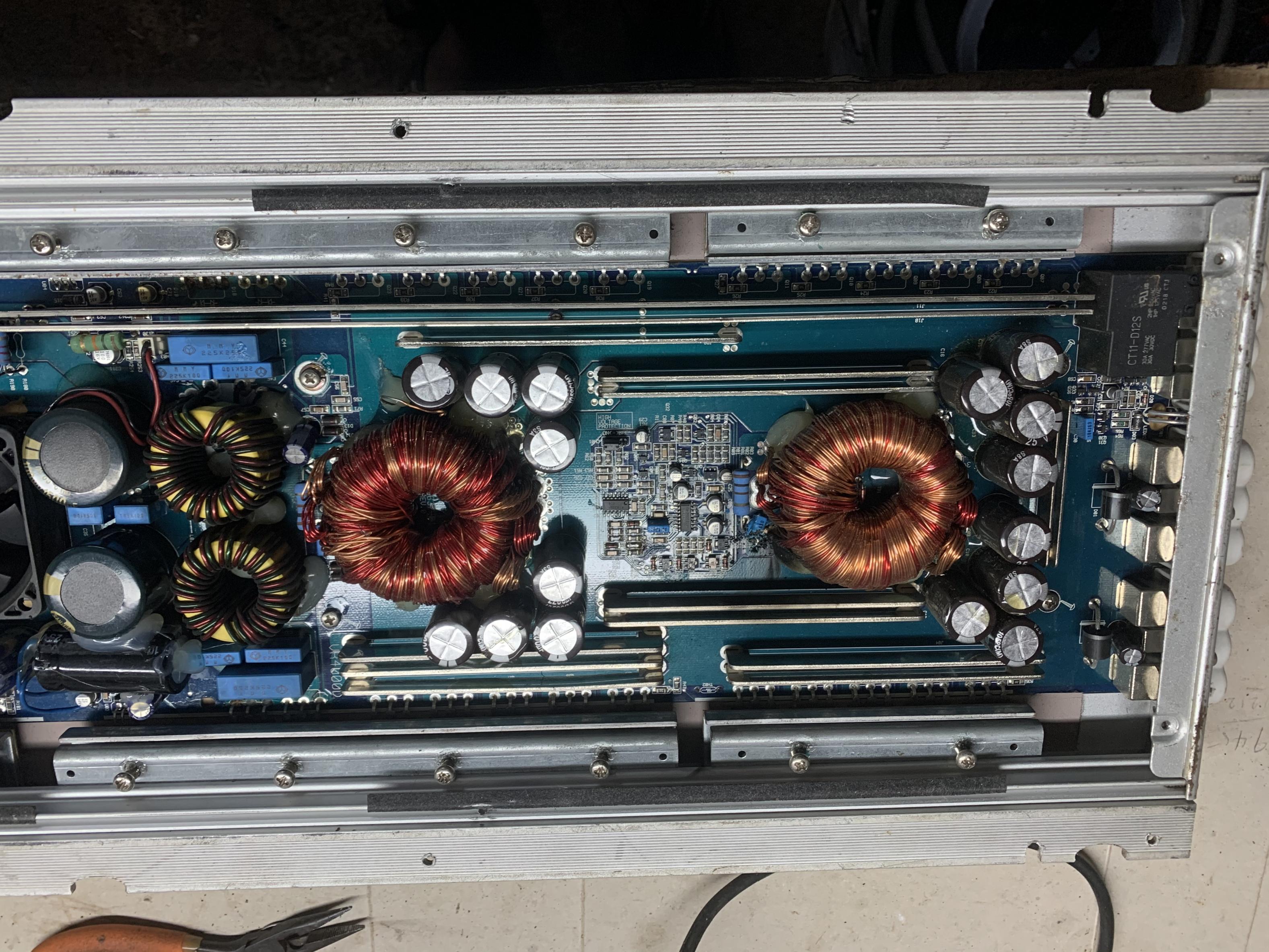

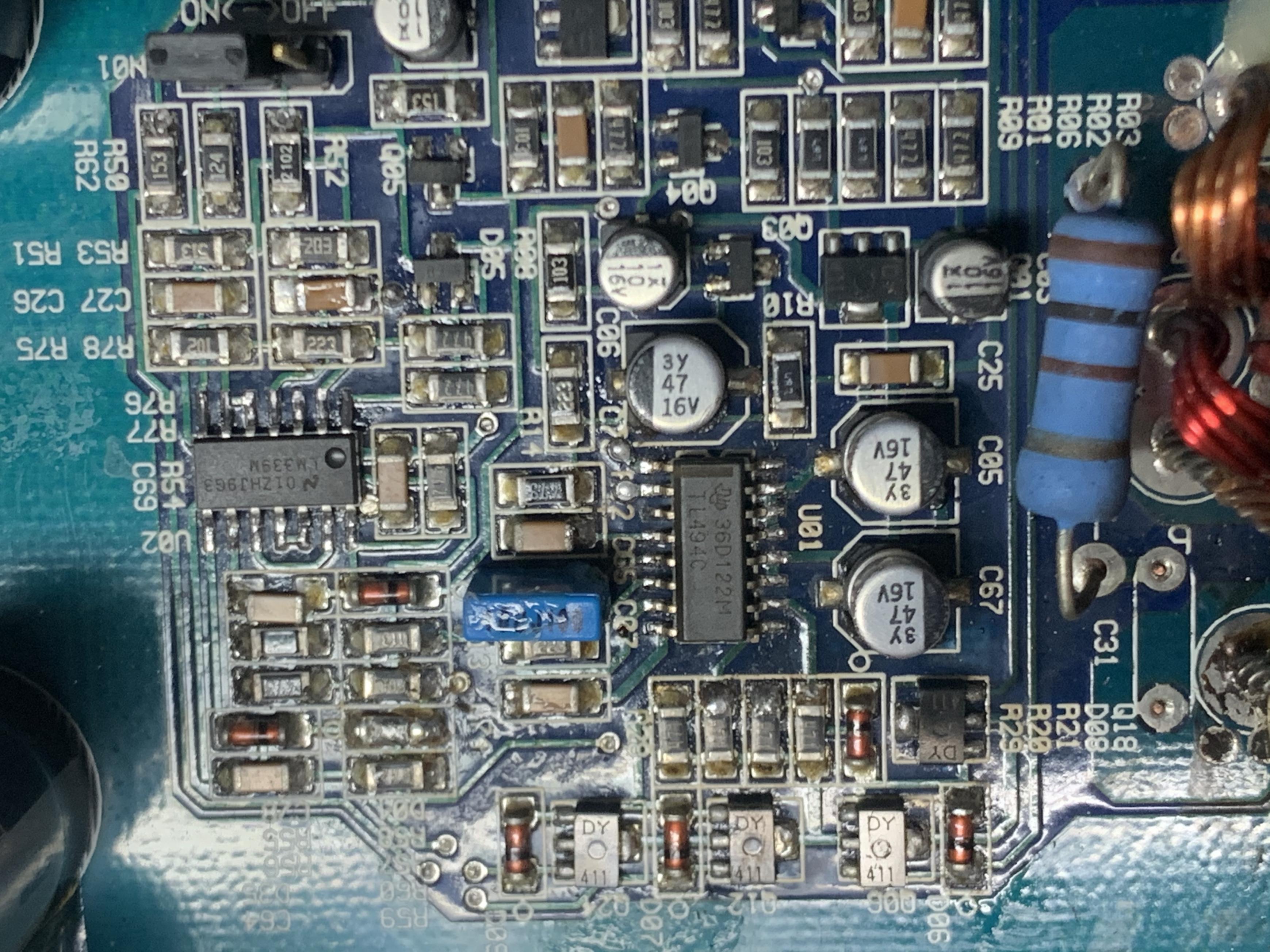

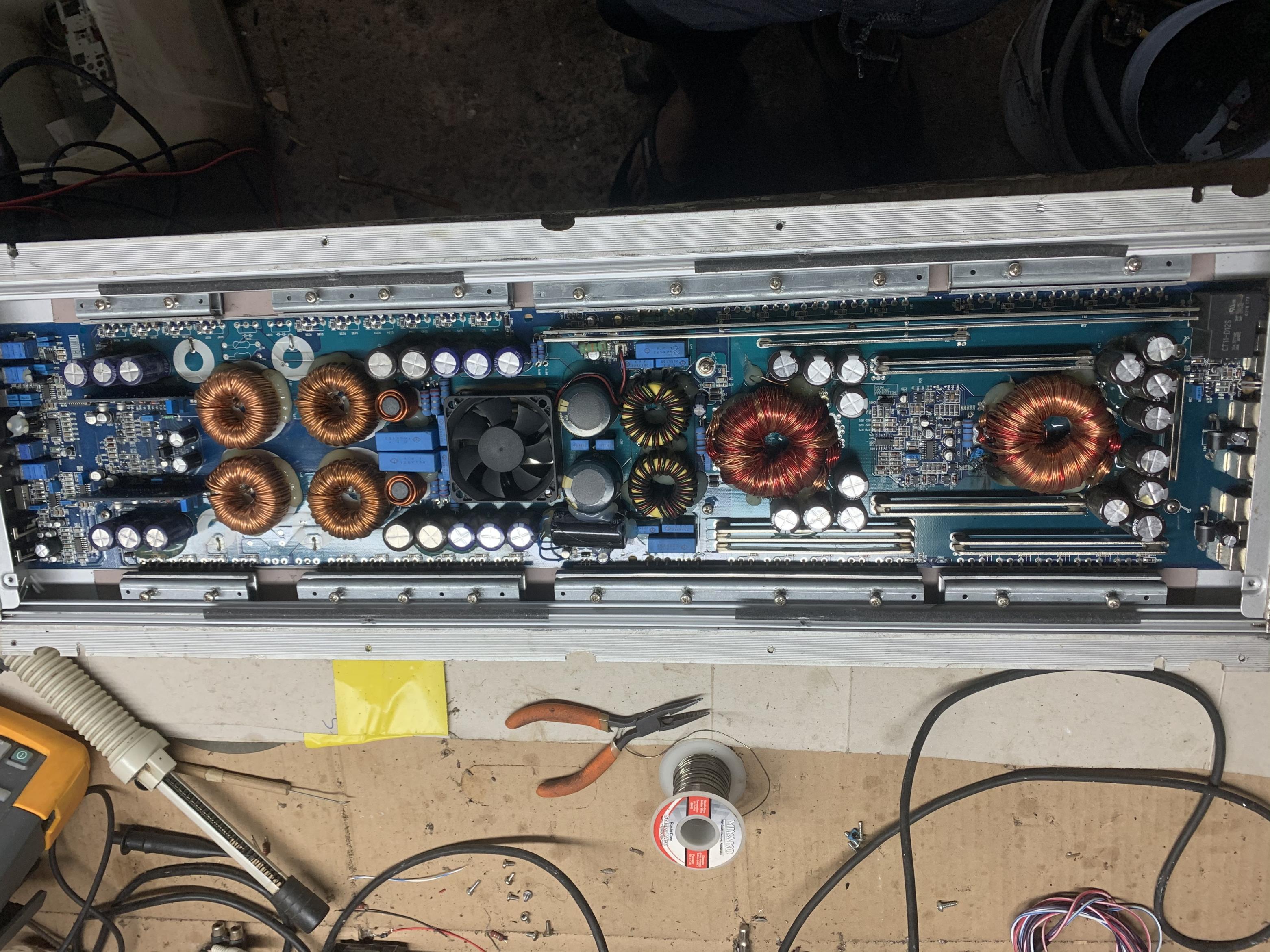

Got in a crossfire vr4000d in protect. No shorted FETs, I’m working through the power supply I found some shorted drivers. I can’t seem to find info on these, anyone got correct numbers, or subs?

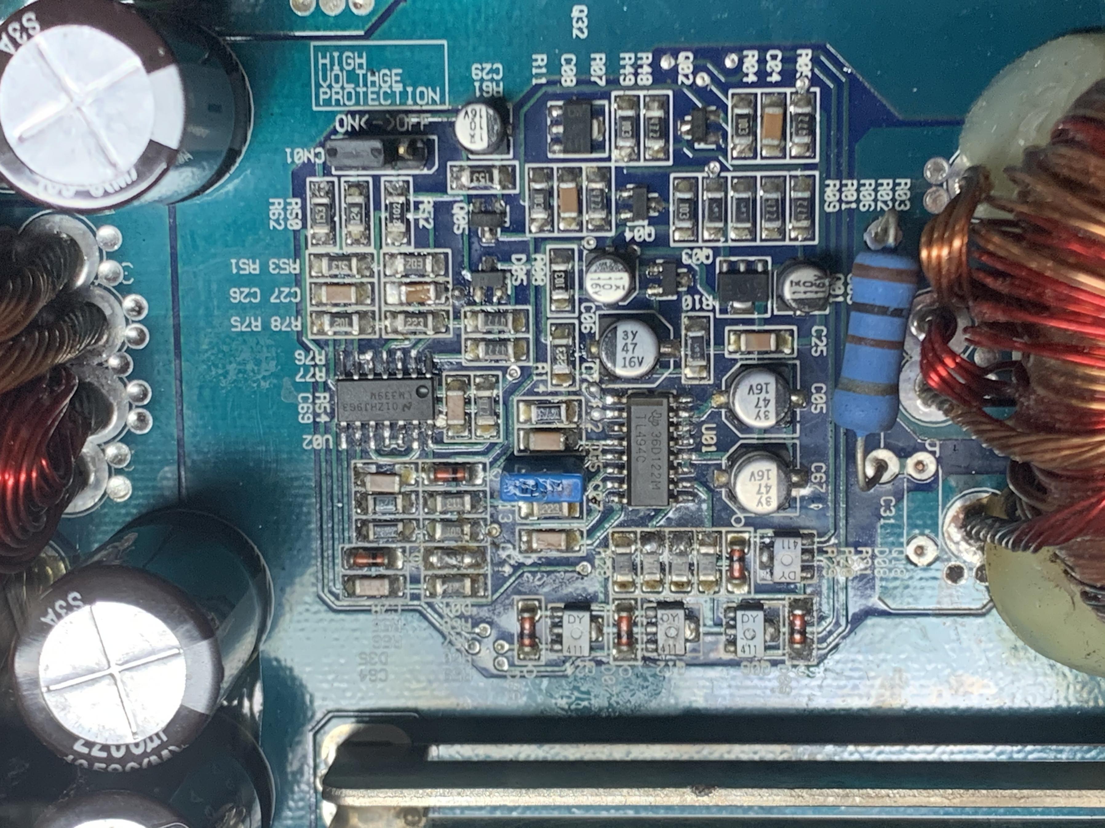

I’ve attached a pic of the PS control Section, it seems pin 3 of the 494 is not connected/being used as an input.
Looking back at the dc voltages of the 339 it seems I have other faults.
When the amp came in it had c31 blown apart. I believe this to be a snubber on the secondary side of the transformer and not affect the troubleshooting, I have not sourced or replaced this to this point.

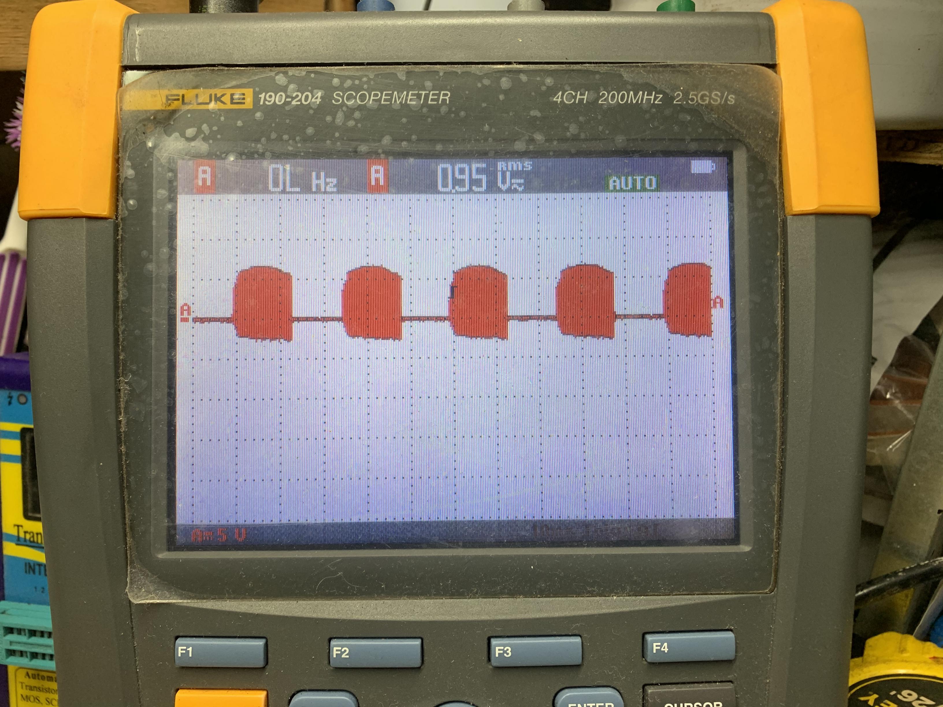

Hold on, I think I have something happening on the drive circuitry. With pin 9 and 10 out the circuit, I have square waves.
Reviewing pins 1 and 2, I should be getting output, I lifted 9 and 10 and I have square waves on both.
Do you know of other replacements for the DY 411? I got some surface mount diodes around those transistors, they’re testing good but Incase I do find something.
