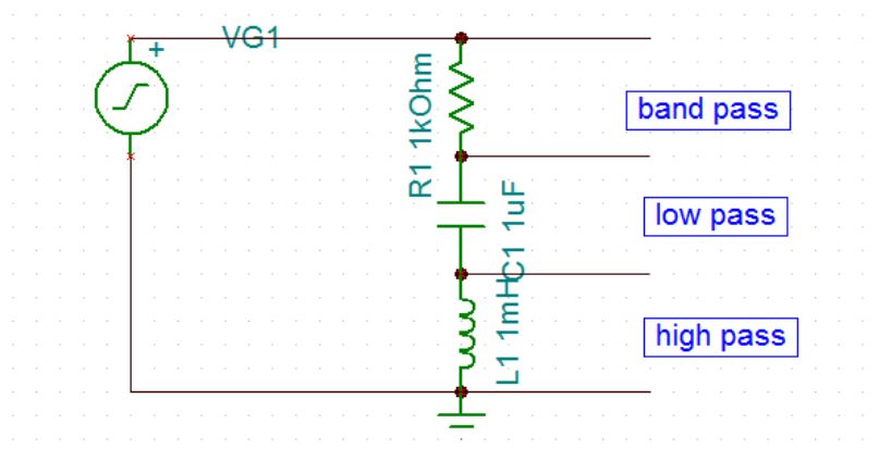

When you use a low pass and high pass as crossover, the band pass gets missing to make the total sound. The higher is the order, the smaller is the band pass hence less sound loss.

What do you want to prove with this series resonant circuit - which is not at all representative of a crossover ? To start with: It takes no power at very low and very high frequencies which is far from what a speaker with crossover does.
If you had a load over each reactive element but no series resistor then you would indeed have a series crossover.
