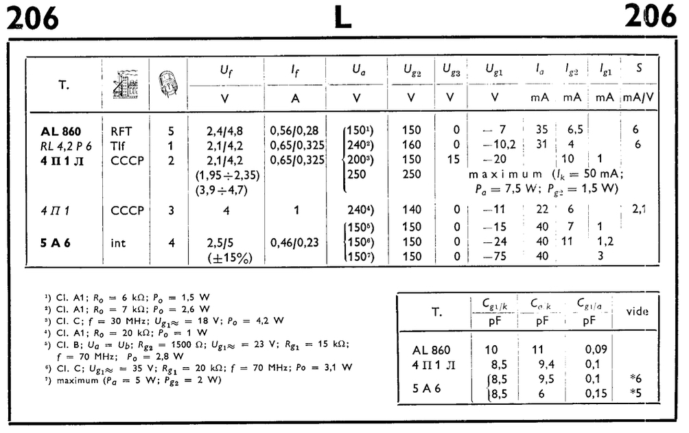

I know the 4P1L is quite popular wired as a triode and is typically used in PSE (parallel single-ended) configurations using OTs with ~3k primaries. The 12P17L seems to be very similar, other than being indirectly heated. So I assume the answers would apply to both tubes.
So, two questions:
What primary would be suitable for PP with tubes wired as pentodes?
What primary would be suitable for PP with tubes wired as triodes?
Here's the data sheet for the 4P1L, which is the third tube listed. It seems that footnotes 1, 2 and 3 apply and that in Class A1 (a single tube in, I assume, pentode) the tube produces 1.5w with a 6k load and 2.6w with a 7k load. But there's no info on PP operation.
The data sheet for the 12P17L doesn't seem to list any info at all regarding proper loads or power output.
