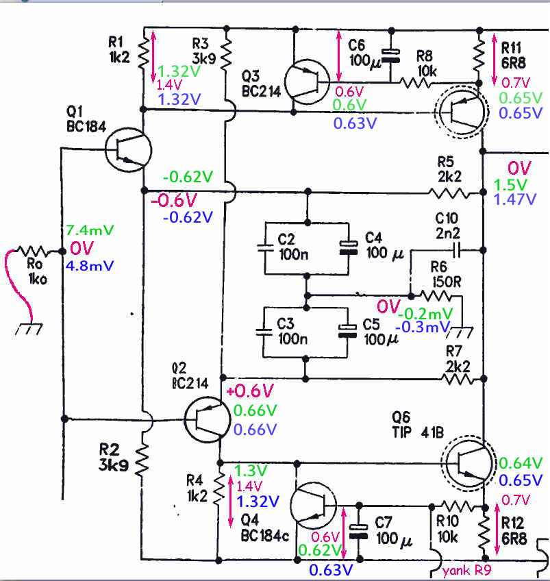

Testing ciruit
Thanks PRR.But before I start what do you mean by Yank R9?
Yank R9. Ground the input. Measure all the key voltages. I've sketched approximate guesses. Yours would be similar, but I expect you will find one/some WAY off. Crayon your readings and post back.
Measurements compared to ideal
Here are the measurements taken for comparison.The Green are one channel and the blue are the other one.They seem to be pretty close.I don't know whether the 1.5V and 1.47V DC offset at the output is reasonable?If so strange that I couldn't adjust this to lower than 0.77V and 0.69V with the trimpots before temporarily removing the resistors for testing.
Thanks for the detailed measurements. Something is not balanced but I don't see what. I asked The Idiot to help. First crack gave +0.8V output offset, reasonably close to your observation. So the thing is not inherently zero-centered. And there are some large unbalances. Since my simulated resistors are "exact", the only cause is the inherent difference between NPN and PNP (of similar die-size), which these models obey (a bit too well).
There is a conflict. As Rama observes, Q5 Q6 "must" pass the same current because they are series and there should be no stray DC out of that path. However Q3 Q4 also force Q5 Q6 currents, and not-the-same because Q5 Q6 can not (practically) be exact-matched for both Vbe and hFE.
I added-back the offset trim. It can swing over +/-2.5V at the output. So to get say 10mV offset you have to trim to one part in 500. This is incredibly fine adjustment for a single-turn pot. (Altho not that much finer than an AM radio which must be within 2kHz in a 1MHz band.) It seems that (for these sim parts) the feed to the 10k resistor should be 0.591V for near-zero output offset.
And yet you say it won't pull-in at any setting. Is the voltage *across* RV1 just about 1.44V? But even so, trimming all the way to the negative rail should cause a -negative- output offset, and you only have positive output??
I would wonder about replacing Q1 Q2 just as a mindless way to eliminate possible damage. The biasing should not require high-grade transistors, although hiss and other parameters may suggest types like the ones the Designer specified.
Someone said a long time ago, in the seventies: "NPN, PNP transistors are as truly matched as men and women of the same height and weight".
HiHere are the measurements taken for comparison.The Green are one channel and the blue are the other one.They seem to be pretty close.I don't know whether the 1.5V and 1.47V DC offset at the output is reasonable?If so strange that I couldn't adjust this to lower than 0.77V and 0.69V with the trimpots before temporarily removing the resistors for testing.

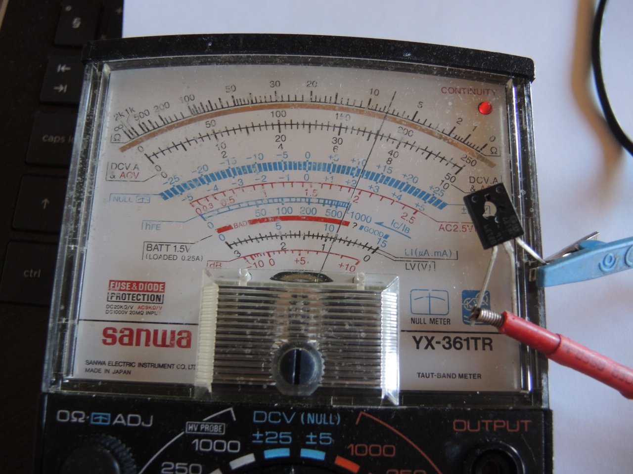

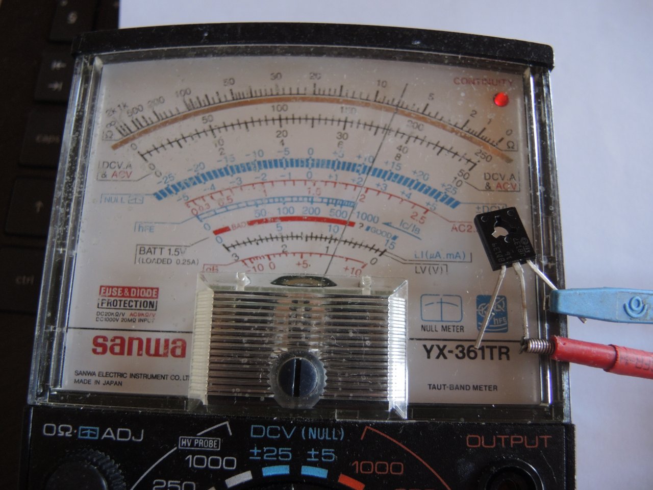

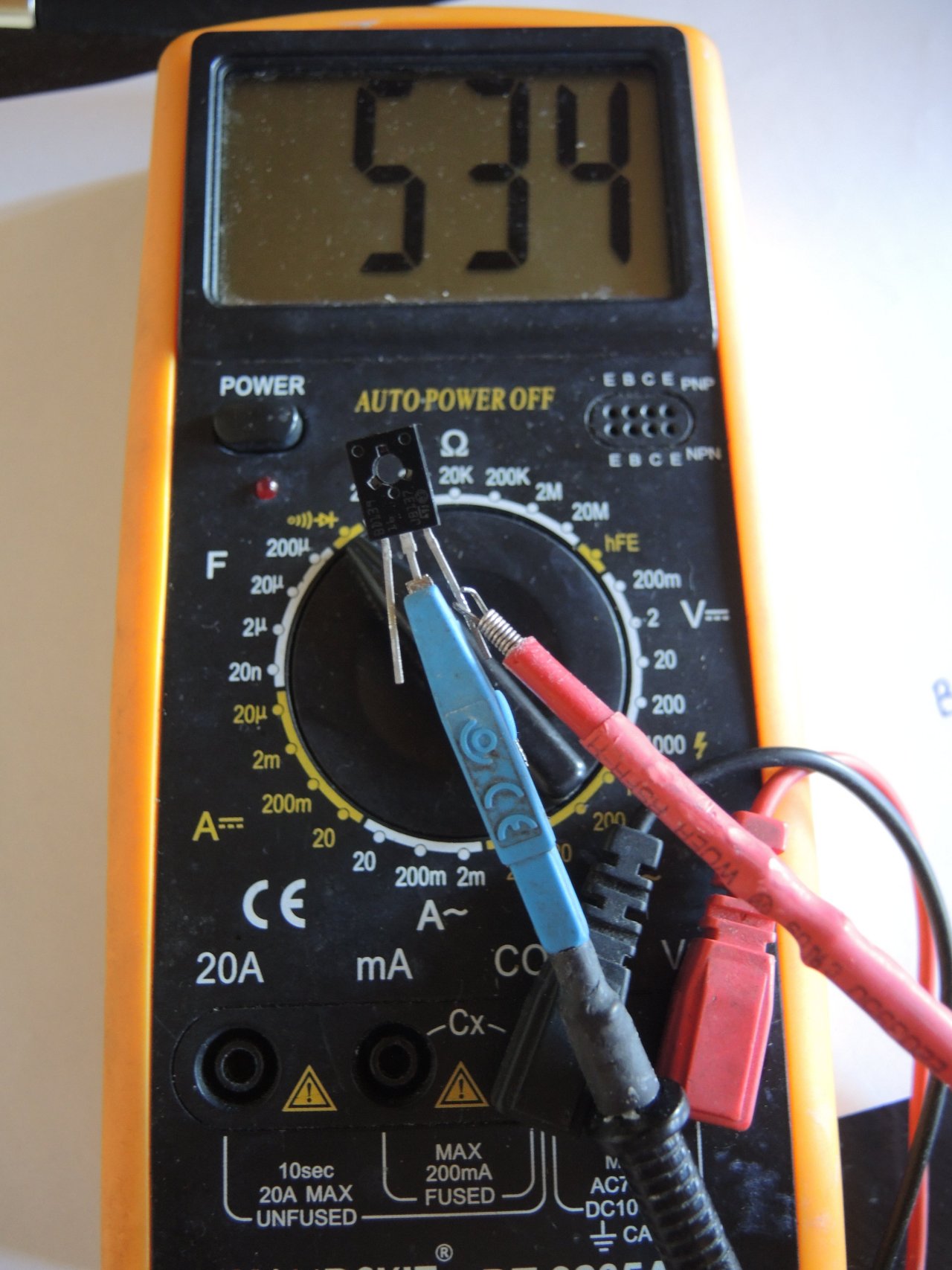

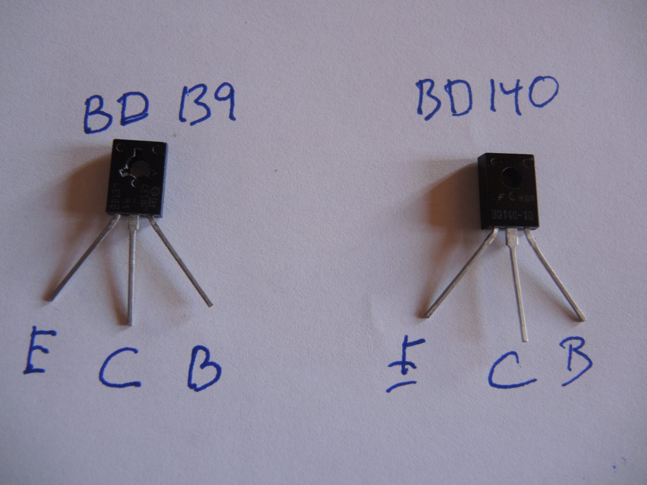

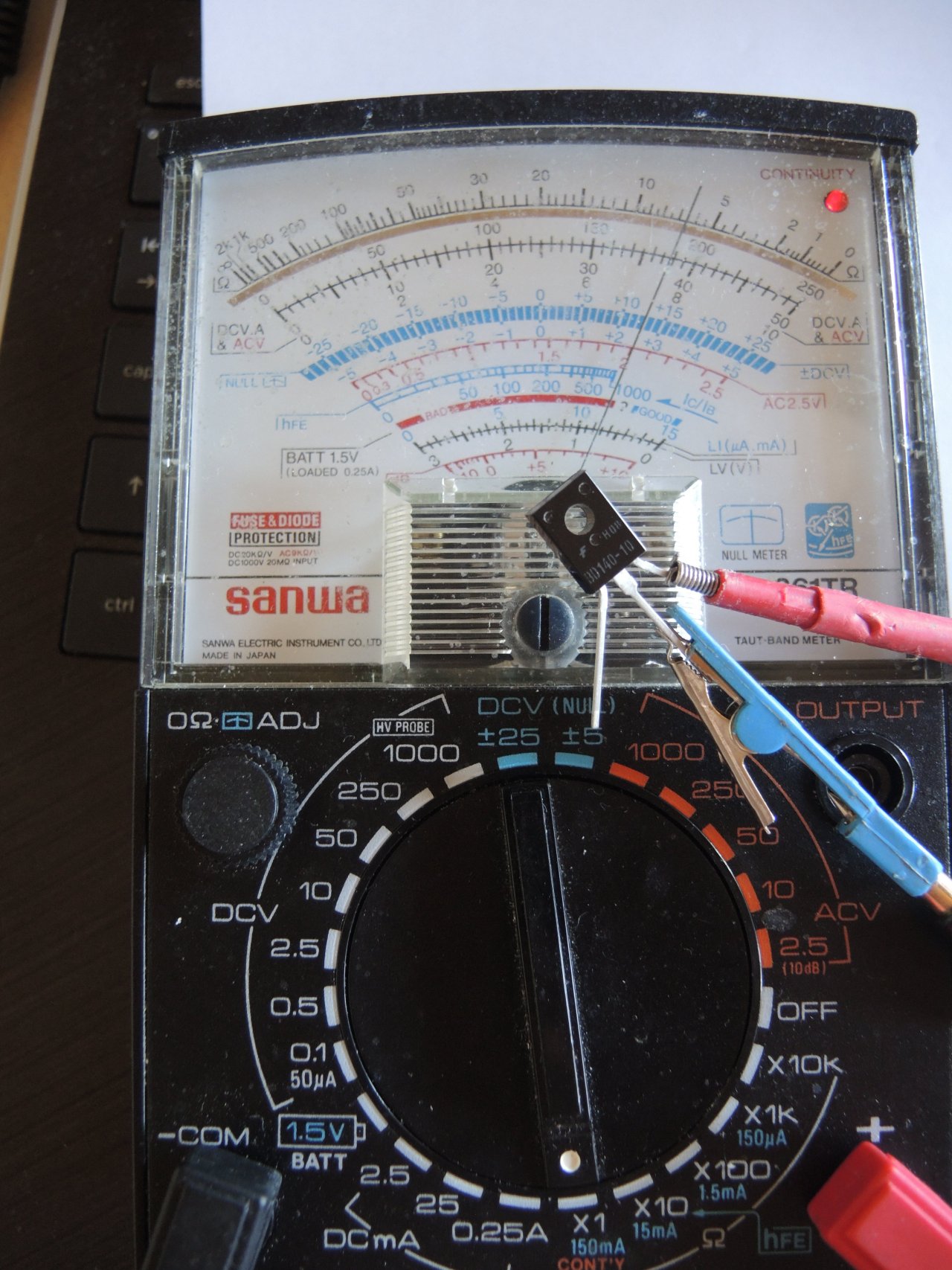

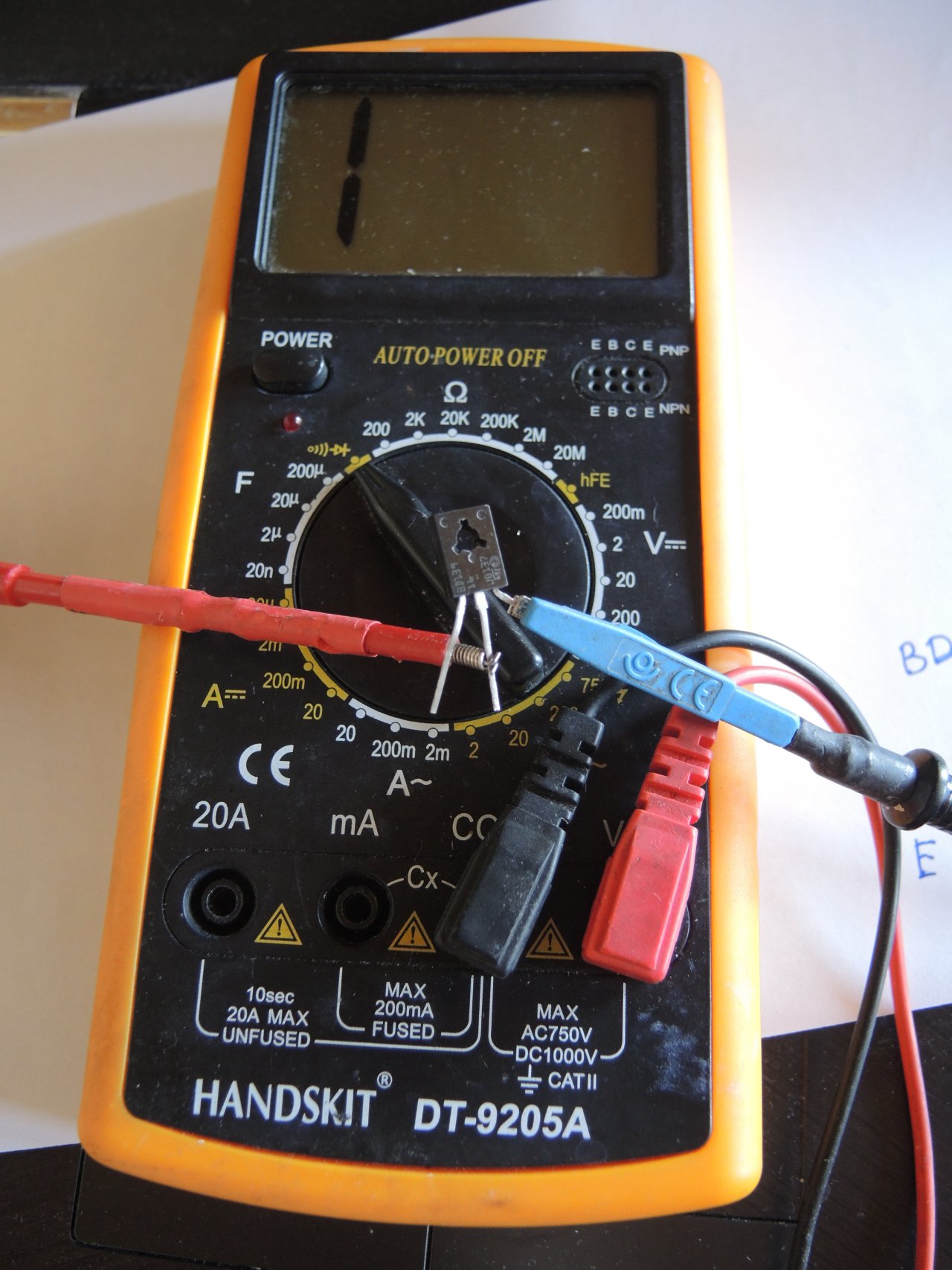

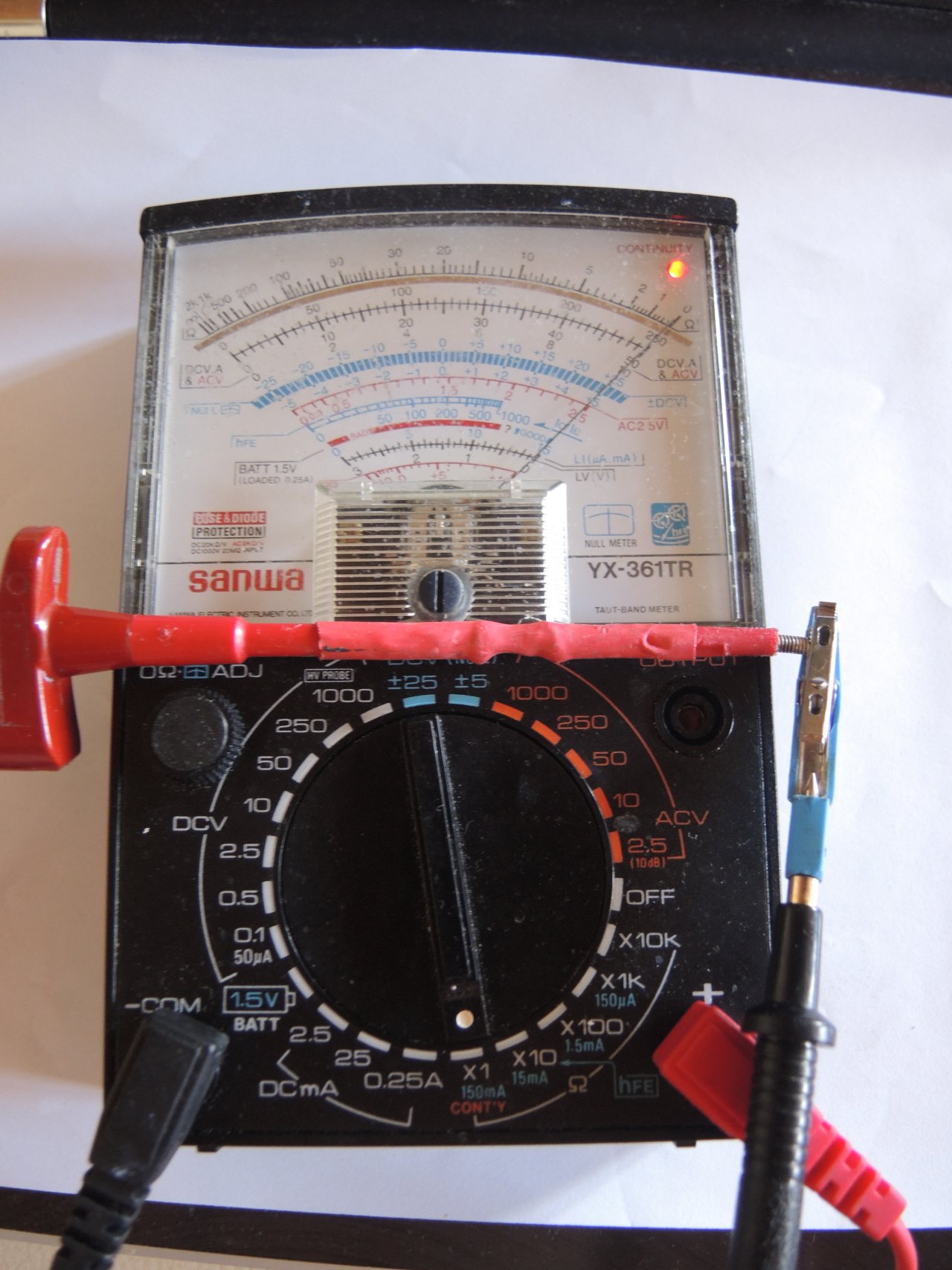

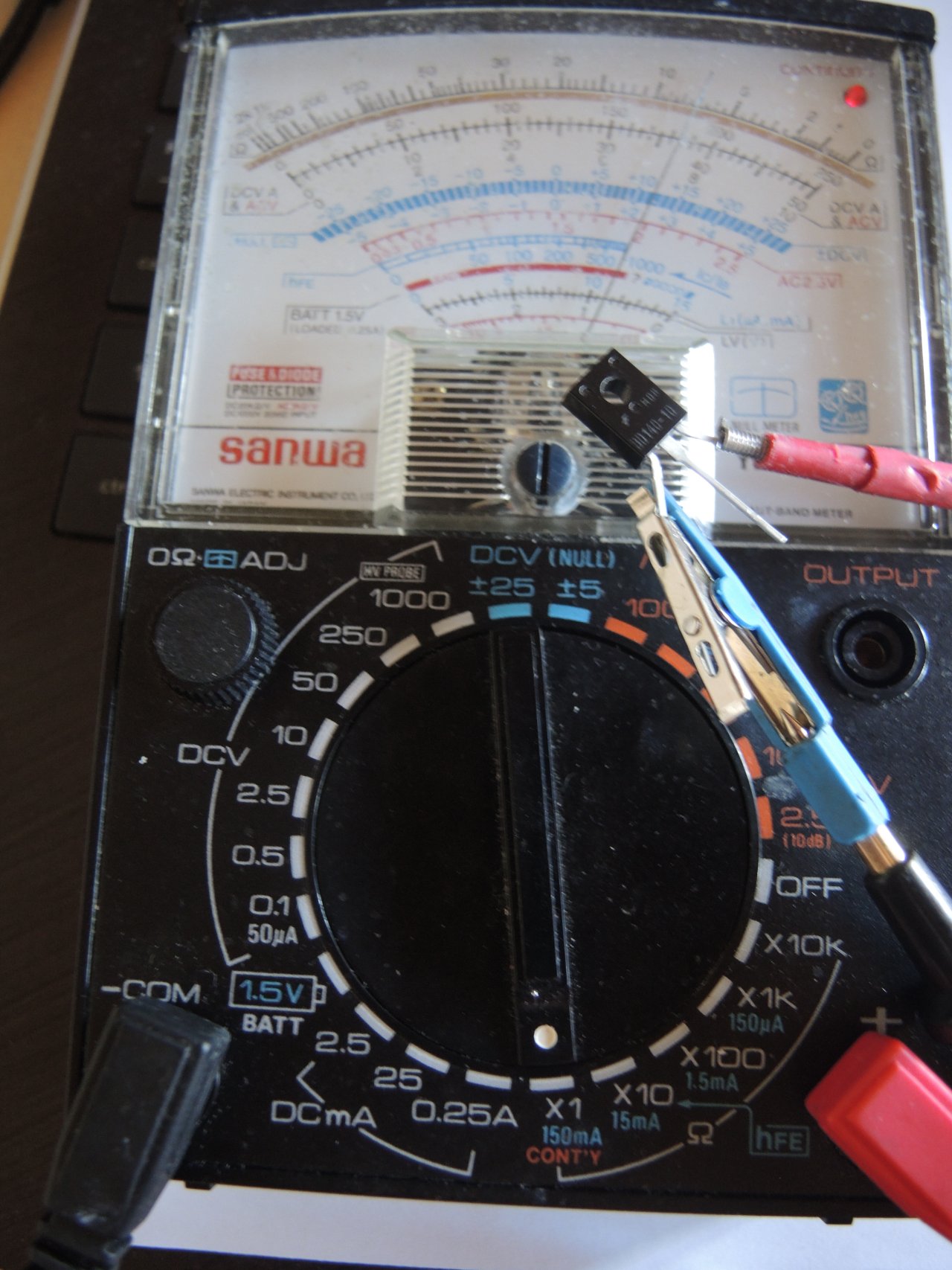

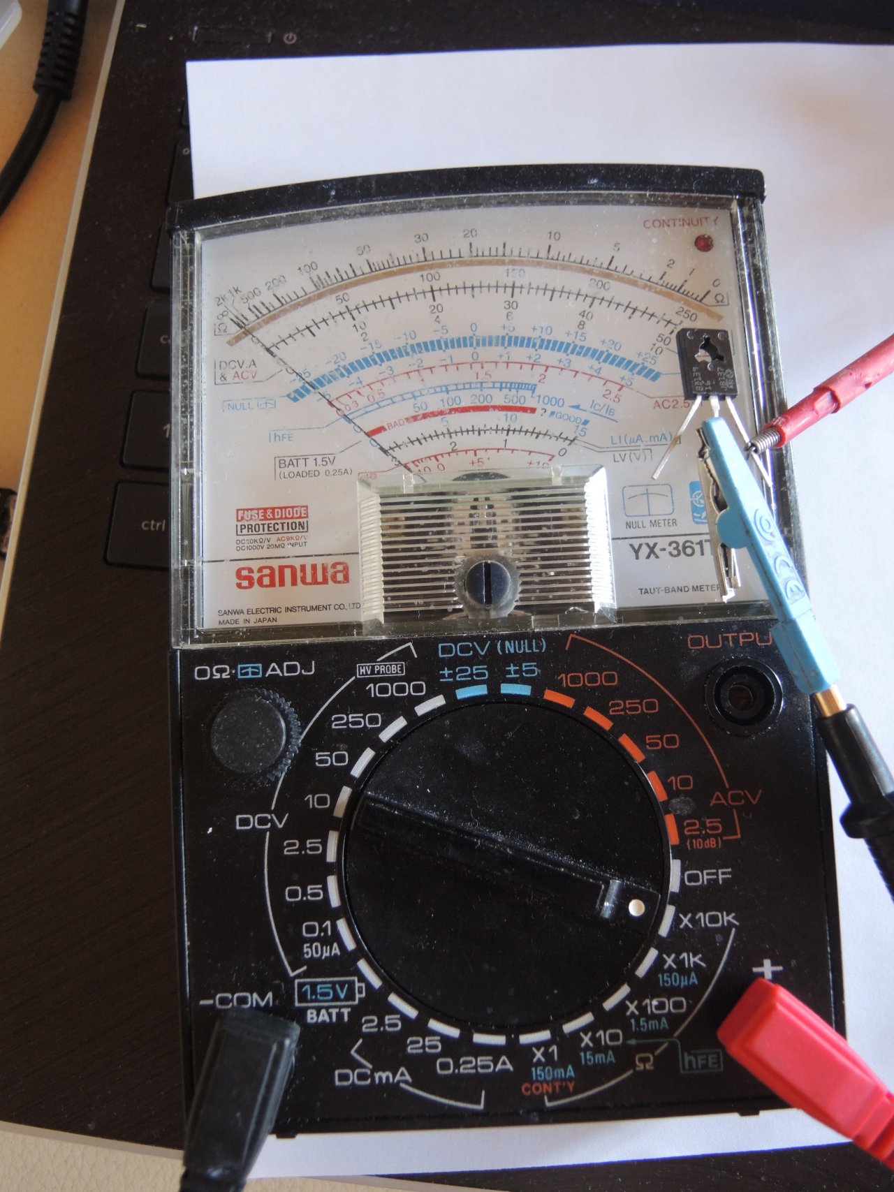

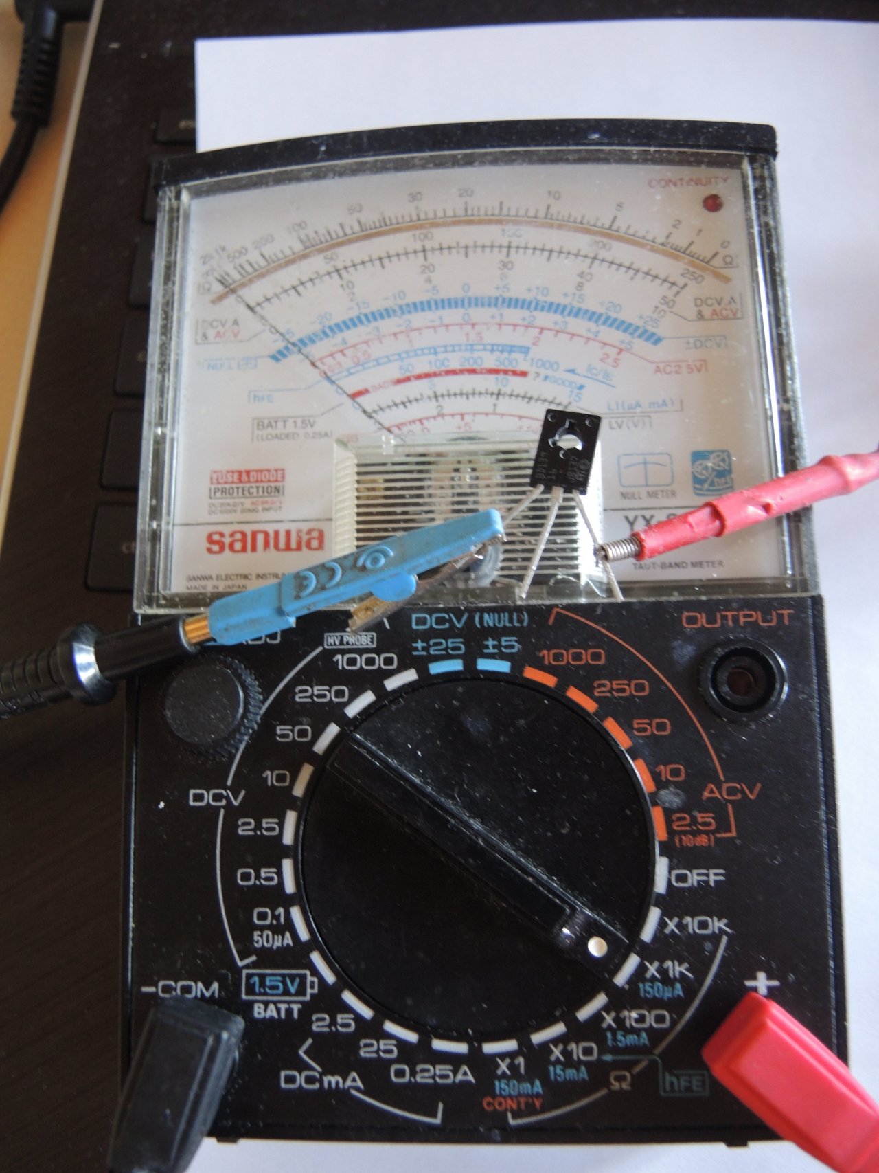

OK. to check BC184 and BC214 is very easy
Take if possible a analogue Multi-meter and set it to x1 OHM.
The Transistors I took is just to show how to measure.. The number is not important.This transistors have foot print TO-126
It's important that NPN and PNP must be measured with Reversed Probes to each other.. check out the pics. the same counts for Digital MM and Analogue MM
Put the measuring points of the probes together and let the needle go up all the way to O of the Scale. Adjust the needle to 0 OHM on the right side. Picture 1.
Now place the BLACK probe on BASE of the Transistor and the Red on either Emitter or Collector. Pic 2 & 3
Now the Meter should move about 3/4 to right side. the same for Base and Collector. If the needle goes up all the way then the Transistor is bad.
If not good so.
Reverse the Probes, so use the RED PROBE PIN on the BASE * you can check the DATASHEET of BC184 and bc214 which is BASE C and E. Most European Transistors if its TO92 then the base is in the middle.. if its To126 then Base is right, if it's T220 then Base is left. This from the front View where you can read the label of the Transistor.
If the needle goes up when measuring with REVERSE the BC184, for both measurements, meaning B-C B-E then you need to Measure E - C and C - E. the needle shouldn't move to the right side.. For the BC214 is to start with Red at the base because this is PNP..
If the needle of the Meter goes near the half of the way on the scale then you need to remove that transistor and measure it out of the circuit. And here is the point.
For BC184 reading good.. No REVERSE READING ALLOWED..See Picture 3&$ this is BD139 also NPN and take a look at the REVERSE PICS as well. If your reading differs of them when the Transistor is out of the PCB then the TRANSISTOR is DEAD or leaks. This measurement is to determine easy if the Transistor still is able to work, while in the PCB
B - C B - E black probe on BASE there the needle 3/4 of the scale OK
Red B - C B - E No movement allowed.. if the needle moves towards right then the Transistor leaks,.
I show you some pictures of Measuring Transistors with a analogue Multi-meter, also the same with a Digital Multi-meter.
Note: Probes for NPN Transistors to measure are reversed to DMM. when measuring a NPN Transistor with analogue then Black Probe goes to BASE using a Digital Multi-meter then RED PROBE goes to base. Reversed for PNPI I doubt that this is the Amp itself.. More likely your Power-supply because both channels showing to much offset. Of the HFE of the Exchanged Transistors are too high.
If not good so.

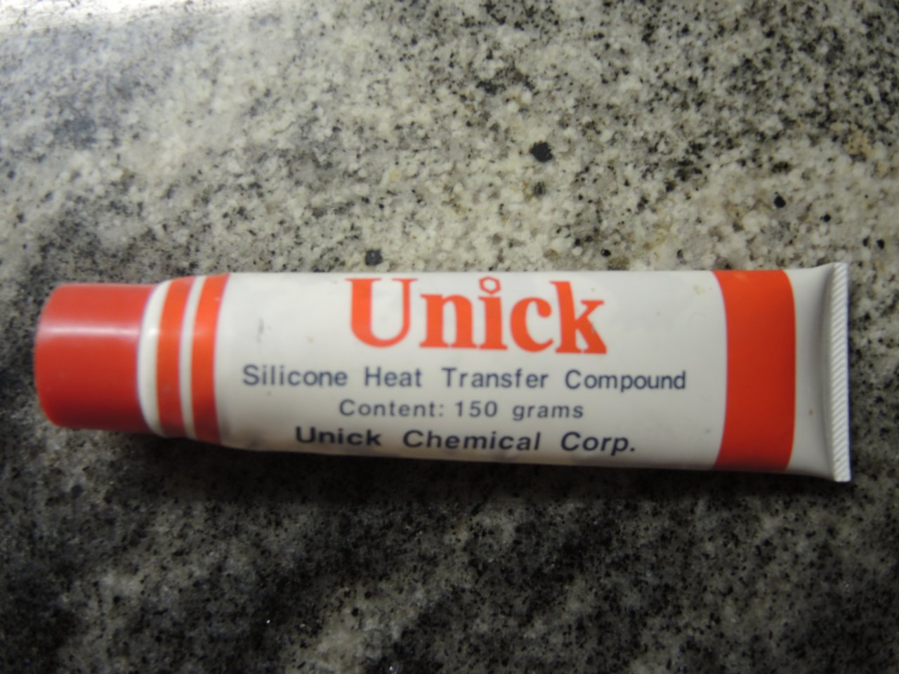

Just one observation:-I noticed it was taking a while for the heatsinks on the output transistors to become warm.Does this mean anything?How long before they should get hot?
I also re-checked the rails and they were just short of 15V:- about -14.75V for negative and +14.75 for positive rail so the Power Supply seems to be OK.
Quote:I noticed it was taking a while for the heatsinks on the output transistors to become warm.Does this mean anything?How long before they should get hot?
Is there any HEAT SINK COMPOUND ON the back of these Transistors? If not then get some Silicone Heat sink Compound.. it's better that those Rubber Pads for Class A,,
If heat sink is cold, then heat transfer is to slow and this will heat up the Transistor, and that can be a reason for the OFFSET.
You will need to apply a thin cover of Heat Transfer Compound on the back of the Transistors as well on the heat-sink. Then there should be a MICA and a washer to protect the Transistor against short to the Heat sink.. clean everything well and then apply also on the MICA both sides or on transistor and Heat-sink what comes easier for you..THIS IS A MUST..

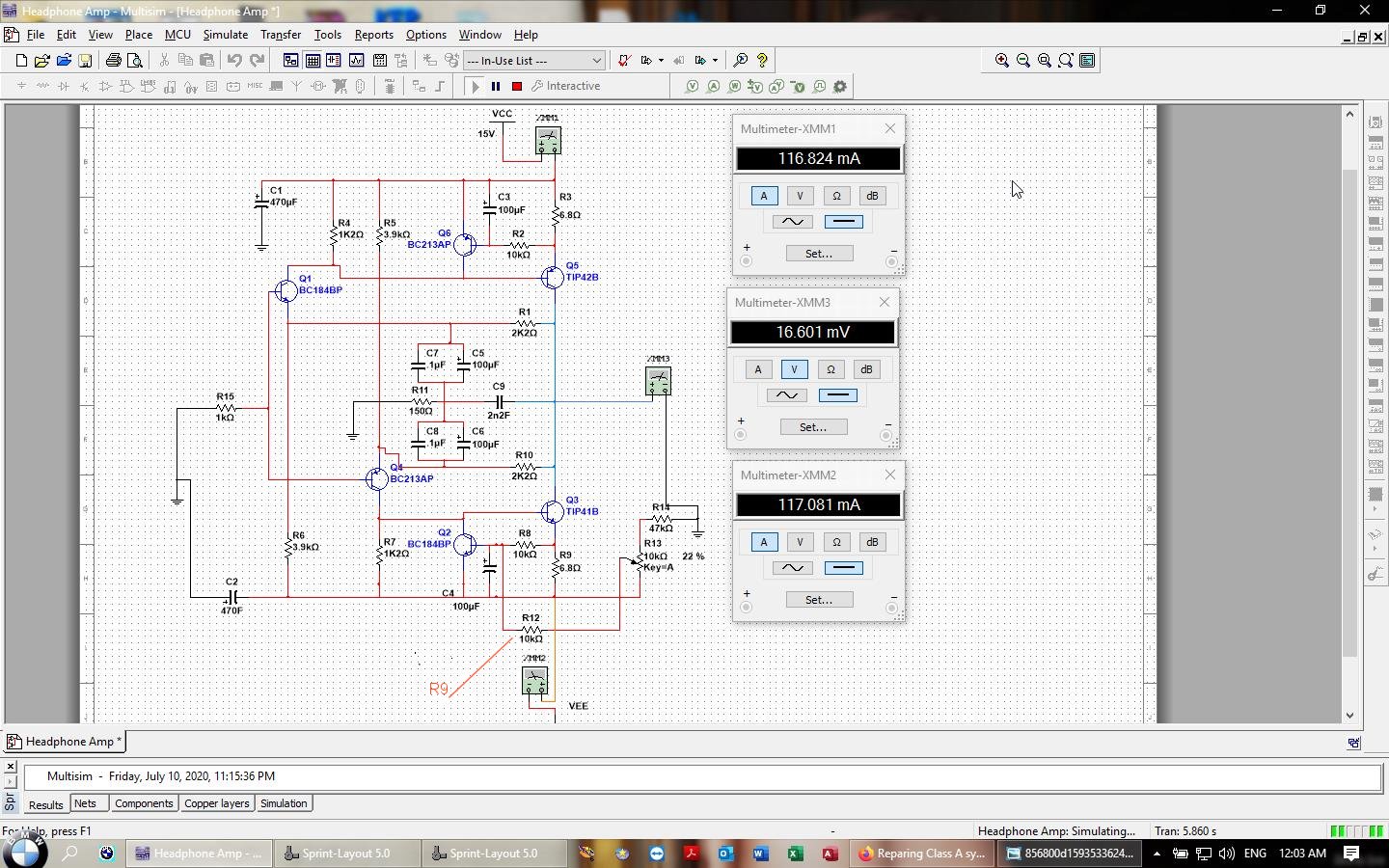

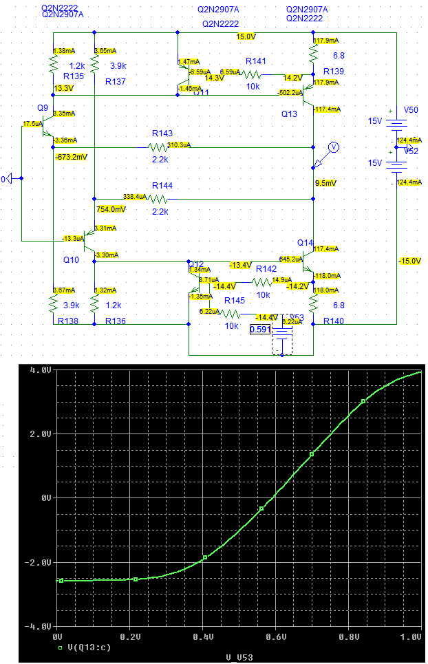

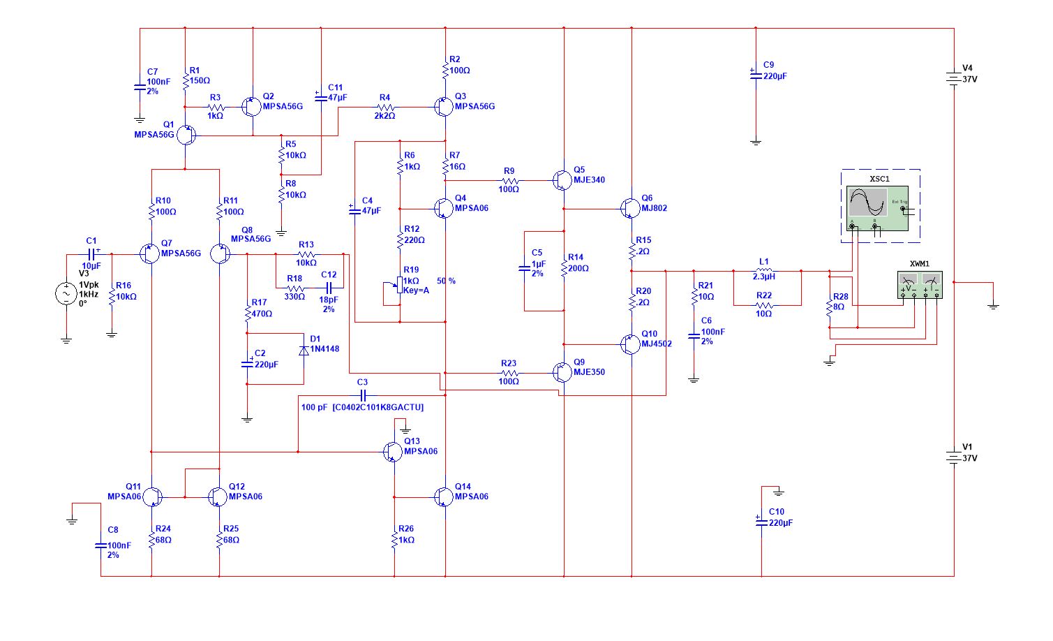

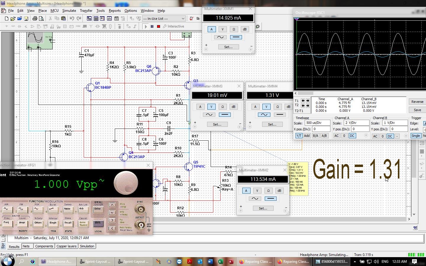

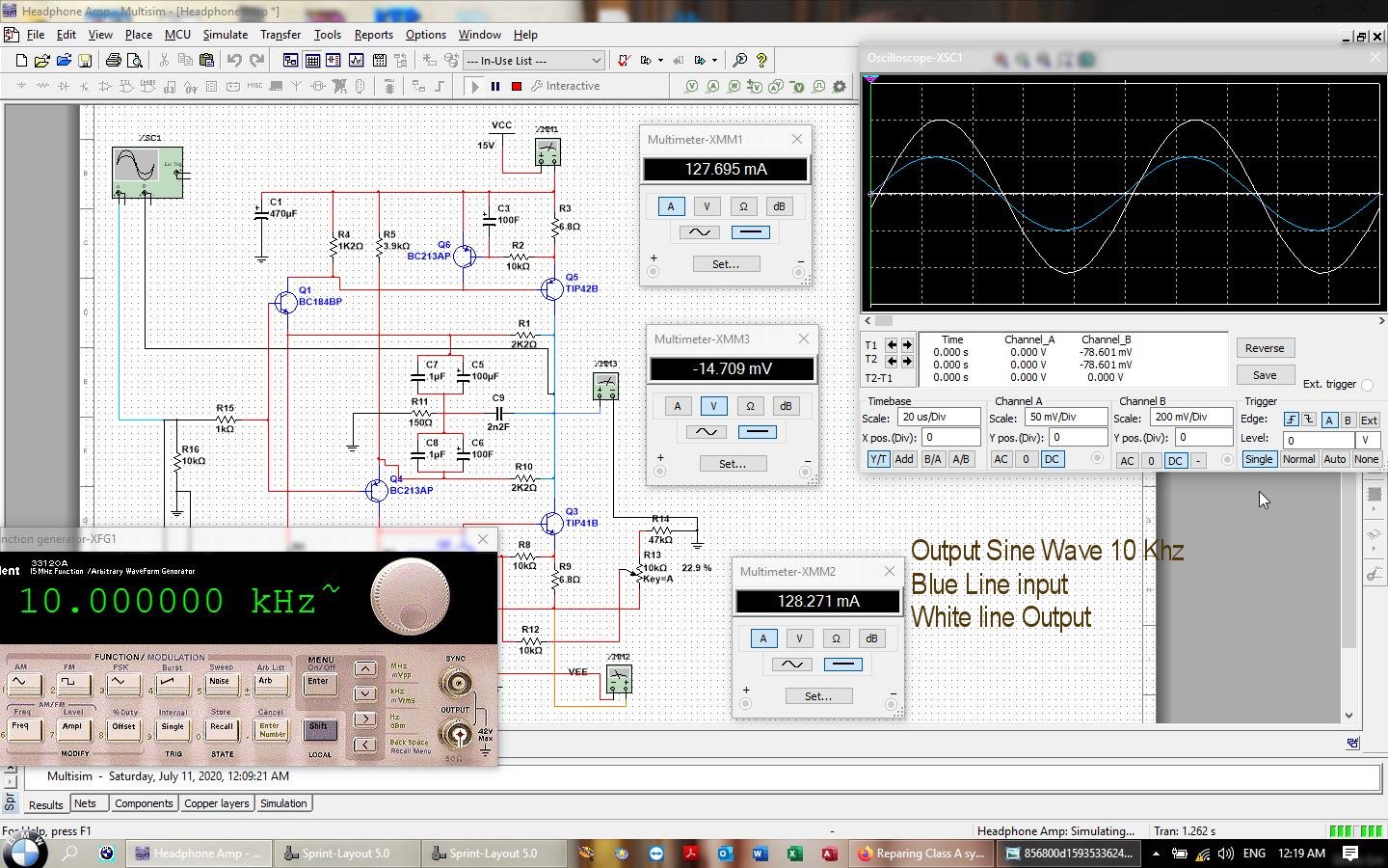

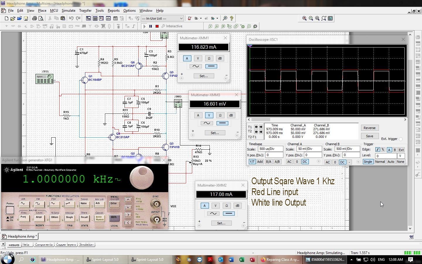

Simulation with National Multisim 14
OK. Lawrence,
as I promised I simulated this amp for you.

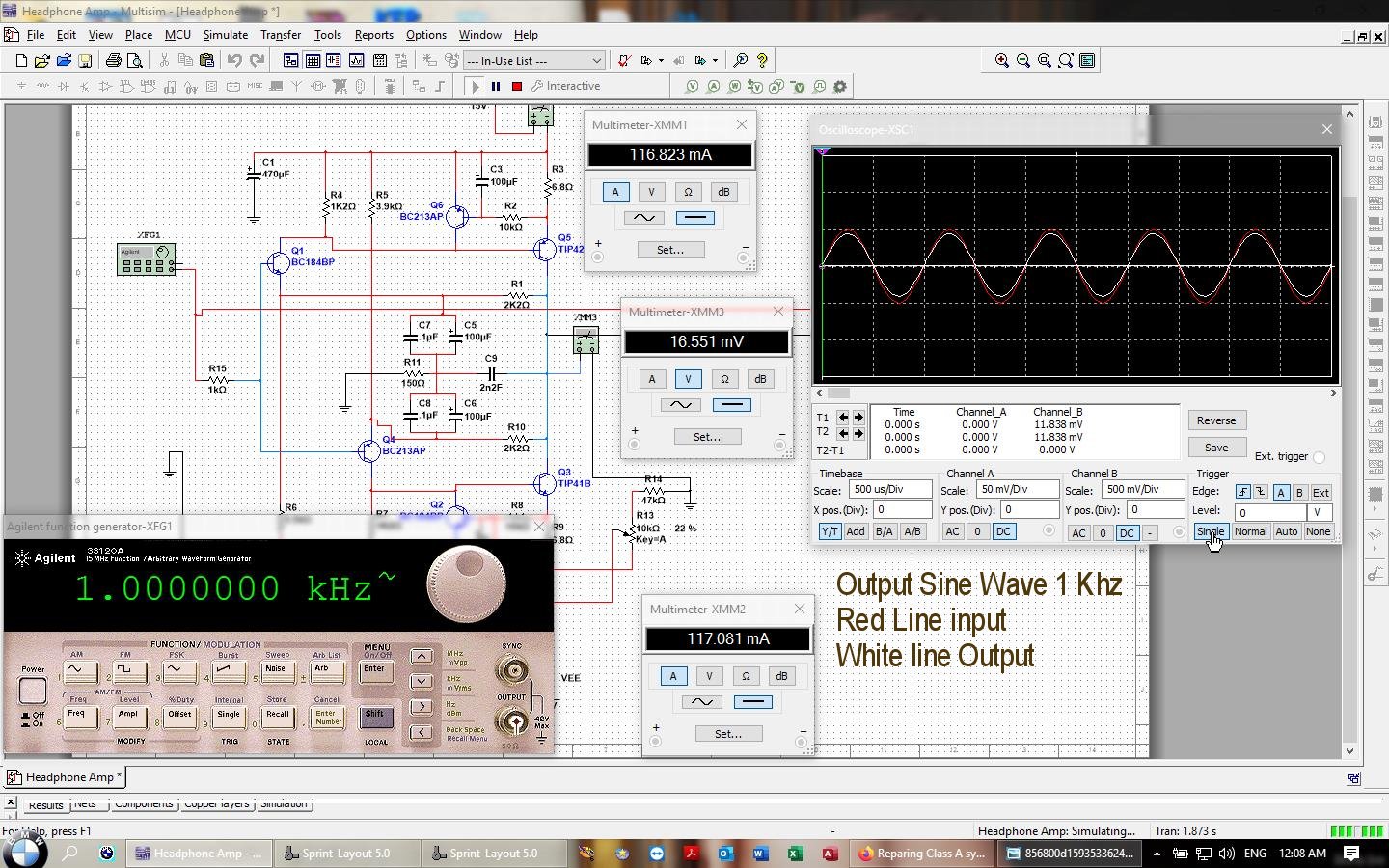

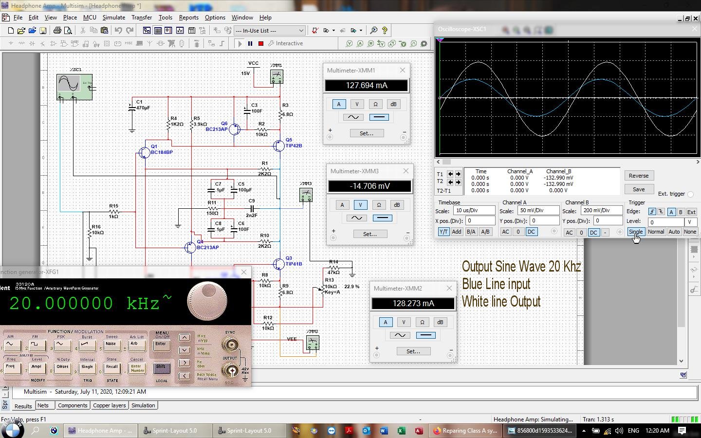

All your Measurements, as you got it - and it don't matter if you use TIP41B or C and TIP 42B or C. it's almost the same. TIP42C has less Noise and Amplifies a little bit better..
Gain of this HEADPHONE AMP is 1.3
Frequency Response is 20 - 20 Khz +- 1db. I think this is fair enough.
For me the error would be Resistor 9 = 100k. The resistor is not faulty but I guess it's only 10K and not 100K If I use this resistor with 100K I get DC OUTPUT of about 1.7 to 1.8 Volt and no way to lessen it. may the Schematic has been written the wrong way and the original resistor has been "Streched" this would explain almost everything.
Exchanging this resistor to 10 K then you are able to adjust 0 Volts very easy at about 23% of the Trimpot.. This is your choice. It does not have any influence on sound nor on the output, as the transistor pull only 117.milliamps and that's nothing for a Class A prestage or headphone amp. I do not know what kind of Headphone you are using but you must add 4.7 Ohms to the Headphones Impedance as we have a 4.7 Ohm Resistor in serie with the Headphones.
For the power output it's 11.5 ohms Approximately.
I simulated with only what it used that the amp runs.. as a Headphone AMP
My Resistors are not named in the same manner as yours so please be not surprised.. use the NUMBERS of the circuit you placed online. the value is exactly the same as yours.. and I tested it with both output Transistors..
I do not have BC214 in my Database so I took BC213 it's almost the same. so this also is not a problem because that simulation works exactly as you have measured it..
May PRR can take a look at the Simulation files which I paste here for you and everyone else...
You can only win. 100K resistor: Colors are Brown, Black, Yellow and Gold for 5% Silver for 10%, Red for 2 % and Brown for 1%
10K is Brown, Black, Orange and same as above for the percentage.
Hope this helps.. it's 1 AM here in swiss.. so midnight in England..going to take a nab..
Greetings From Switzerland
Chris Hess
Chris Hess

Hi Chris,
Many thanks for the time you put in to helping me.
I did change the resistor from 100k to 10K and that worked as you said for the DC Offset.Very tricky to get the trim-pot to the right position as has been mentioned by PPR but got it to 20-50mV so a vast improvement.
Unfortunately the left channel dropped out after listening for half hour or so but then came back again so there is still an intermittent fault somewhere.This has happened before.It would drop out cleanly on one channel(no hum or distortion) though sometimes a faint sound before it went completely.Do you have any ideas what may be causing this?
My system is set up so that the Class a headphone amp(within my kit pre-amp) acts as a high output for my power amp which is based on the Doug Self Blamless Amp design(attached). The normal output from the pre-amp is only 500mV which was not enough for the Power amp that requires 1V for full output so this is why I use the higher output from the Headphone stage.
The Power Amp does have protection circuits for the speakers but these don't appear to have been activated when the left channel drops out as they have LED indicators on the front panel to indicate excessive DC at the output.
