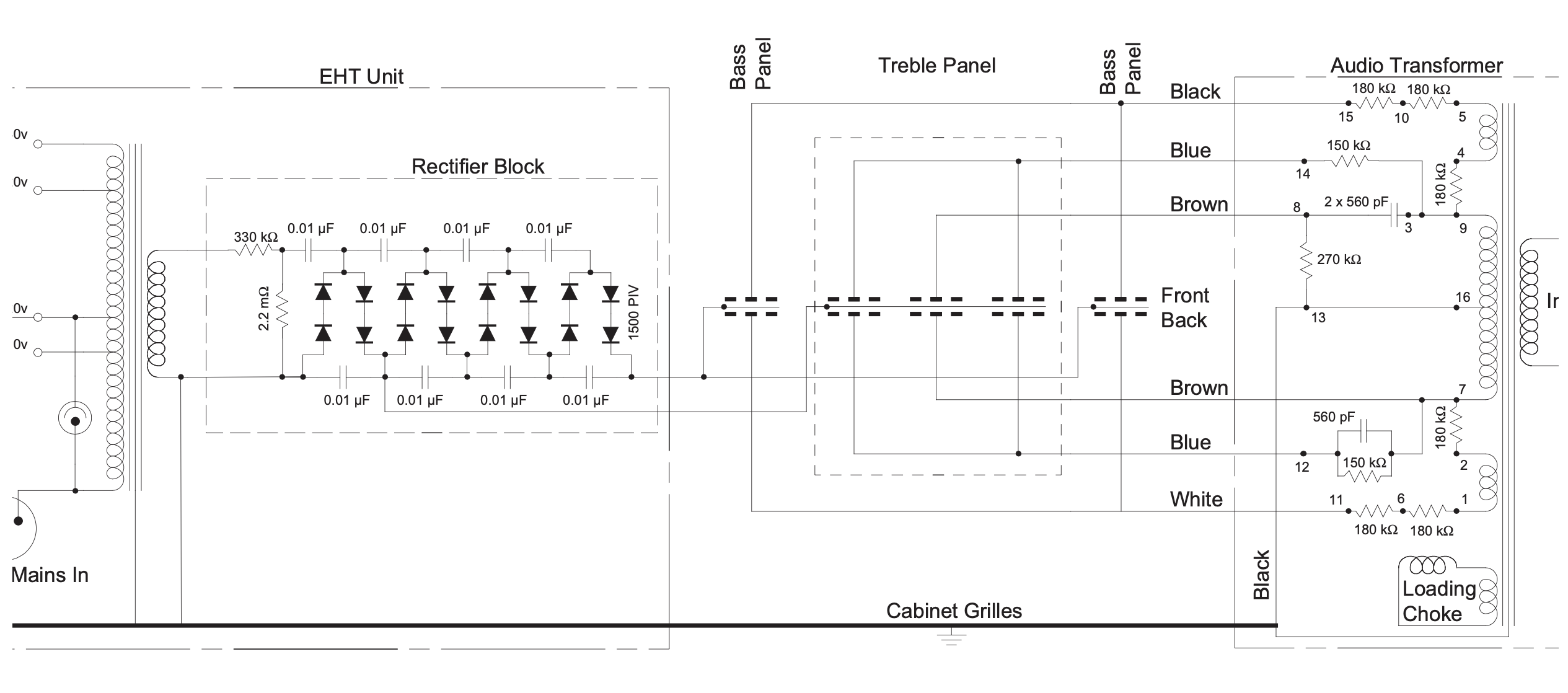

An amplifier employing 807s is nothing special, just a power amplifier with plenty of headroom is required for ES loudspeakers. The ESL has an audio matching transformer built in to isolate the input amplifier from the 6 or so kV static required to run the speakers.
See schematic attached.
The Williamson amplifier works really well with 807/6L6 as well as EL34/KT88 valves as the output stage.

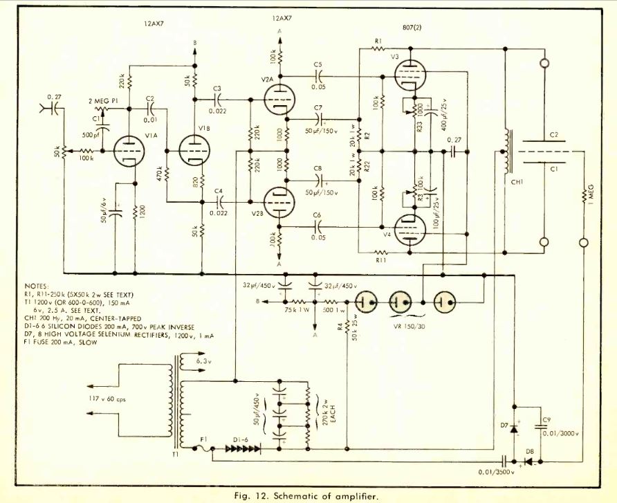

Stop looking, I found it filed under another category. The same magazine had two articles of interest to me. AUDIO June 1963.
Almost identical to the Rennwald circuit actually. In fact the article was written by Rolf Rennwald!
.... AUDIO June 1963....
Thanks for this. Direct driving ESL's with tubes is so elegant. So Ive attached the two other pages of this article addressing the theory and build of the DD-amp in case anyone is inspired to have a go.
