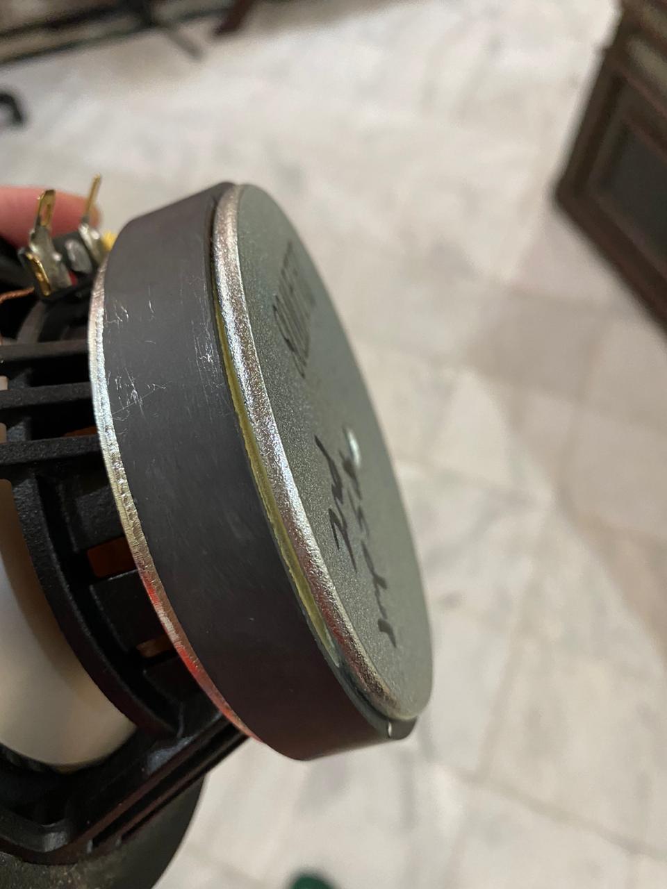

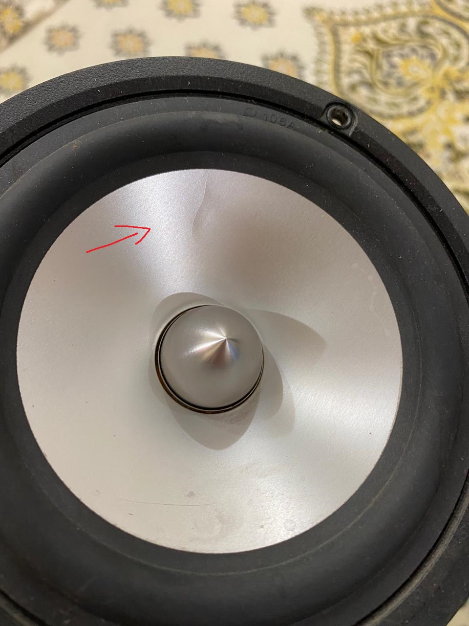

I was in the process of redoing my boxes. And i noticed about 3 of my mids, have very small dents/scratches. Pictures below can be seen.
I was just wondering if this will be audible?
And how can I test the impact of them to see if they are still working as intended to?
I was thinking of measuring all the mids against the one that I know is in perfect form. Should I do it 1" away like with subwoofers? Or should I do it 1 meter?

OK this will sound silly. When I crush Coke cans, the ones with no dents will support my 180 pounds.
The ones with a minor dent collapse much easier. I expect your speakers will behave similarly. At low
to modest levels no discernable results. At high to very high levels the cone may misbehave. Will it
be audible? I doubt I could hear it.
G²
Any imperfections in my speaker drive units annoy me, but I am finding it difficult to see the dents/scratches to which you refer.
If they're not particularly visible at the resolution of your photographs, I would be inclined not to worry about them.
By all means do some comparative measurements, one metre out seems reasonable.

I might get in trouble for this, but I have to ask if some of you are BLIND!
Clearly a fracture problem with these Zaph ZA14W08 woofers. Also possibly using old worn-out moulds. Does it matter?

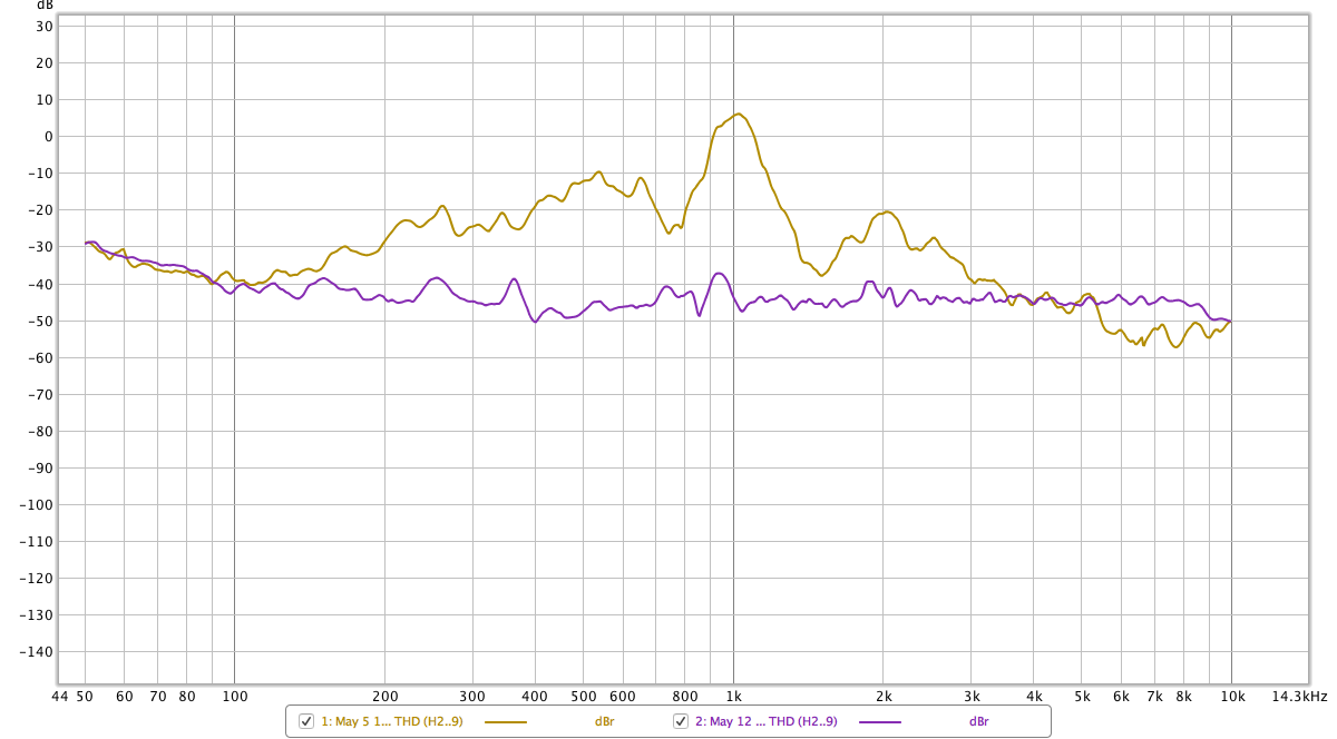

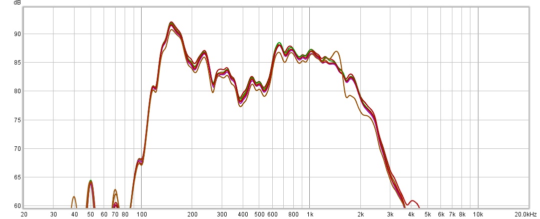

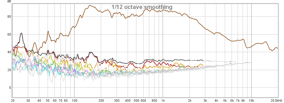

Firstly, all of the measurements were done in the same exact conditions. I had it in my enclosure, with one of the mids and tweeter removed from it, so there were 2 big holes. And I wired it to the upper mid on the crossover. Not sure if I got the polarity right as it was supposed to be on the crossover, but I did use the same polarity throughout this test. 10" away, pointed right at the mid.
So basically. You were all right. There was no impact that I could find from the small dent/line/dinged unit based on measurements.
Here is what happened though.
I took my FIRST mid, which was totally okay. Measured it. Got a response.
Took my SECOND mid, which was also totally okay. Got a response, with a 5db dip.
Not knowing which one is correct, I kept going through all of them.
The one with the scratch/dent and all others matched my FIRST measurement.
Now this is totally bothering me. The mid that shows no physical damage or anything upon inspection, shows a 5db drop around 1500hz and has higher distortion too.

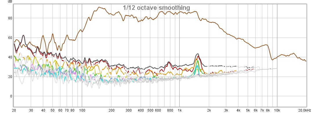

Graphs are here.
Distortion graphs are of one of the normal mids and the other with the dip.
Graphs are here.
You'd expect the quality control on a $50 5" metal driver to be quite good.
The dents do look merely cosmetic. But the duff driver is clearly doing something bad. A full frequency response without filter might tell you more.
You've got Michael Chua's measurements to compare:
Swift 2.5 (Zaph ZA14W08 with Peerless DQ25SC16-04) – AmpsLab
1.5kHz is the region where surrounds and corrugated spiders cause distortion. Maybe too much glue? Maybe a rubbing voicecoil.
Rubbing voicecoils are usually easy to feel with a bit of prodding and pushing. The cure is often to rotate the driver. Not unknown for a bit of ferrite or grit to get stuck in the gap too.
Who knows, eh? I expect a reputable supplier will replace/swap if you are unhappy.

Be that as it may, re the driver, if the VC has sagged fractionally & is rubbing because the driver has been mounted the same way up for a long time (it does occur), as Steve suggests, try turning it 180 degrees. It may prevent rubbing etc. Worth a shot, since it costs nothing.

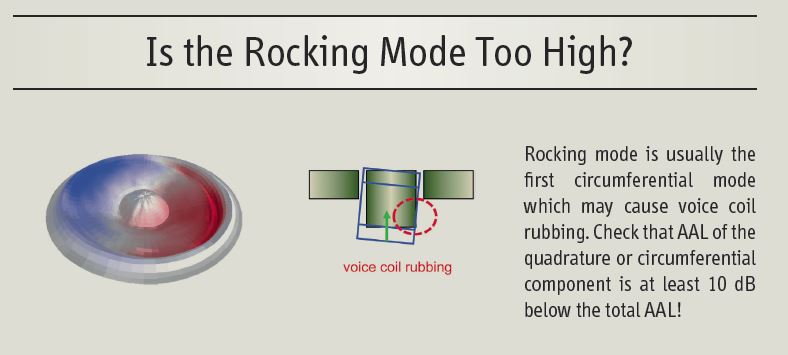

Scottmoose has answered it, though I often try 90 degrees as a start. Theory is speakers sag a bit with age, and rub voicecoil occasionally. Especially if tolerances or manufacture is poor.
What else might go wrong here?
Rocking mode?
Another sort of rocking mode? I prefer series wiring.

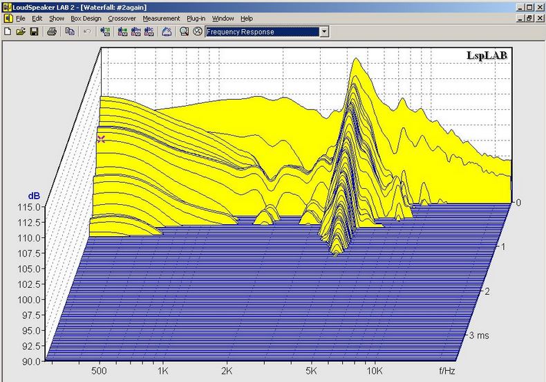

General cone breakup issues:

Its the Zaph ZA5. I purchased it from Madisound 2 years ago. I am not sure they’ll change it for me now. What so you mean rotate the driver?

What is this? Is this glue sticking out or what? this is about the only thing I could find abnormal. The VC is not rubbing or anything I checked. And I can't exactly figure out how to "rotate" the driver. Sorry I am pretty much a newbie if you all haven't figured already.
Yes, looks like magnet glue. Nothing to worry about there.
By rotating the driver we mean mounting it back on the enclosure so that it is upside down compared to the way it was mounted previously.
Yes. I have done that! Took it out, mounted it back in the enclosure in a different way.
Is it possible too much glue is causing this issue as mentioned by Steve earlier?
I think Steve mentioned glue in relation to it preventing the free movement of the front suspension (the roll surround) or the rear suspension (the corrugated 'spider').
I don't know if it is possible that magnet glue has got into the narrow magnet gap that the voice coil vibrates within. If it is possible, there would be no way of telling without destructive dismantling of the driver.
