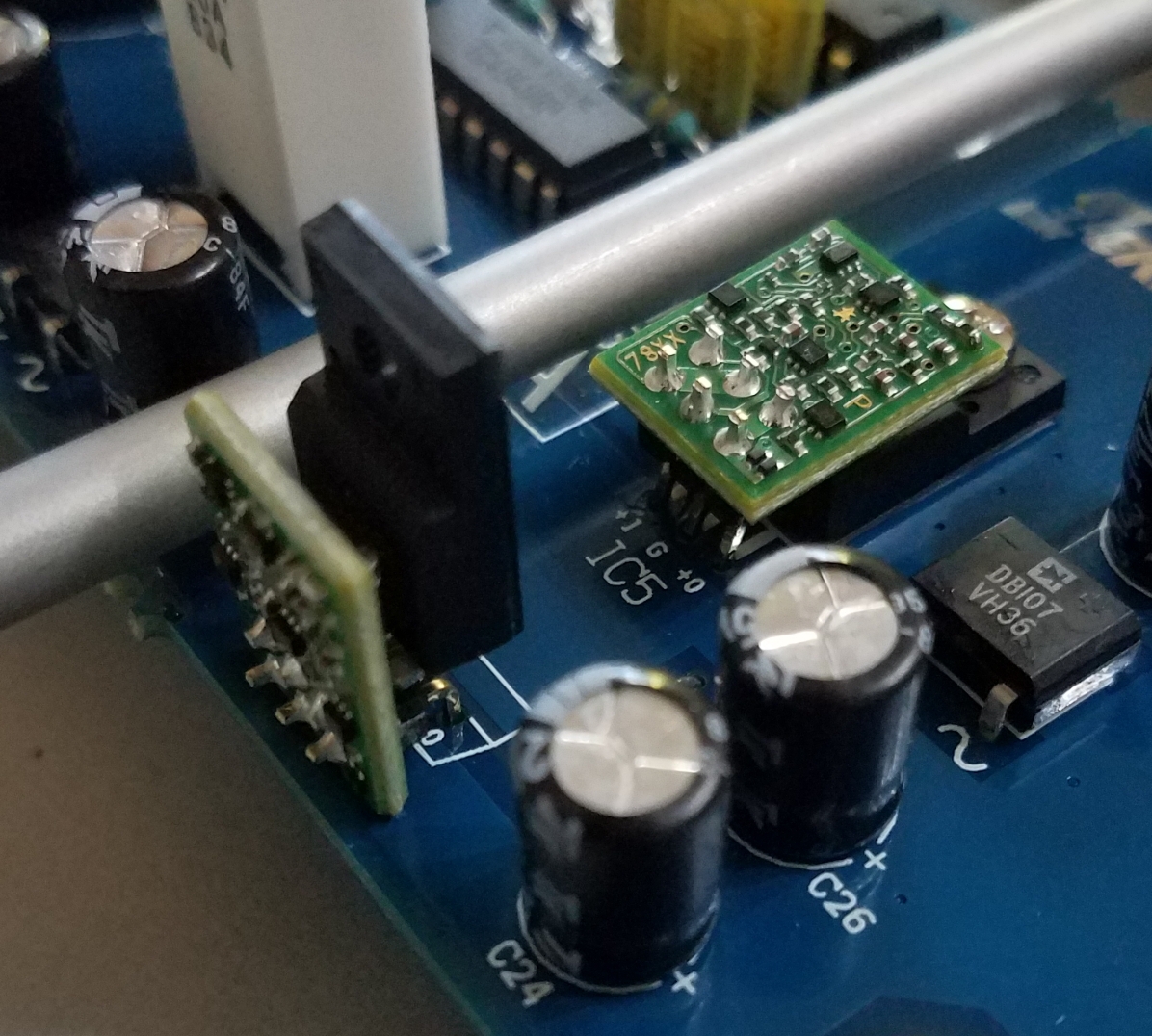

I just got them in today, and honestly I wasn't expecting any audible differences, they are only voltage regulators after all. I carefully removed the original LM2940C, and LM2990 regulators. The Sparkos labs regulators, although bigger, fit perfectly on the board. After placing everything back together I did some voltage checks on the provided test points on the TU-8500, everything was more or less the same except the +12V and -12V points. With the original regulators +12 sat at 11.6V and -12 measured at -11.74. The Sparkos labs regulators+12, measured 12.0, right on the money! and -12 now at -11.98.

Yes! that is correct, 78XX +12V and the 79XX -12V. I shared the power supply schematic with Andrew of Sparkos Labs to verify their discreet regulators would work in the circuit. But I also ordered a +12.9V, i'll explain below.
So you have two options, I tested both methods and I tied both methods. And I just got my O scope delivered this morning so I have pictures to share.
First option as recommended by Andrew of Sparkos labs. He recommended to bypass the zener, Its "ZD2" on the schematic. this is on the ground leg of the +12V regulator. He explained that the point of this Zener was to up up voltage to make up for the losses in the diod networks, but this zener could probably restrict the output capacitor on the discreet regulator from discharging properly. But, once the zener is bypassed C26 then takes over ias being the output capacitor. he said this capacitor is ok to use. obviously this is just from looking at the schematic .
I went ahead and verified this. with the stock +12V regulator, Zener ZD2 in place, and measuring on the +12V test point. voltage was at +11.6V. Same test conditions but this time with the zener bypassed, voltage read at +10.7V.
When I recieved my discreet regulators, the +12V and -12V, I tested having the Zener in place and bypassed. Audibly, there was no difference having it bypassed or in place. The discreet regulator does have less of a voltage drop without it as you will see in the pictures, it only drops to +11.5V without the zener.
Second option is to leave everything in place and just swap out the regulators.

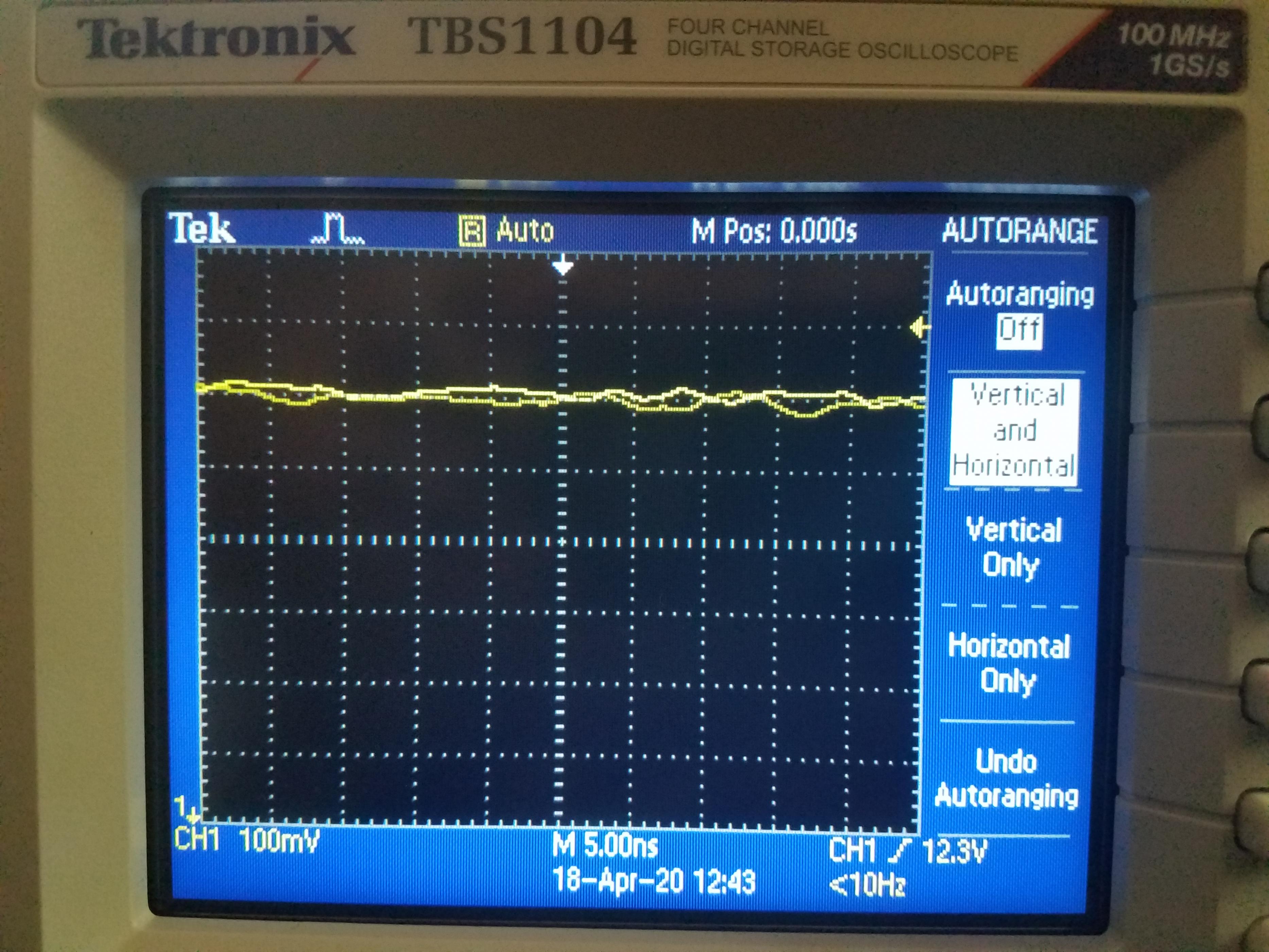

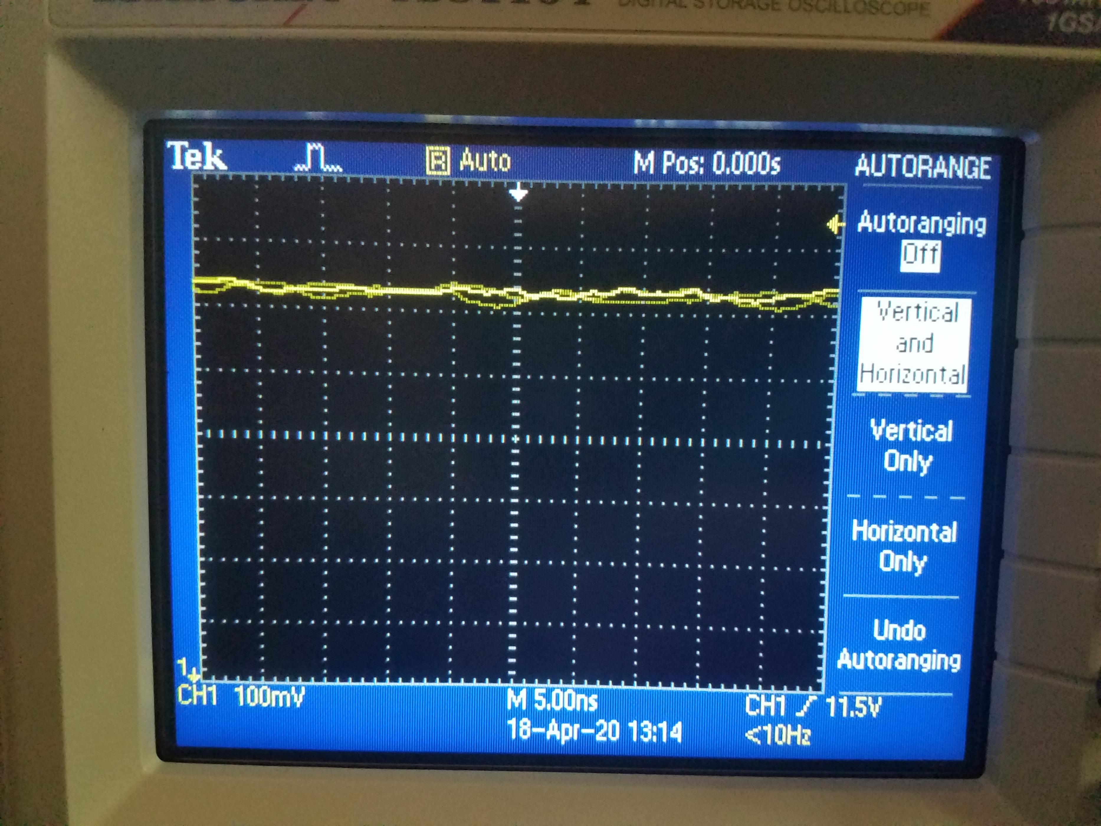

Using a scope this morning I see no difference in the traces from having the zener bypassed or leaving it place, aside from the voltage drop. I had to zoom all the way down to 100mV per division and 5.00nS to try to find a difference, and it just wasn't there.
To tie all of this up. If your going to bypass the Zener , which Andrew recommends order a +12.6V 78XX regulator and a -12V 79XX regulator. I ordered the +12.9V if I chose to bypass the zener permanently.
If you are going to leave everything in place as is. order a +12.0V 78XX, and a -12.0V 79XX. This is what i'm sticking with after the scope readings.
first picture with +12.3V is with the Zener in place
second picture with +11.5V is with Zener bypassed

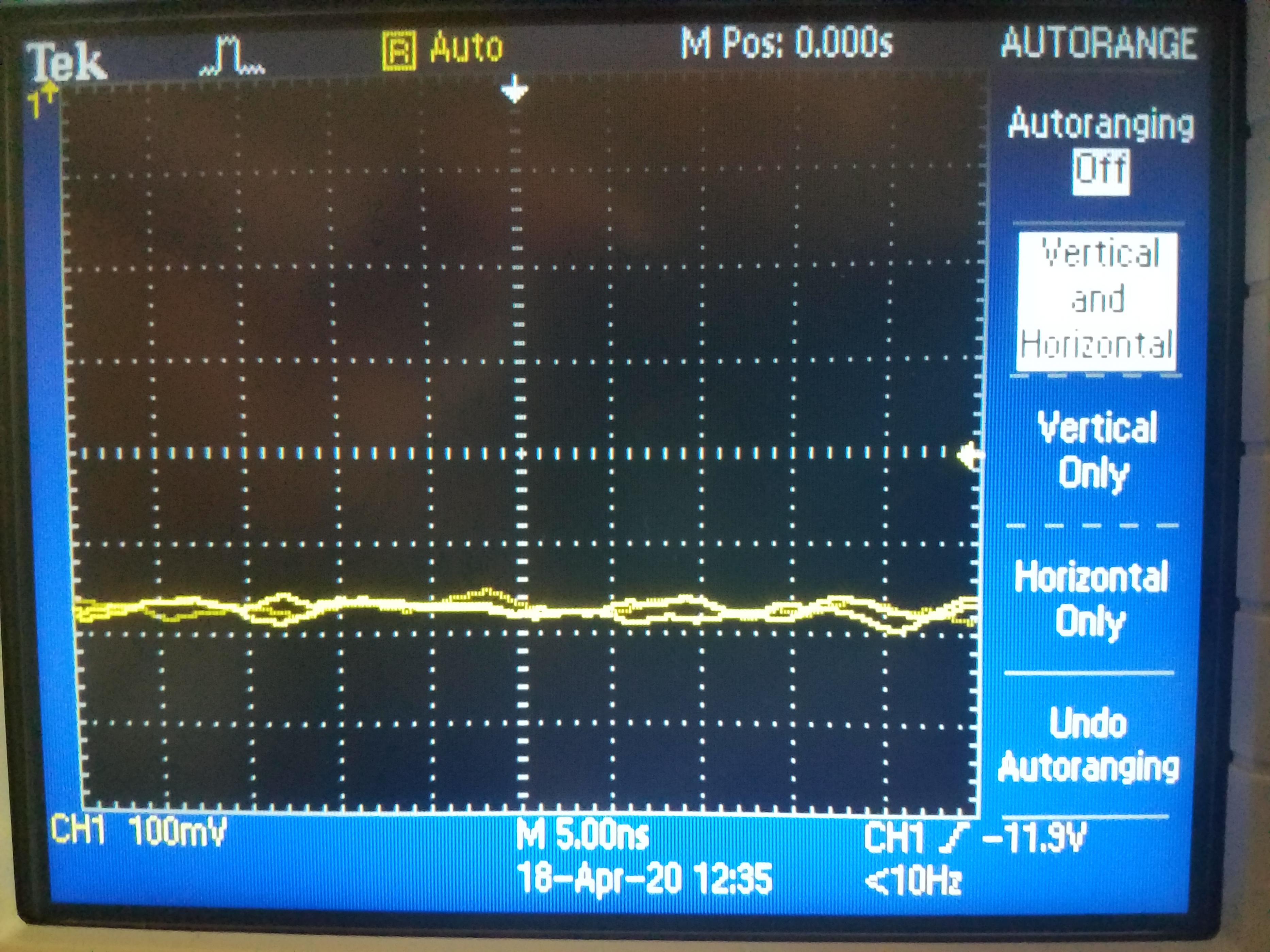

Third picture is just the -11.9V trace

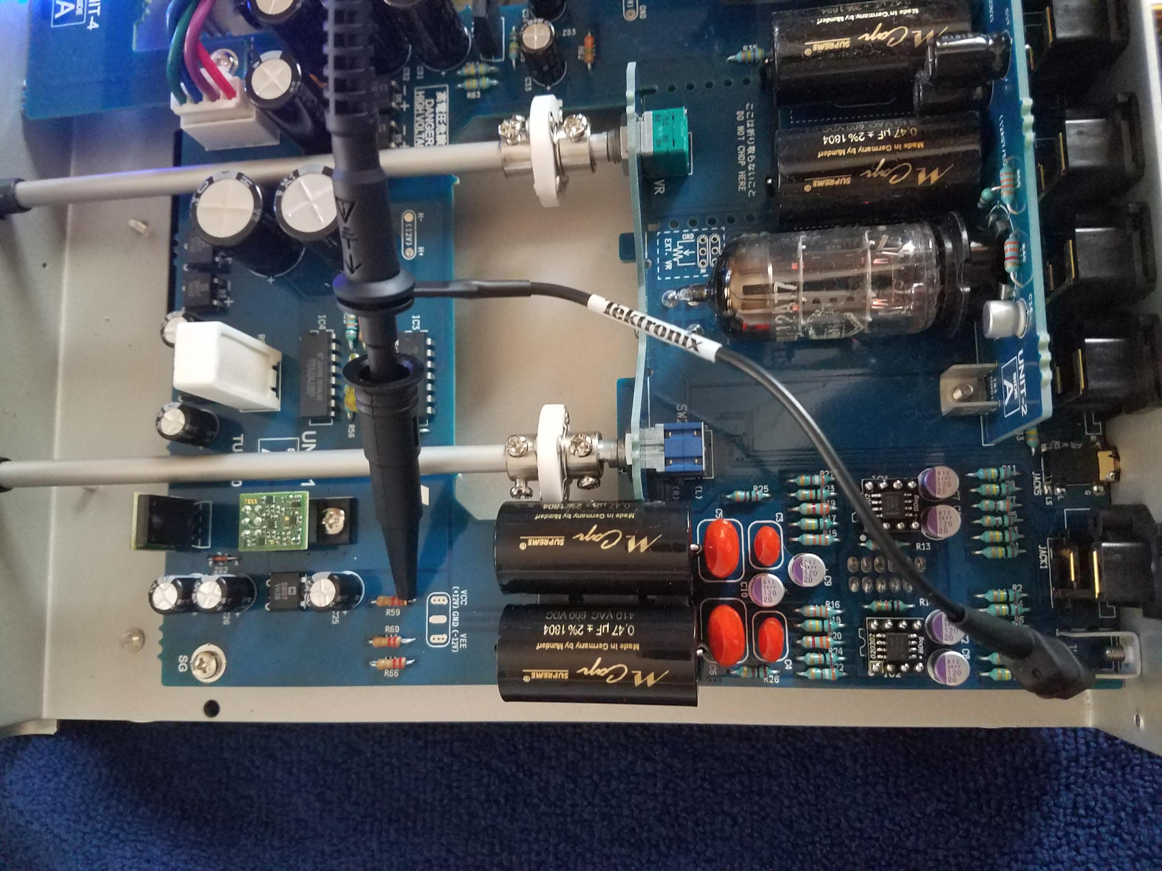

And the last picture is the test point I used
