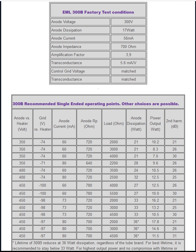

By the way, on the EML website they provide operating points for the 300B for 400V and 450V, so maybe 420V will be OK ?
300B tube data sheet. Emission Labs.
You have some voltage drop on primary of OPT (5-10V, depending on primary resistance).
If your 300b's are biased at 60mA, dissipation with 422V B+ is 25W and that is way below 36W recommended max for EML tubes, no reason to worry. You could bias them hotter - that will drop some voltage as well.

sorry folks I was wrong while zxx222 and itsikhefez were absolutely right : 420V and 70mA are way below max permitted with these tubes (see doc attached)
So that's now my configuration, running happily and sounding very good.
Well anyway I've learnt something and received good counseling, thanks all and sorry for the inconvenience.
As soon as burn-in is finished will report listening impressions but from now I can say these tubes sound detailed and delicate, while bass is present and controlled.
