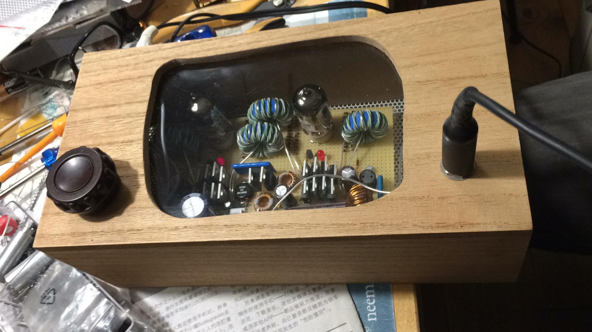

This looks like a good start (cathode follower for low output impedance). An other way can be the Zotl amp as this can even drive loudspeakers of 4 Ohms.
The schematic can be found here:
http://www.davidberning.com/images/microZOTL/microZOTL_Manual.pdf

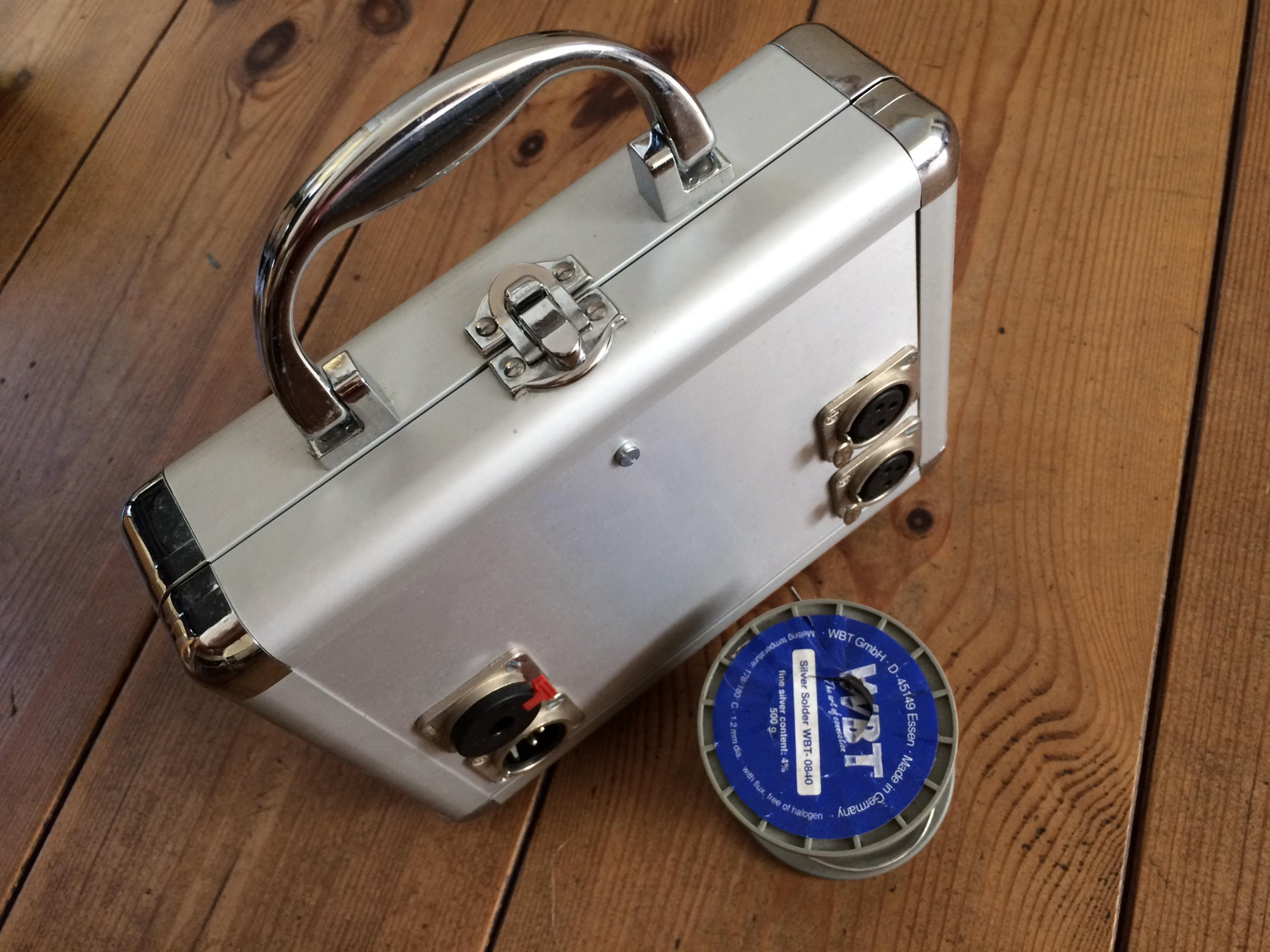

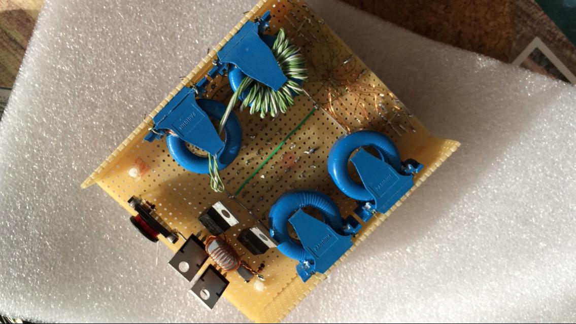

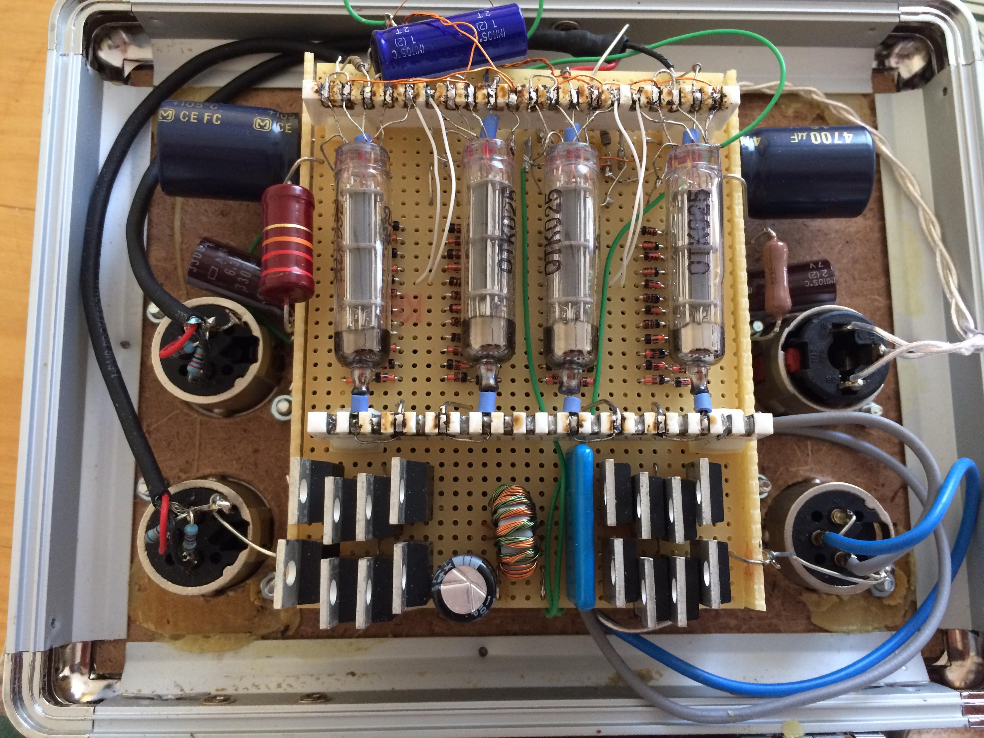

Thank you, I'll check it out. But .. to be honest.. I'm enjoying this so much I'm actually going to put it into a proper chassis, with all the goodies it needs. It's just such an amazing experience now, this kind of detail, dynamics and bass drive, first I was like 'holy ****'. It just needs to stay in my system. But I'm open to new things - as always
