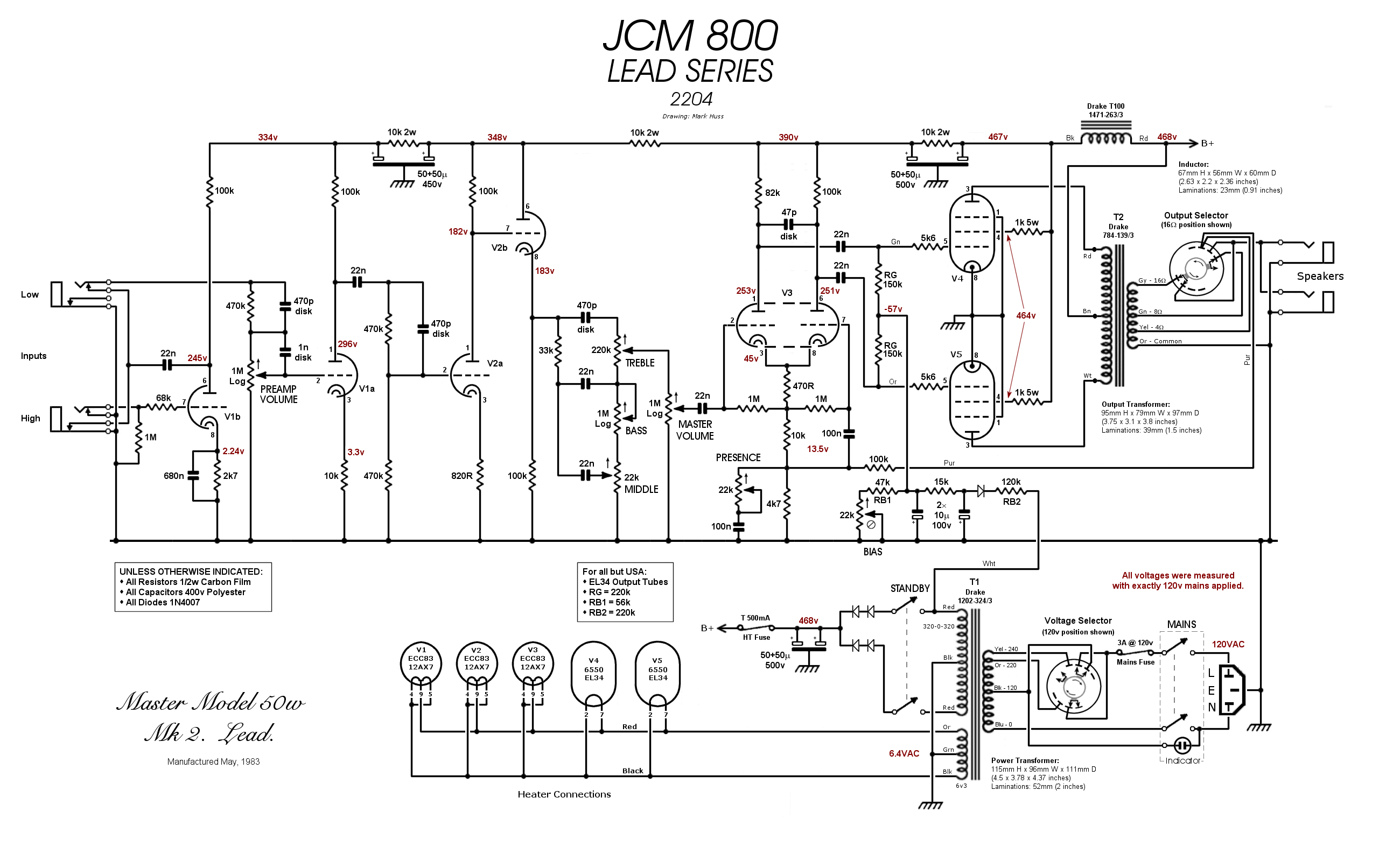

So I have a small output transformer to play with coming from an old battery radio. Effectively a 8K push pull transformer. (there is no existing documentation on the radio so its dead).
I offered my classmate a chance to have one tube guitar amp because when he first heard his guitar trough my hifi tube amplifier fell instantly in love with tube stuff.
(I know I wont be able to replicate it exactly to what my big amp sound like but its just the tubes he wants)
Since I wanted to do something he will be familiar with I have chose then Marshall JCM800 schematic.
Basically use the entire schematic as is except the output stage will be consisting of a push pull cathode biased EL84 output.
My only concern is the lack of voltage for the preamplifier and the not required crazy amounth of drive from the phase inverter driver section.
The estimated voltage wont be much more than 320V which is much less than the 470V for the EL34 stage. I am concerned about the preamplifier how will it affect the gain and other characteristics.
Would it be a big problem if I left the schematic completely stock no value change and just undervolt it and call it a day or I will have to change a few parts arround to make it perform properly?
(I am attaching the schematic with voltage measurements aswell. The amplifier I want to make will have a simple cathode bias EL84 output stage not the EL34s)

The first 10K/2W power supply dropping resistor can become a Hammond 154E. With your decreased B+, the choke will offer less voltage drop but still plenty of power supply noise rejection. This won't completely make up the difference, but it's a start.
Traditionally guitar amps flog the snot out of EL84s, so going with 400V of B+ is inappropriately appropriate.
You can run the preamp voltages at a lower voltage. In fact, I have a Friedman BE100 here and is a hot-rodded JCM800. Voltage at the plate of the first tube is 169VDC. You will have to increase the feedback resistor as EL84 do have a lot more gain than EL34's. I have probably built more EL84 guitar amps than anyone fwiw.

I actually thought about linear regulation for the preamp with a transistor and so on. Easy but effective. Yeah a choke would have been an easier way off but for 15 dollars I can do a lot better with transistor regulation.
Yeah I have seen people pushing EL34 grade performance on class B with those things. I would prefer to conserve the tubes at least a little bit. This aint the "money no objection" kind of project. Thats where my personal hifi amplifier excells.
Yeah I thought about it for a while and I have to say I have never seen this implemmentation of NFB (granted I did hifi amps only up to this point). Makes it just a matter of playing with a VR and finding the best value.
Should be ok with a little work. The output transformer could be the sticking point, but give it a try.
The feedback loop may need some attention.
Yeah, that should do. I've sucessfully combined a MARSHALLesque preamp section with a pair of EL84's more than 40 years ago with amazing results.
