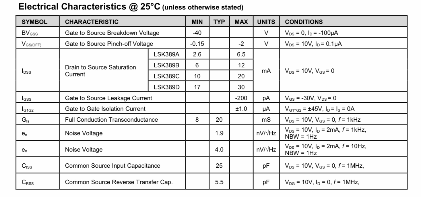

That is really a cool spread sheet you have there. I did notice one thing that is strange.
The graph showing the "S/N ratio vs signal level" shows the LSK389 as being the worse of the lot.
However in the graph above it shows LSK389 to be slightly worse than the BF862, situated between the BF862 & the opamps.
I assume that if one puts two jfets in parallel that the "env" would be reduced by sq rt of 2? So for the lsk389 it would be 1.27/1.414 = 0.9 which is the same as the BF862?
