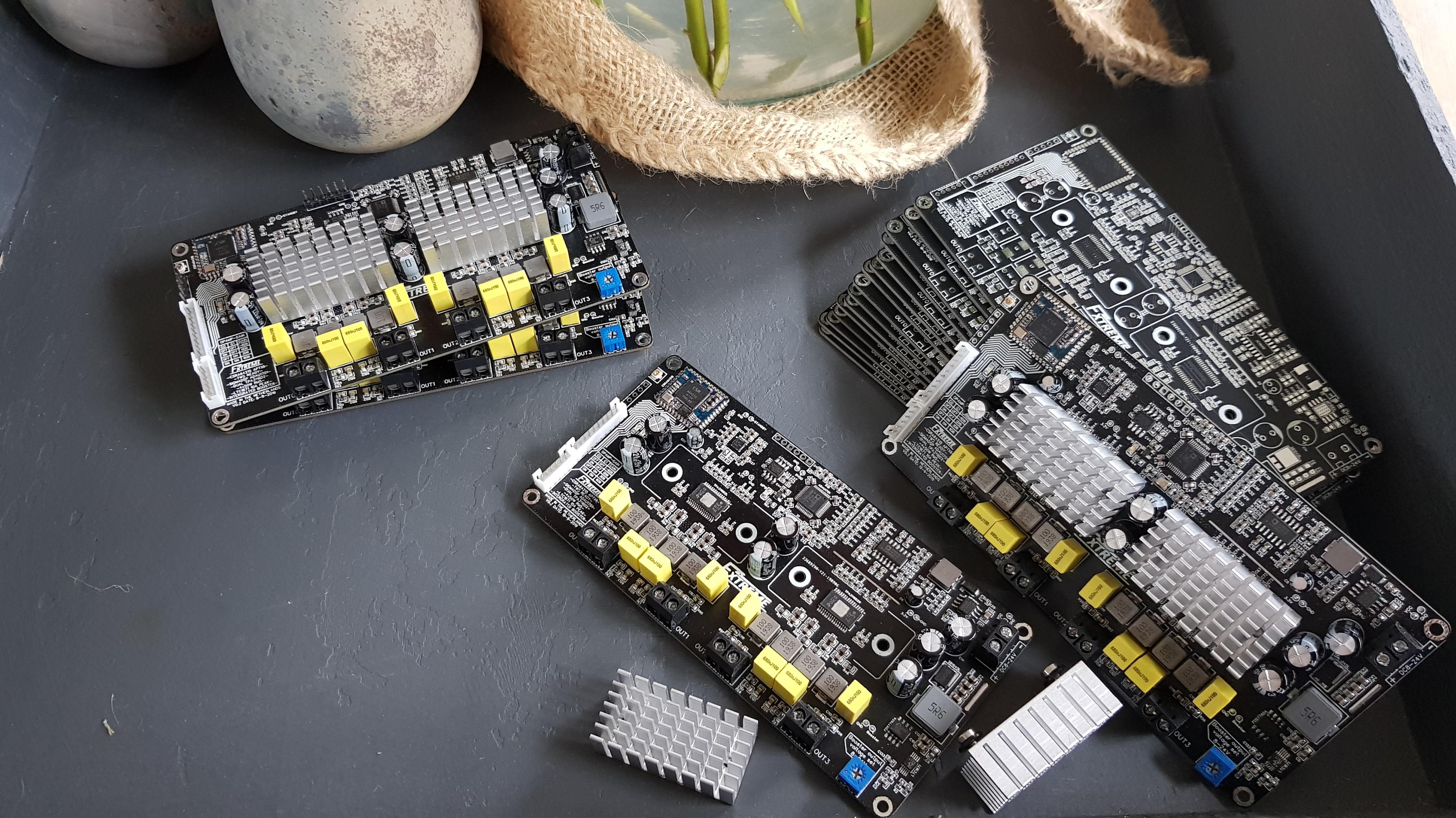

I wanted to introduce you all to the all new FXtreme DB450 all-in-one amplifier system!
FXtreme DB450:

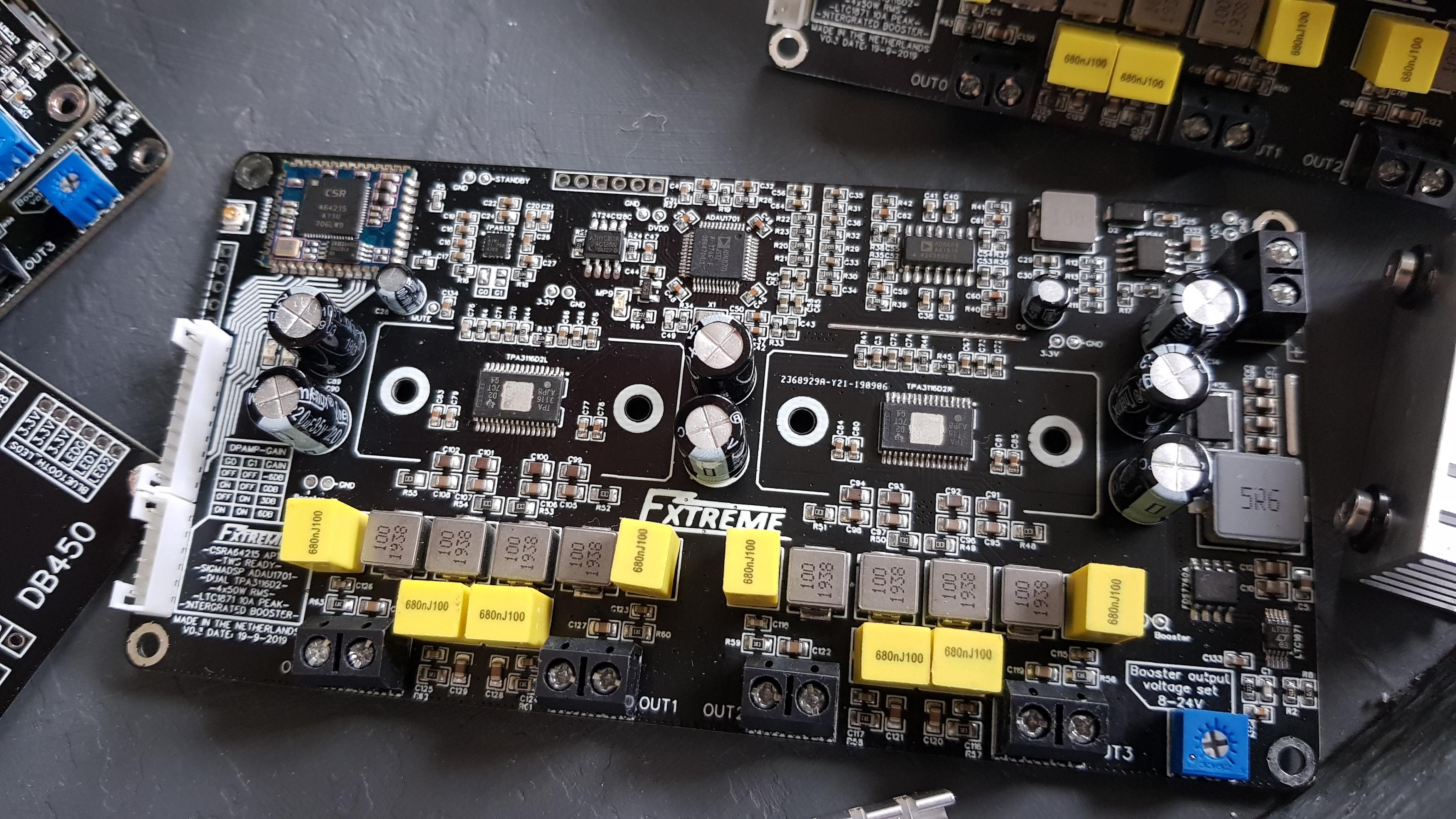

Back of the FXtreme DB450:
This board does not only have 4x50W channels, but also Bluetooth, DSP (SigmaDSP) and an integrated step-up booster!
It is made specifically for those with a limited budget, but still want the absolute best performance and most features possible to, for example, build/upgrade their own portable Bluetooth speakers.

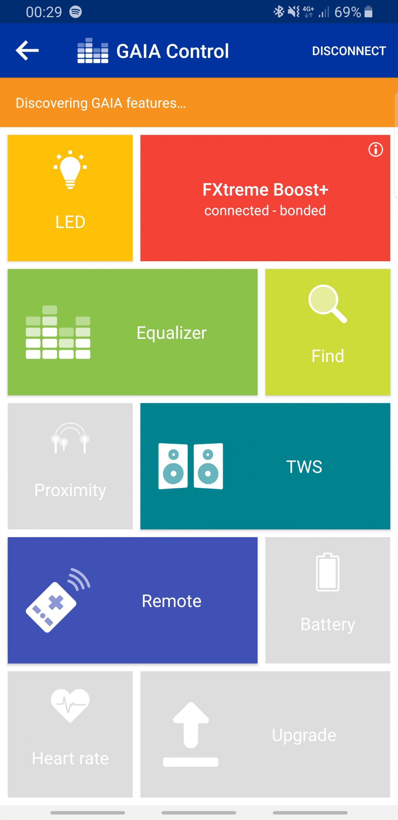

Not only can the DSP be fully configured in SigmaStudio (Free) to make every speaker sound exactly to how you want it to, but it also has an app for Android users, in which you can configure EQs, Bass Boost, 3D Soundstage, TWS Routing, a remote control and many other fun features.
App for Android:

Specifications of the board:
-8-24v input voltage (4s/16.8v Li-Ion battery or 19v 4a PSU Recommended)
-CSRA64215 Bluetooth 4.2 AptXll <40ms TWS + 8DBi antenna (30m/100ft+ Range)
-ADAU1701 fully configurable DSP (SigmaStudio on PC/Mac required for programming)
-TPA6132 Opamp (Balanced)
-AD8608 Precision Opamp
-LTC1871 Step-Up Booster (Adjustable from 8-24.5v)
-2x TPA3116D2 Amplifier chips (4-8Ohm // 2-4Ohm Mono-Mode)
-Small 140mm x 70mm x 18mm format
Included in package:
-FXtreme DB450
-8DBi antenna (30m/100ft+ Range)
-2.54 headers for programming
-Wires and connectors for Buttons/LEDs
needed to get started:
-PSU/Battery (8-24v)
-Speakers (4-8Ohm // 2-3Ohm Mono-Mode)
Basically anything can be build with this board, since it is also possible to make different configurations like:
Mono, Stereo, 2Way, 3Way or 4Way
4x50W
2x50W + 100W
2x100W
(All outputs can be wattage limited separately in the DSP)

Okay. Will check it out when you do. Just wanted to highlight one thing. Bluetooth is not considered as audiophile quality. Only spdif or toslink. Analog input is not necessary IMHO as the input to the dsp is i2s. Doesn't make sense to do a A to D again. Incidentally you might not know this but many bluetooth module has Spdif input built in.

But I will try to add at least an aux input in the next version of the DB450. It will take some time, since the Bluetooth module basically controls everything on this board, making it very difficult to add any additional inputs without adding a microcontroller
Actually it is not as difficult as it might seem. You would need a microcontroller. But if your bluetooth module is based on the Qualcomm's 64215, it already has spdif input and analogue input. Probably if it was other manufacturer you might find it has similar functions.
I believe they are able to set in priority mode. So if there is analog in it will switch to that from BT. No analog, back to BT.
Not sure on spdif...
Oon
Well yeah adding a microcontroller would be the easiest by far, but it will also increase costs and overall dimensions of the board dramatically. it wouldn't be worth it imo.
I have been trying for days to add an AUX input to the CSRA, but it doesn't work because I also use the active audio (Mute, Standby) control from the CSRA to the amplifiers to maximize efficiency, etc..
