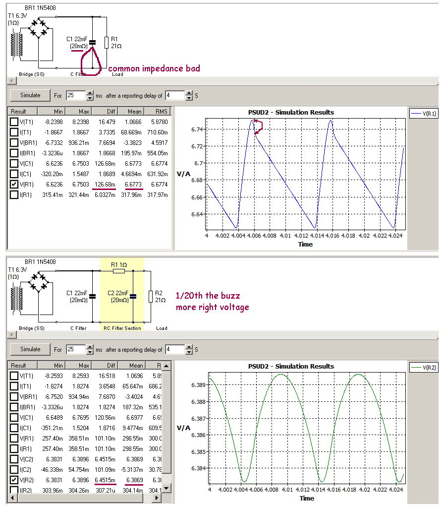

6.3VAC to single stage of cap(s), at heater current, is typically a terrible waveform. See first image. ANY common impedance (or ESR) in the cap makes those "tips" on the waveform, nasty high harmonics. Even to get this good requires very careful wiring and low-low parasitic resistance. In a neat but but unfortunate layout, 0.6V (600mV) ripple would not surprise me. Mesa may just have more skill/experience than you.
Adding one stage of R-C filtering helps a LOT. And in this case, gets the DC volts nearer 6.3V.

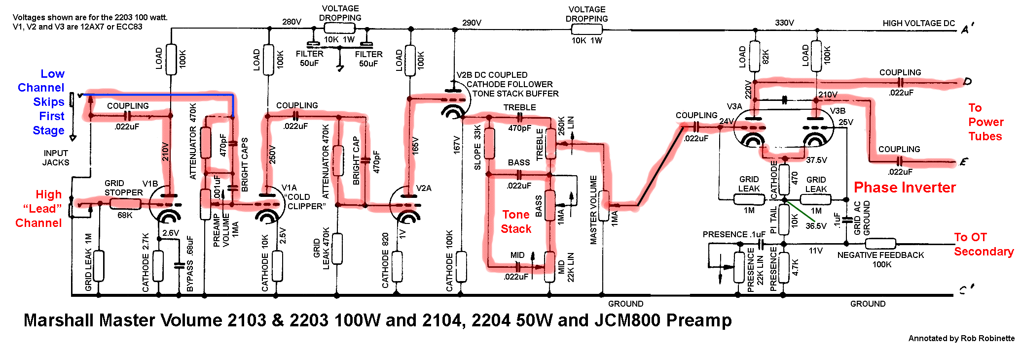

It is basically this schematic with a few changes : all attenuators are taken out, all gain stages have cathode bypass caps.

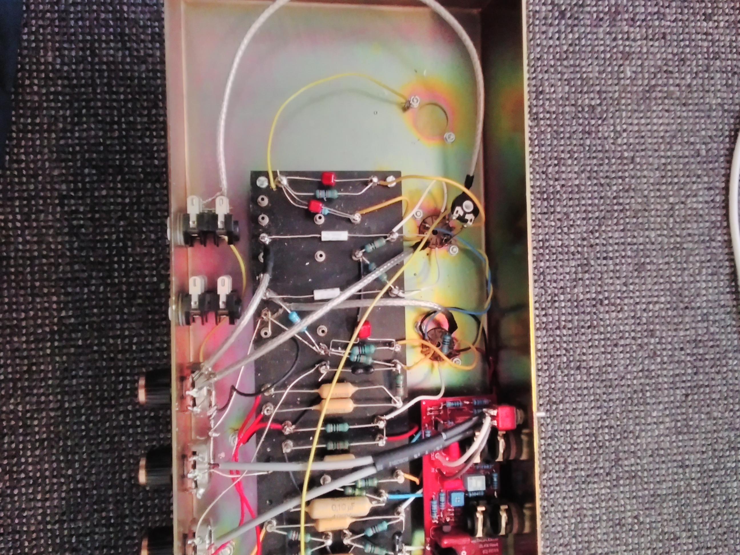

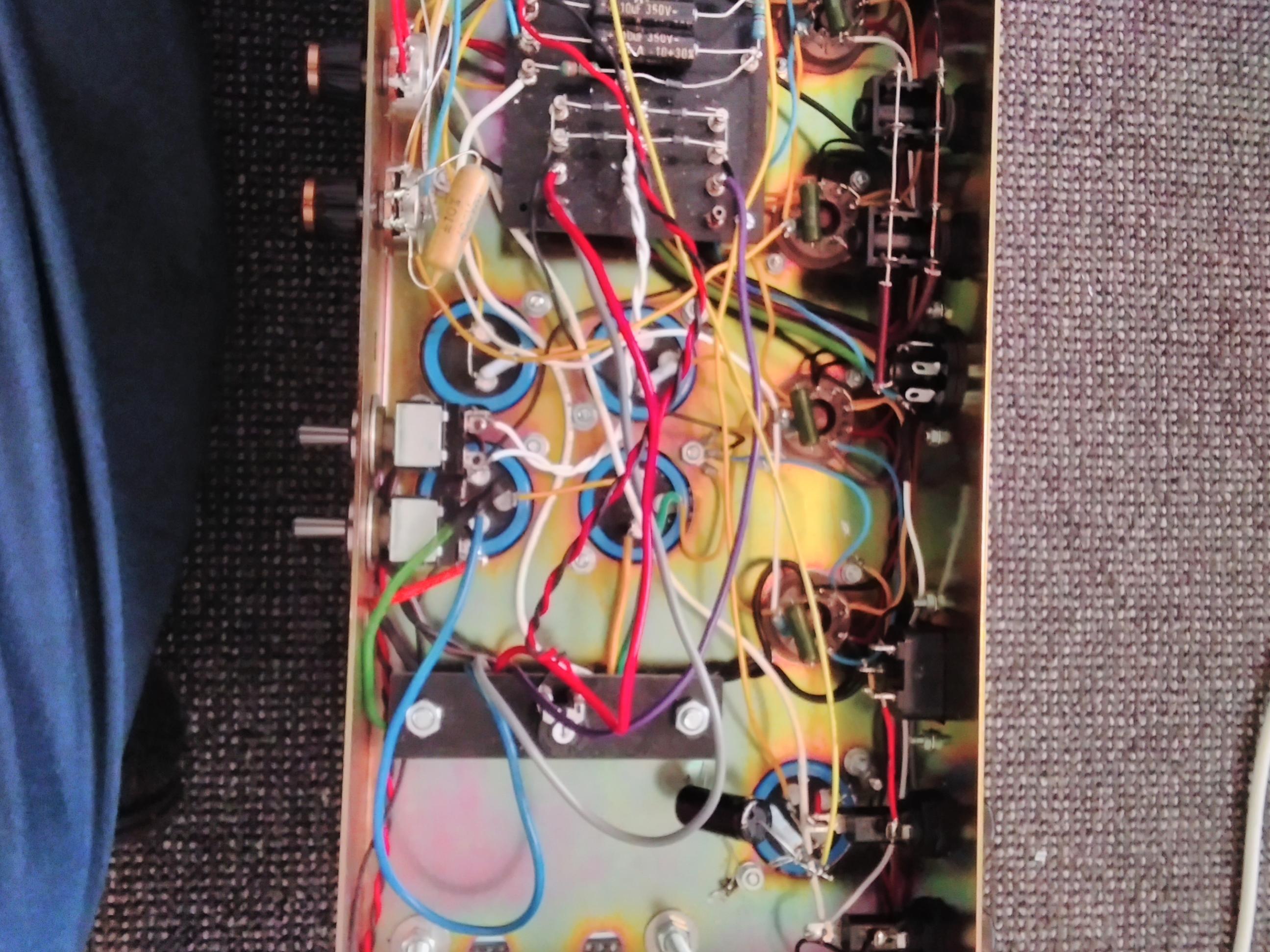

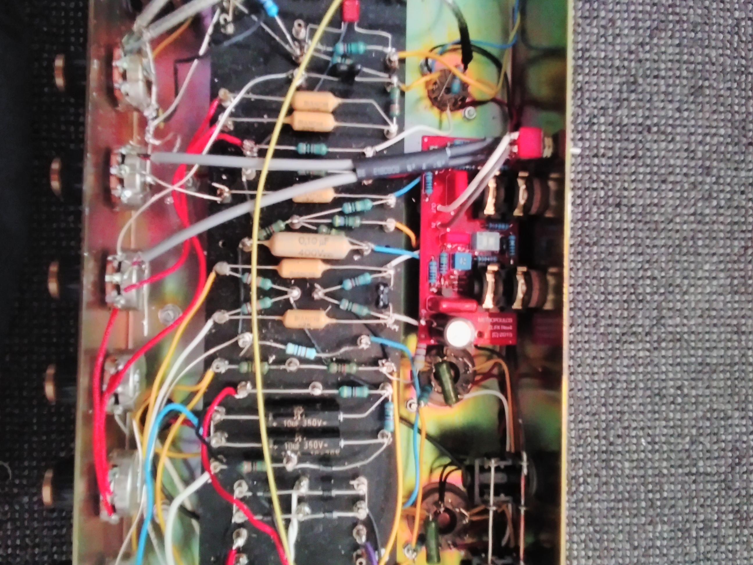

I hope the photo resolution is high enough to see what needs to be seen.
I added grid stoppers and they do seem to help a bit with the hum ( heaters on AC) but I took them out because they robbed highs. I used 34k. Amp was not completely hum free though.
