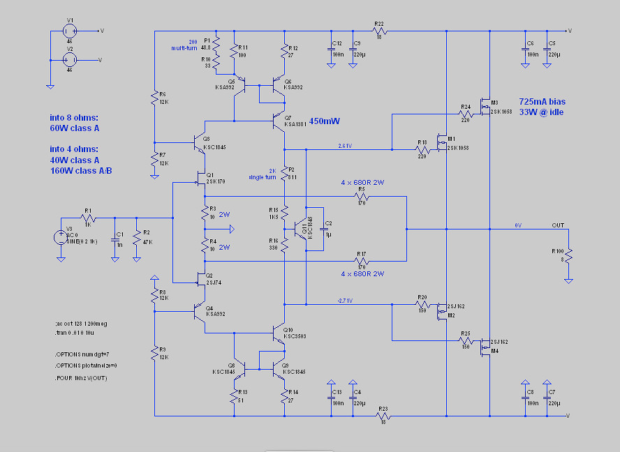

JeffYoung 13th November 2019 10:45 PM
How do you measure bias with no source resistors?
1 Attachment(s)
How do you measure the bias of an undegenerated output stage when trying to set it?
Say, for the XA-25, or for an HPA-1-inspired lateral output power amp such as the attached....
Thanks,
Jeff.
2 picoDumbs 13th November 2019 10:47 PM
Assuming you’re using CRC powersupply, then measure across R on the supply.
Bob’s your uncle.
2 picoDumbs 13th November 2019 11:03 PM
Just adding another cat skin to the list.
If you’re making your own pcb then add a place for a 0.1R resistor at the drain of the output mosfets to take the measurement.
Then once satisfied with your bias setting either short them or remove them.
Some people even leave them in but I personally hate the idea of leaving them in.
JeffYoung 13th November 2019 11:07 PM
Thanks, Pico! I can't believe I didn't think of the CRC resistor.
(I did consider using the current meter on my variac, but I have no idea how accurate it is.)
Jeff.
