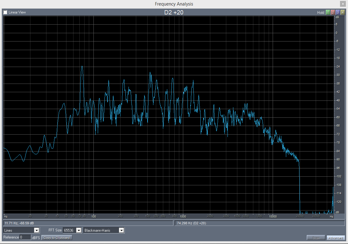

Several technical notes on the test files - the files are recorded in 24-bit resolution and they are in 96kHz/24bit format, however the music signal limit is 20kHz, due to test music sample used. DAC/ADC path is the same in both cases with same settings and levels. The 2 preamps under test have volume level matched within 0.04dB only by use of the preamp's volume control pots. No digital volume matching was used, no frequency equalization was used. Switching spectra (at the same time point) of the recorded files shows they are almost identical. The main difference is in quiescent noise level, which can be seen in the attached spectral plots, but only at frequencies above 20kHz, as this difference is completely masked, in the plots, by the music signals, in the audio band. The plot images are named apple and pear, to exclude relation to the test samples.

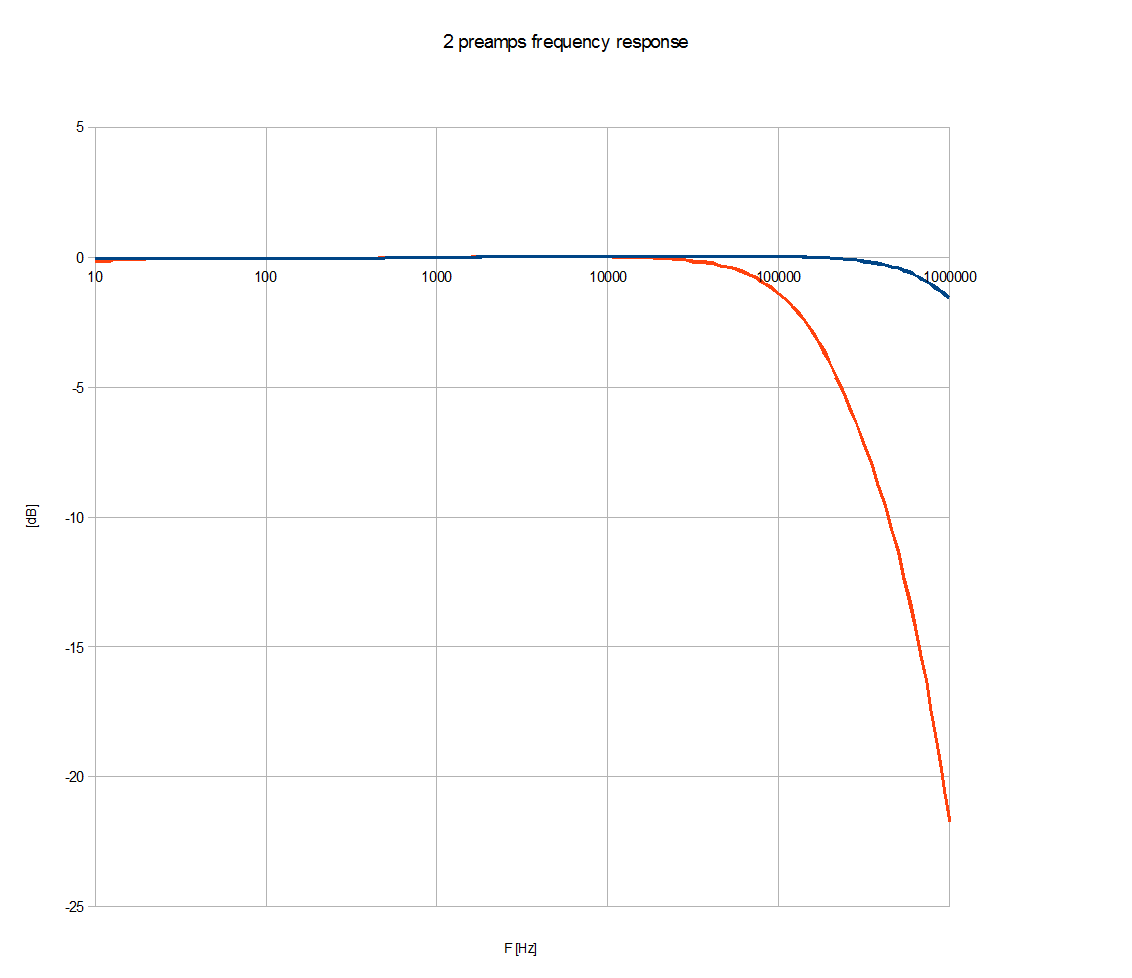

I think I could reveal the biggest (probably) difference between the preamps under test, and this is the frequency response. Though they are both well within 0.1dB in 20Hz-20kHz range, there is quite a remarkable difference when we extend the range to 1MHz. This also reflects, of course, in 10kHz square response and corresponding rise/fall time of the leading/falling edges. Frequency responses shown without revealing which one belongs to which preamp.
