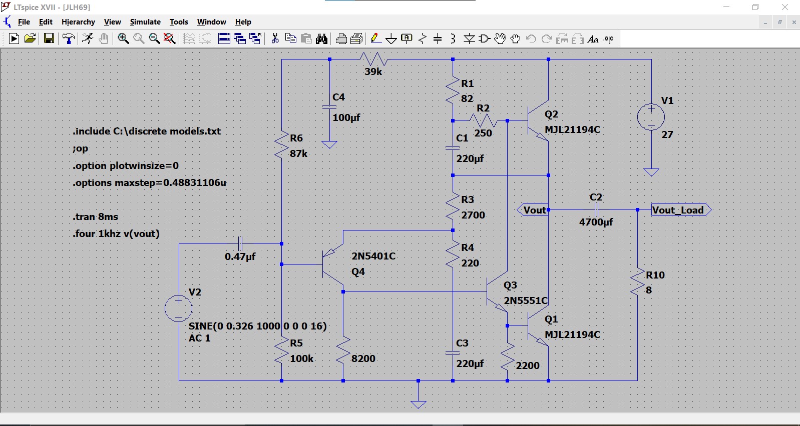

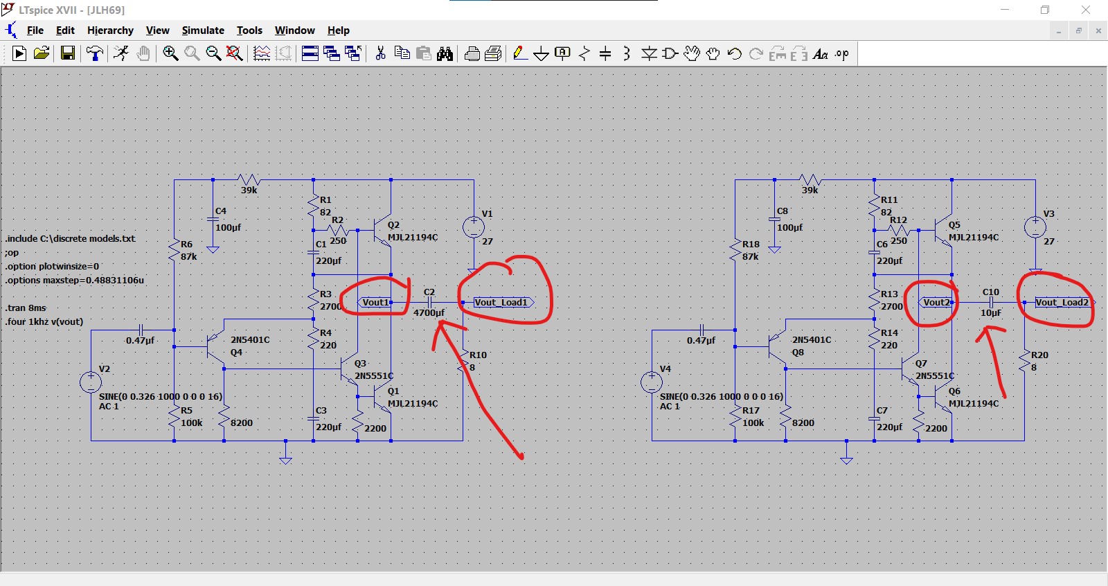

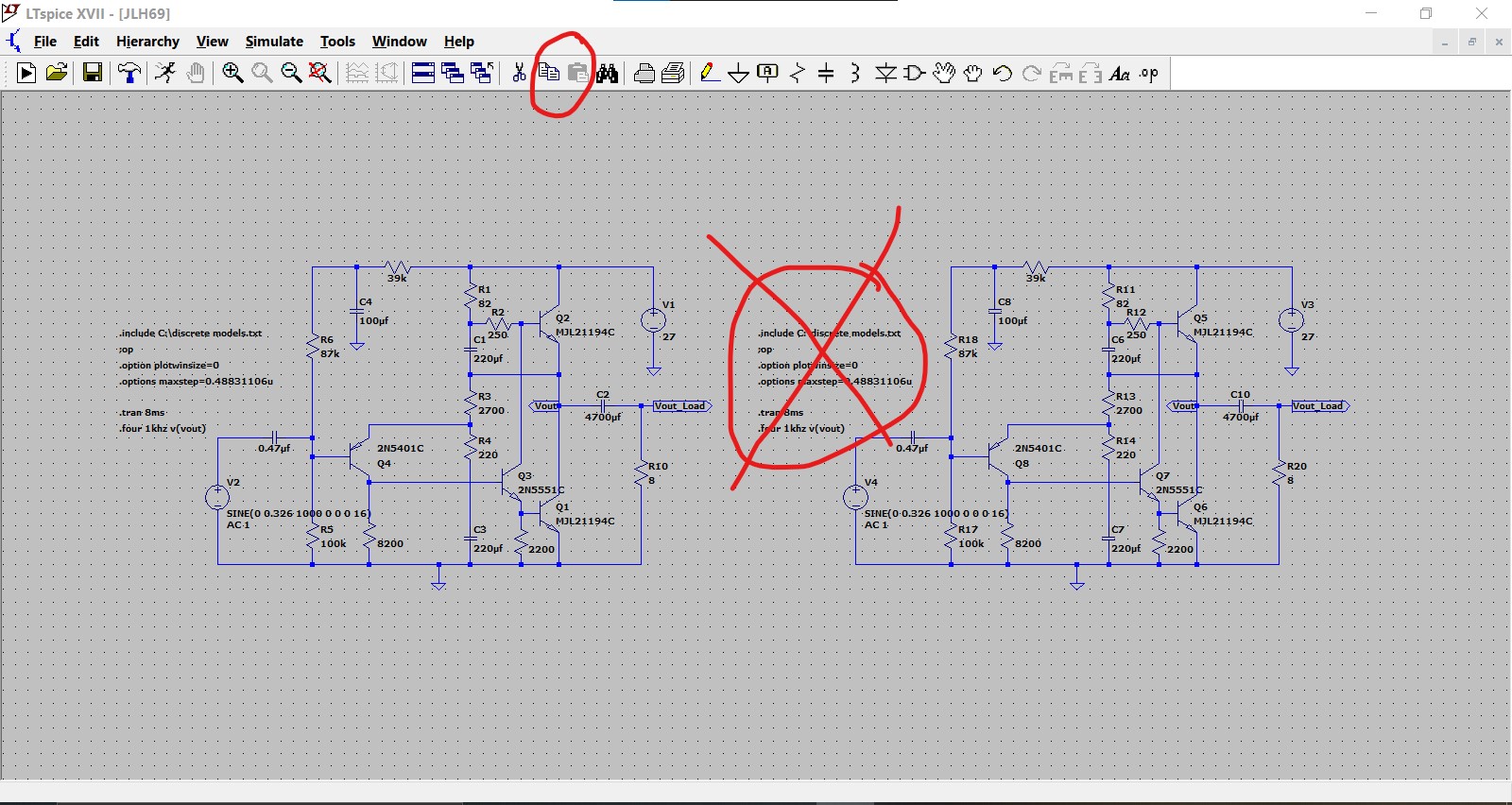

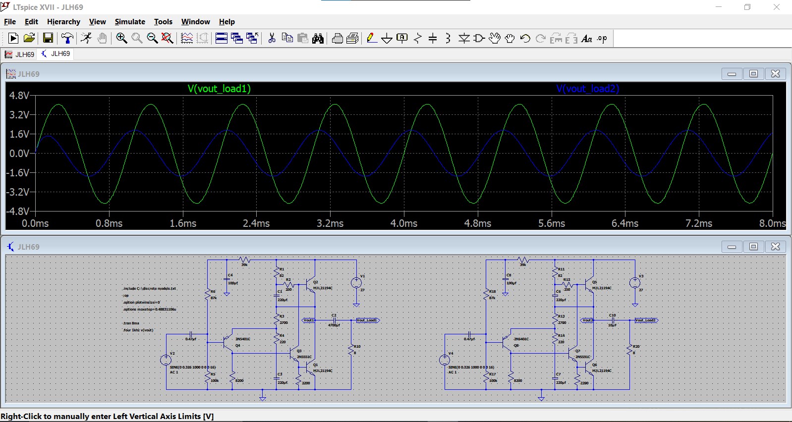

You can use the 'copy function' on the work-space to duplicate your circuit. It is the symbol next to the scissors on the function bar and is used to draw around the area you want to duplicate.
Having done that, delete all the duplicated commands and rename any duplicate nodes such as Vout making them say Vout_1 and V_out2
Now you can run the sim and probe each version.

Hi Mooly and Knutn,
Thanks guys! Knutn's solution is more like what I am looking for. While still a bit clunky, I think it is better than copying the whole circuit twice, specially as circuits become big. I wish LTSpice had an option to allow you to save say the last 5 simulation runs without having to go to the file explorer and change the name of the raw files manually. For example, you could have an option that said save the last 5 simulations. Then LTspice would create: - circuit_1.raw, circuit_2.raw ... circuit_5.raw.
