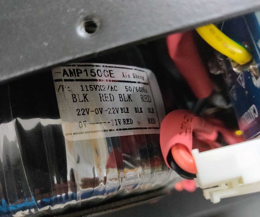

I have a pair of assembled monoblock Tripath 2022 based amplifiers (150watt x2 4ohm,90watt at 8ohm) that play amazingly good with my old rebuilt IMF studio monitors and Canbridge Audio TL100 speakers ,also rebuilt recaped etc.
I was just wondering if i replace the Chinese made toroid transformers inside (see pic) with a better brand/make would it improve anything ?Or just leave them as is?
Any suggestions ?

I wouldn't bother changing the toroidal transformer. Old transformers are generally as good as new. Almost all over the world they are capable of making correct transformers, certainly the Chinese who are probably the biggest producer today.
If you want to do something, rather concentrate on the quality and amount of supply rail decoupling capacitance such as suggested by amplidude.

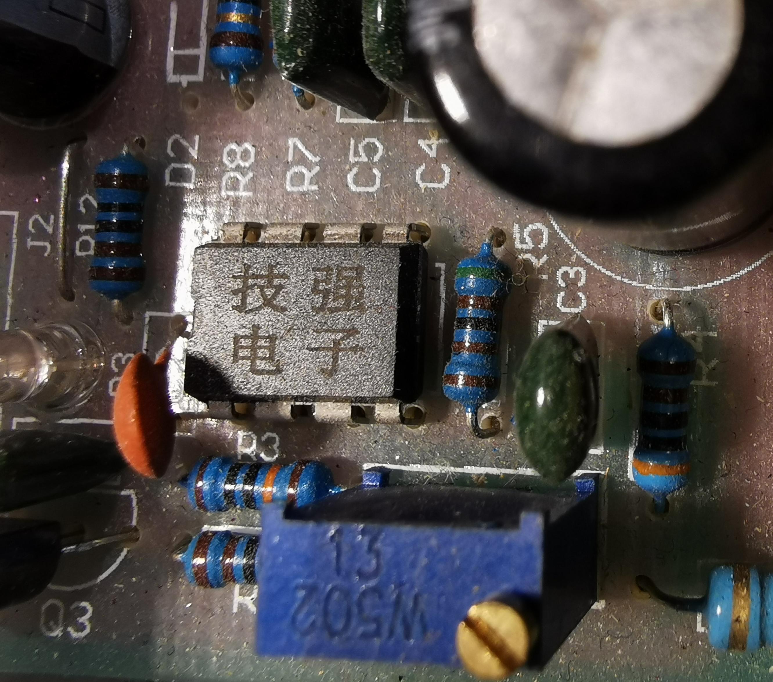

Also the add mentioned LM LM-4562 opamps but after taking the board out an inspecting i couldn't find any.

Ensure the secondary side of the transformer has a route to mains earth, I've seen too many dodgily insulated chinese transformers, I had one that with primary and secondary windings touching. I noticed because of the bizarre noise spikes on the output, rather than by being electrocuted fortunately.

Anyone know what it says?
it reads "copyright reserved".
