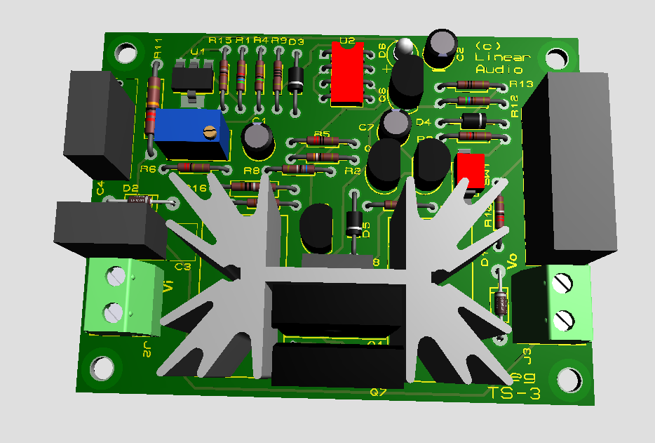

Here on my bench I have a completed design of a HV regulator for tube amps. Less than 1mV noise, no sagging under load, light, low heat. No need for additional power supply.
A single R sets the output anywhere between 0V and 580V. A single R sets the current limit to anywhere between 5mA and 1A. Fully overload and short-circuit protected. A tube amp's wet dream.
But I am hesitant to publish it because it contains - gasp - an opamp ...

This is how it will look.

I’m trying to understand the hv regulator circuit. It’s impressive and I would like to build one, if I can find the right components. Do you have any thoughts on a PCB?
Regards, Gerrit
I have some PCBs available, as well as some of the HV parts.
On the 3D view you see three TO220 devices, but you would use only two in an actual circuit. But there are two possible positions for the pass device, either on the on-board heatsink for disspations up to 6 or 7 watts, or on the edge of the board for mounting on a chassis or larger heatsink. There is a note to that on the schematic.

Trying to understand as well. And I don‘t get circuit diagram and picture from #43 completely together yet ... :eek:
The error amplifier, the AD8031, drives the gate of the pass device.
That opamp gets two inputs. One is the output voltage, on the inv input. The other is the reference voltage, on the non-inv input. The difference between them drives the gate up or down.

Hmmm ...
Reference voltage is provided by U1, the LT3092 ?
And the circuitry around Q8 steps down the difference between Vin and Vout to a safe voltage range for the op-amp ?
So I guess the regulator doesn‘t limit Vraw from climbing up too high when there‘s no load yet (tubes not fully heated up / bias servo still at too negative grid voltage). I have a PSU that‘s cLCC (or LCC), and without load the voltage keeps climbing. For this, I probably would combine the regulator with your HV delay circuit, right?

The PCB I have, and the ref current source LM3092 (I can put that on the board if you are uncomfortable with SMD), the HV depletion mode IXTP08N100D2, the AD8031, the pass MOSFET FDP12N60NZ.
Let's say € 30 plus shipping.
R11 has to be selected depending on the necessary Vout at about 0.58V per kOhm. So for instance, for 250V, R11 should be ~430k. You can adjust the Vout +/-20% with VR1. Note that R11 must be selected for the full output voltage. Conrad or Mouser should have it.

The LT3092 is configured as a current source, about 580uA, and develops the reference voltage across R11.
A main feature is that the whole regulator circuit floats on Vout so there's no issue with dividing down high voltage. Also, it means that the loop gain is always the same no matter the Vout, so it is stable for any Vout.
Q8 etc steals some current from Vin to develop a small supply voltage for the opamp and the LT3092. By using a very low supply current opamp (typ 800uA) and a high brightness LED in series with the LT3092, the whole reg circuit runs at just a few mA.
That also means however that you must have a load that takes at least 3mA or so, you should not run it open load. But anything you hang off it will surely take more than 3mA.
