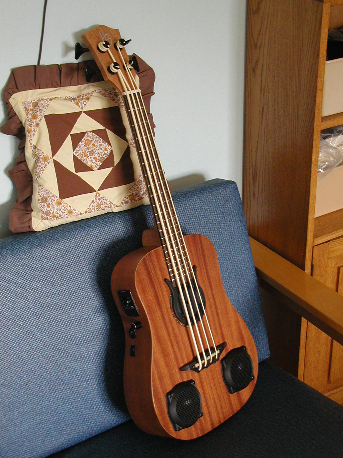

Hi Chris, thanks for your reply.
I post on diyaudio. I build speakers. I play guitar, banjo, bass and French Horn. I understand how electric instruments work. Like you, I do a lot of live sound work, so I do know what feedback is as well. :)
Attached is a picture of a similar project a friend of mine did in the States earlier this year. He also has a lot of experience in sound, and his instrument works well. He used two Dayton Audio ND91-4 fr drivers in separate sealed enclosures made from PVC pipe caps, and acoustically isolated from the body of the instrument with Velcro. He has no feedback issues, so I don't anticipate any. BTW, my bass uke has a piezo pick-up, since bass ukes use thick PU strings that are a lot like round rubber bands.
I chose the driver in my original post because it:
  • is very sensitive
  • is fairly small and light
  • has an Fs of 44 Hz, which seems low enough for a bass
  • is not expensive
It handles 40W RMS, do you really think it will have trouble with what it will get from the bass when it's driven by a TPA3116?
I'm happy for the advice re sealed rather than ported, sealed will obviously be easier to build into the instrument body. Do you think the SB13PFC25-04 will have the requisite response (I assume down to around 45 Hz for a bass) in a sealed enclosure?

...similar project...works well...drivers in separate sealed enclosures made from PVC pipe caps, and acoustically isolated from the body of the instrument
The good news is you have a successful project to copy ideas from. :)
The bad news is that putting the speaker in the bass itself - rather than in separate acoustically isolated enclosures - is the very thing that's raising the eyebrows of some of our experienced members.
