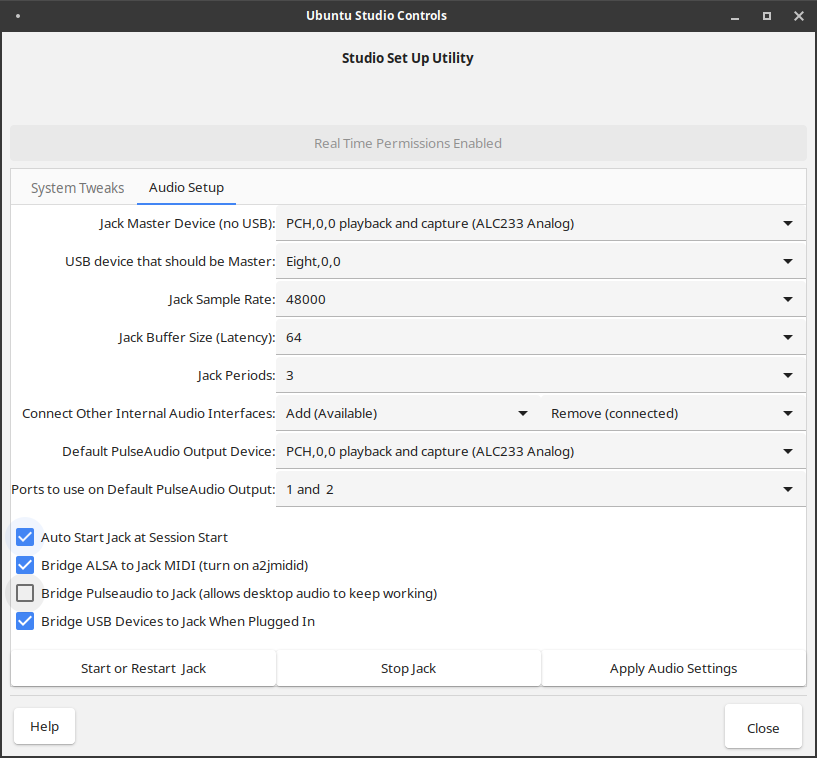

Settings:
  • Jack Settings - 48KHz 64Buffer 3Period

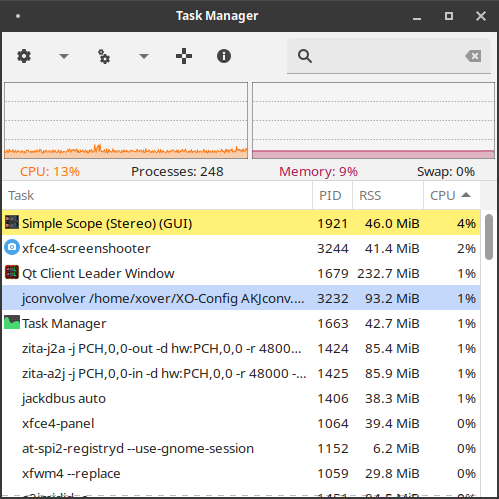

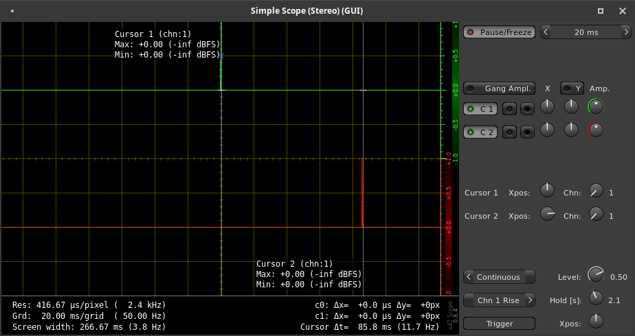

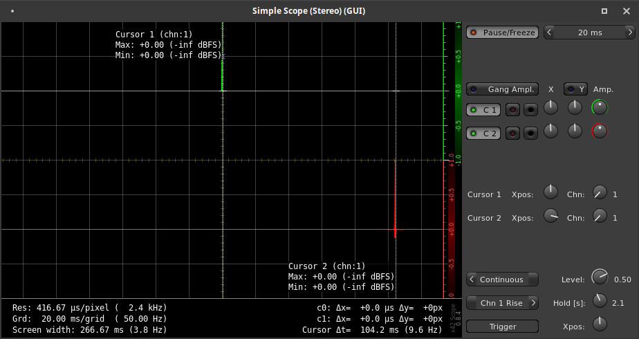

Results:
Brutefir Latency = 104mS, CPU Load = 55-60%
JConvolver Latency = 85mS, CPU Load = <5%

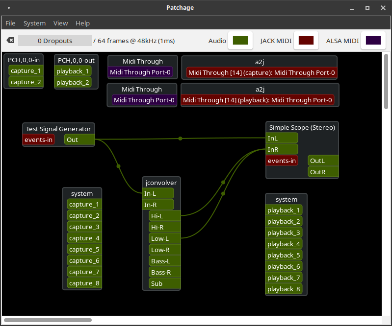

These latencies are measured inside Jack(Not using sound card IO) using a jack signal generator and a jack oscilloscope.
I dont understand why I am getting such long latencies, I would be very grateful if anyone could shed some light on why the latencies are so long and even more grateful if you could share how to fix it!
